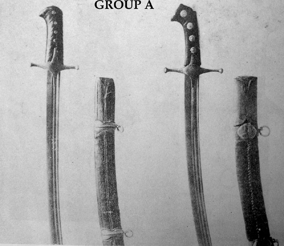

group A:
war-karabelas (17th c.) The characteristic, Turkish, 17th century war-karabela, has handle made of black buffalo horn, becoming a little narrow towards the pommel, decorated with engraved lines, with four big, brass rivets, steel quillons similar to Persian one, blade used to be European (from Styria) (…). As a trophy, karabelas from this group were used also in Poland. It is possible they were made or remade in Poland as well, anyway some of the scholars used to link this sabres as Polish.

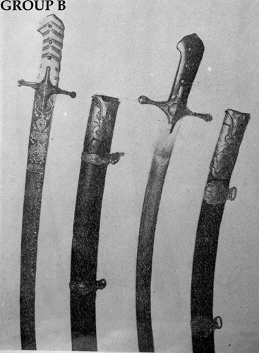

group B:
decorated karabelas with war features. Handle made of different kinds of semiprecious stones or buffalo black horn, wood, ivory, with three rivets, decorated with curved lines, narrowing towards the quillon. Straight quillons ended with bulb knobs. Blade made of Damascus steel (more often). Made in Turkey, used also in Poland. Many of them are preserved in The Wallace Collection, among the others with Polish coat-of-arms.

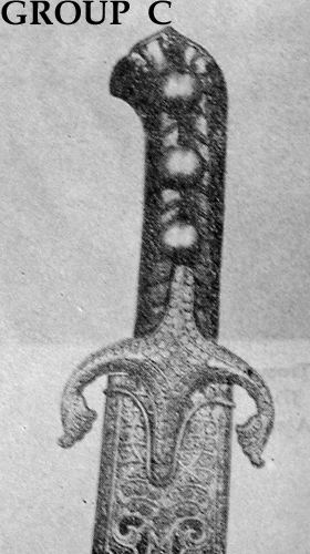

Group c:
Armenian-Turkish karabelas (with quillons curved towards the blade)

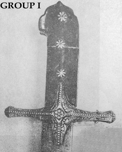

group I:
(end of the 17th cent. – early 18th cent.) – hilts of ivory or semiprecious stones, with three rivets (as is usual in Polish karabelas), decoration in gilded silver, repousee etc.

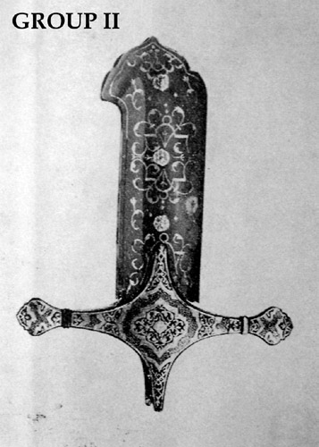

group II:
(about 1715-1730) – hilts preferably of semiprecious stones, set with golden wire, the quillons straight with small knobs at the ends, the blades of Damascus steel, often iscribed with Latin or Polish mottoes.
