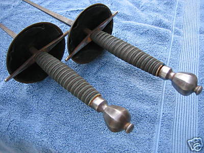

Hello over there

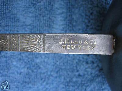

On the special whish of a single person I'm going to present to the forum a matching pair of late 19th century fencing foils. The "ethnographic" aspect may be found in their special grip. They are fitted with a so called "German handle" which means that the quillons are attached directly below the guard, leaving a very small ricasso (in contrast to the Italian style).
The blades were imported by J.H. Lau at 75 Chambers Street, New York. They are both forged at Solingen (Germany) etched with some kind of floral pattern. I assume that they were not used for actual fencing but are nevertheless in a very good condition.
Does anyone have further information on J.H. Lau? I found out a great deal, but I'm still looking for a date when he opened his shop in NY.

Hi.
He was a tall man as the clip demonstrates. And he entered the country in 1889.
Fortunately you can search over at the New York Times.
Here is the first page of a search I made
There are a lot of hits, perhaps what you are looking for is in there somewhere. You might find copies of the NYC Directory and see where his establishment makes it's first appearance.

Outstanding photos William! and welcome to our forum!!!
These foils are extremely nice, and I have often wondered how the types varied. I have only ever known of the modern versions of French, Italian and foils or sabres. It seems interesting that these appear almost vestigial versions of the famed Spanish cuphilt.
I'd like to know more on the different types of foils used in the 19th century, and hope we can include more on some of the makers and outfitters who provided them. A most interesting sector in arms collecting!!!!

@ Ed:
Very good hint. But unfortunately I have already searched through all hints on the NY Times archive. The date you mentioned is 1869
But I'm not sure if all the dates an information are related to the same person
They could have been 2 persons with the same name....
Unfortunately the TIMES is quiet on the matter when he started his business. Further inquiries with the Brooklyn Library haven't brought up anything new. The NY Library offered a service to check for material but charges 60 Dollar per hour even if they don't find anything.
Thanks for the hint on the " NYC Directory", I'll see what I can find

Hi William,
Those look to me like decorative display foils. Their hilts aproximate that of the Flamberg type transitional rapier, but without the pas dáne (see E.Castle).

Hello all. I had my own short time of interest in 19th century fencing weapons, it isa subject yet to be thoroughly researched, as Jim said. By the way, it is not less "ehtnographical" than any other flyssa or shamshir (just for example).
Matching sets of highly decorated foils and epees were sold as "case of swords" = presentation gifts and trophies to champions and maestros.
The foil appeared first at the second half of the 17th century, just as a drill substitute to a sharp smallsword. Later on, when fencing was booming as a popular sport in Western Europe It has became as fencing tool of its own, especially with women & children because of its lighter weight and sometimes shorter length. One must remember that honor duelling was still a regular did at the end of the 19th century and it was customary for all gentlemen to be trained in swordplay as a matter of manhood; the heavier epee with its longer stiffer blade and large bowl guard was considred as the weapon of honor, so cases of matching decorated epees were reserved for serious affairs.
