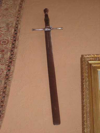

Second issue are the swords that (I think) Jim was talking about, that have relatively narrow blades and rounded, sharp tips. These are the tips I'm talking about, and they go back to the Bronze Age (see attached image of an accurate reconstruction of a Mindelheim type C sword). In these blades, I'd say the tip was blunted so that it would be a decent slashing tip, and not get embedded in the target.
Basically, we've got different possibilities for the reasons for blunt tips. I absolutely agree that broad, blunt tips are great for cutting, and I also agree that they're easier to sharpen. I also think that they can be specialized more for slashes, rather than stabs.
