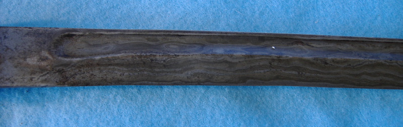

My collection of "oddities" continues to grow. It appears that very few of my weapons fit into a definite category.
I am sure that this must be a European blade, but what ? I have never collected Western swords. Almost looks like a Chassepot bayonet that has been browned.
The sword is about 2 ft long. The scabbard is wood covered with thin, low grade, sheet silver.
Hilt is horn, probably buffalo ? Malaysian ? Indonesian ? Phillipines ? Must be from around there somewhere.
Vendor said it was some sort of Dha !!!!!!!!!!
I would be greatful for any suggestions
Thanks
Royston

WOW!
Thats a weird beastie!
A pattern welded blade that looks like its from a yataghan bladed British or French bayonet? Whats going on there?
Very very nice though!

Some Indonesian smith got creative.

Very interesting!!
It is an indonesian pamorblade. Looks like the smith was inspired by the dutch klewang.
I think we can talk about a pedang lurus or a straight sword. That's my first impresson at the moment.

Before 1900 the whole of europe was using this shape of bayonet.
And that must have been the inspiration for the smith, as this is clearly not a militairy blade.
very nice all together

The blade says Bali to me .
There's something about how the fuller terminates ...

Interesting piece, Royston. What's also interesting is how our biases show. Taking tongue firmly in cheek, I'd point out that properly, this is a bayonet shaped object (BSO) or perhaps a yataghan shaped object (YSO). After all, if a European smith can only make a keris shaped object (KSO) or a katana shaped object (also KSO), then the rule should apply to Indonesian smiths as well. This is especially true if (as asomotif) notes, it's not a military blade.

Well Alan, i understand you reasoning here, but it's more than the finish that makes me think Bali (or Lombok). The pamor pattern and execution look more Balinese to me and that single fuller reminds me of some i have seen on Balinese keris pedang. Also, while i have never seen hilt motifs quite like this one it doesn't seem to say Jawa to me. But of course, this is all just speculation.
I do believe that what we can say with a fair bit of certainty is that it is NOT a European blade or a dha and that it is from some part of Indonesia.

Here is another example of a similar type. I love the ferrule on this one, and it has a very nice pamor blade.
