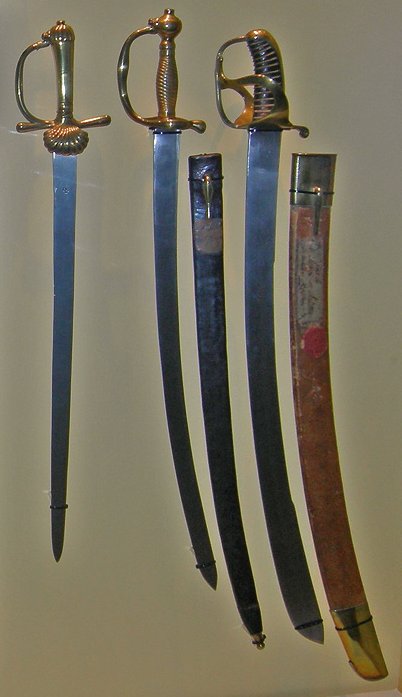

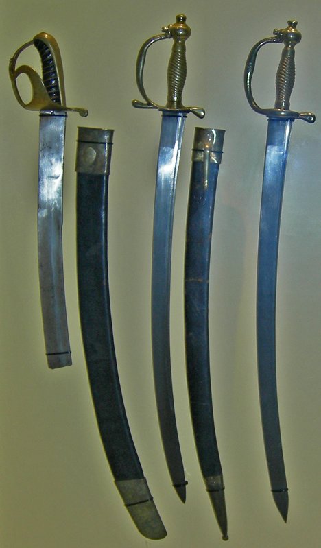

Ok, the text read very much like an
The hilt is quite different, but the blade does seem like it might be of the same "family" as the Swedish infantry cutlass m/1748 and it's descendants (various variants of it seems to have been used well into the 19th century, in the case of the infantry I'm under the impression that it was kept around until the m/1848 fascine knife took over).
The picture with the hirschfänger on the left has an m/1748 in the middle. The picture with the broken saber to the left has a cutlass m/1803 for infantry troopers in the middle, and cutlass m/1808 for infantry troopers on the right.

The m/1748 had the knuckleguard screwed to the pommel, yes.

I have a sword identical to the "broken saber" in your picture. What's its ID..?
Best
Manuel
Old 31st October 2008, 12:42 PM   #11
kisak
kisak's Avatar
Join Date: Jul 2008
Location: Stockholm
Posts: 182
The pictures are from the Army Museum in Stockholm, and according to them it's an m/1775-1807 for troopers at Savolax' light infantry regiment. It's a "modification model", where the inner guards on the old m/1775 sabers were ground off to reduce wear&tear on the uniforms. The m/1775 in turn seems to be identical to the m/1770 for Savolax' jaegers on foot.
