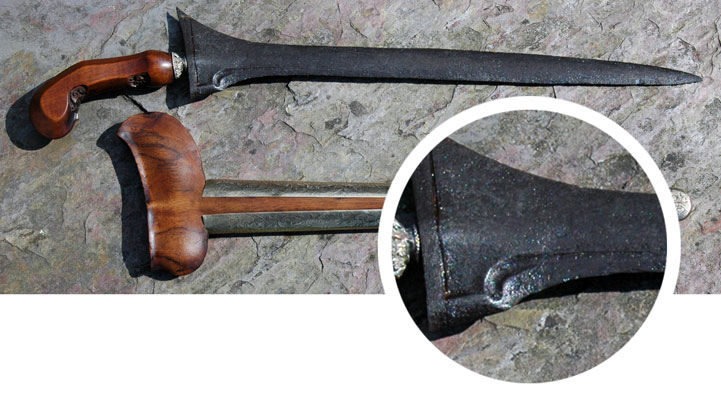

I recently got this Solokeris, it was in a (very) poor condition (very rusty, paint, bended, you name it) so I'm still working on it.
I tried to get more information about its prabot but I failed.
So please, are you able to help me? I know I've seen a similar prabot before but I don't know where...
Thanks, Sjors

I think this dapur is Tilam upih.
You did a nice job on restoring it.
Old 12th July 2008, 09:15 PM   #3
Hello Sjors,
I assume you mean the comma-like feature, the tikel alis? It usually is executed less crisp and narrow but in Sumatran blades (keris bahari or keris panjang) you can find it even more pronounced and condensed.
You're right, that was what I was talking about...

In respect of Javanese keris we normally use the word "prabot" to refer to the things that make a keris complete, such as the warangka, jejeran, mendhak, etc.
Some people do use the word "prabot" to refer to the features of a blade, but I have never met one of these people, and everybody I know uses the word "ricikan" to refer to the features of a keris blade.
The word "prabot" in its everyday sense means "tools, utensils, equipment" etc (it has other meanings as well, but they are not relevant here).
For instance, you can have "prabot pawon":- kitchen utensils.
The word "ricikan" comes from "ricik", to divide up. "Ricikan" means "extra or additional parts" it can also mean "requirements".
It can be easily seen that ricikan is the correct, and more appropriate word to use to refer to the features of a keris blade. These features are not "tools, utensils, equipment", but are "additional parts", or "requirements", in the sense of a specific requirement to satisfy a particular dhapur.
The word "alis" means "eye brow", and "tikel" means "a lot bigger". Some people will call the tikel alis by the name "widheng"; to me, this does not make sense, because a "widheng" is a kind of crab. If they used "lung widheng", the same as the mendhak motif, it would make more sense, but they don't, just widheng:- river crab.("lung" means "tendril").
A tikel alis that continues through to the front of the gandhik is normally taken to be an older style.
Some people will give sub-categories of tikel alis according to form, but there does not seem to be much consistency in these sub-classifications.
Having spots all over your blade, did you use chemical liquid to work (clean) on it? What kind of chemicals, please?
Dear Ganjawulung,
In real there are no spots like that on the picture, I think it's some kind of reflextion of the oil I used.
I didn't use any chemical liquid, just vinegar after derusting it for some time in a electrolithic way because of the heavy rust ( it doesn't "eat" material, just rust), the same way I do with Archeological findings (another hobby of mine).
I included a "before and after"picture.
Good work, Sjors. Thanks to the different nature I am living, usually I clean such rusty blade in a very easy way. Just sink the blade with "coconut water" overnight or two -- not too long, then just brush it softly with very soft "tooth brush" and lime-juice mixed with a bit cream soap. Did you clean the hilt in the same way as the blade. I mean with vinegar too? (hilt in the later pics, is cleaner than the first)

Dear Ganjawulung,
Next time I'm sure I wil try your way of cleaning.
I didn't clean the hilt with vinegar, I just used water and some mild soap but it was (like its dress) so dirty, you wouldn't believe it...(in real it's a little bit darker than at the picture but I left it that way so you could have a better look at the keris itself)
At the same time I bought this keris I bought another Solo keris, 11 luk, from the same person, and it was also that dirty, I wonder what happend to those kerisses.
The problem is that, due our history, there are a lot of kerisses in the Netherlands but also a lot are in a bad shape, so I like to buy a pile of rust to reform it to something like a "normal" keris, it gives me the feeling I've saved something.

And during cleaning I found out that he mendak was silver in stead of copper
Many ways of cleaning such rusty blade. "Coconut water" is only one among tens of ways of cleaning keris blade. But one must be careful too, because coconut water is quite corrosive, although in many occasion you may look people (in Indonesia) drinking coconut water like drinking coca cola... Just please, don't sink your keris blade too long in coconut water. (And after more than two days, usually the coconut water gets stinky and more corrosive...)
