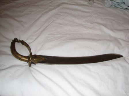

I have before the forum an interesting South Indian Sword. I recently acquired it.
Here are my comments on this piece:-

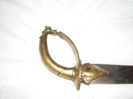

1. It is South Indian from the monster head pommel - Yali, and the general construction of the hilt. Note the serrated disc holding the tangs, an unique Deccani attribute. The hilt is also made of Brass, another popular South Indian metal working tradition.
2. It is about a foot and a half in length. The blade is a recurving blade, like a sosun patta.

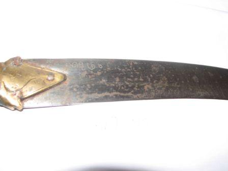

3. Now, the most surprising observation. The blade has distinct Bikaner Armoury markings. However, this particular piece is not very ostentatious and fine like the other Vijaynagar weapons at Bikaner, many of whom are shown in Elgood's 'Hindu Arms and Ritual'.
4. I think the hilt may have been cast at some village armoury in the South and from a much later period say mid to late 1800's, a period which did see a profusion of such brass cast weapons around Old Mysore and Tanjore.
But, could this piece actually have been an original but simple specimen from the Vijaynagar period.
Or to solve all our problems, a rehilt!
Nidhi Olikara

WHAT A STRANGE AND INTERESTING GRIP. IT WOULD APPEAR THAT WHEN YOU HOLD IT IT WOULD BE LIKE GRIPPING A PISTOL. I HAVE SEEN THE PISTOL GRIP FORM ON MALAY AND INDONESIAN DAGGERS BUT NOT ON A INDIAN SWORD. FROM THE SIZE YOU GIVE IT IS EITHER A LARGE DAGGER, OR A SHORT SWORD. THE WEAPONS I HAVE SEEN USING A PISTOL GRIP ARE USUALLY SHORT DAGGERS AS THE GRIP STYLE WOULD NOT BE AS GOOD ON A LONG BLADE.
SORRY I CAN'T HELP ON ANY INFORMATION PERHAPS THOSE WHO COLLECT INDIAN WEAPONS CAN BE OF HELP. A VERY NICE AND UNUSUAL ITEM.

I don’t think the blade has been rehilted, and if it hasn’t, it is not a Bikaner blade, then it is a blade from the south, with a Bikaner armoury marking.
When you look at many of the weapons with this mark, they do not all origin from Bikaner, but they come from many different places – a lot of them from the south. There were, in the earlier days, many wars where whole armouries were emptied by the winner, and the weapons taken into the winners armoury – sometimes they were marked, sometimes not.

Jens , so you are saying that at the very least this blade has at one time been part of the Bikaner Armory inventory although not necessarily forged there .
This hilting arrangement seems unwieldy to my untrained eye .

Rick,
Yes, the pistol hilt may not be very user-friendly.
But it could be useful for ritual sacrifices. That is to say, not convenient for thrusts or cuts but rather for one sharp downward stroke?
