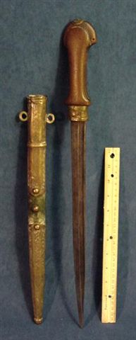

This puppy just went on eBay: http://cgi.ebay.ca/ws/eBayISAPI.dll?...MEWA:IT&ih=022
Nice Moroccan genoui, the seller said the hilt was wooded, but the orange-skin look of it makes me think it's rhino horn.
Comments?

Here is another one of very similar form and materials.

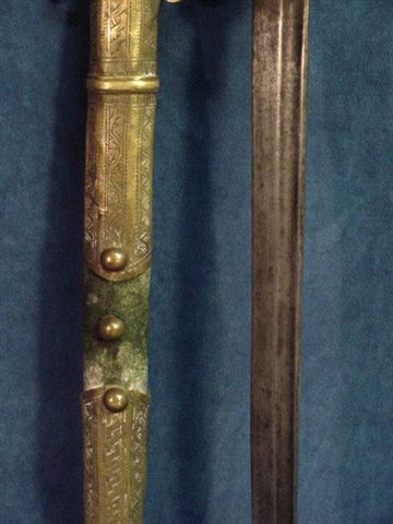

Hi all, maybe I'm wrong but seems that the blade is a bayonet blade? Sorry for the stupid question

Bayonet, smallsword, sabre, most any blade from Europe I imagine. Since they were fitted with rhino horn, they must have been well thought of.
They make awesome-looking dagger I think

Very astute Flavio! and not in the least bit 'stupid' !!!
This probably is a bayonet blade, and these blades taken from the bayonets of colonial weapons quite typical on this form (genoui) as well as the s'boula which turns up as far as Zanzibar and Ethiopia referred to as a Zanzibar sword (see Burton). This is one of the reasons that references to many European and British regulation arms become closely associated to the study of ethnographic edged weapons.
The so called 'Berber' sabres, that attribution remaining somewhat in question, is typically mounted with blades from British M1796 light cavalry sabres with highly profiled tip.
Now the question would be, what type of bayonet? My guess would be 19th century French.....anybody got a bayonet book?

My bayonet books are at home and I am stuck at work on MLK day (sigh), so I am not sure what it is, but it does not look like a Chassepot or Gras bayonet, which is what I would have expected given the strong French presence in this part of the world from the mid 19th to the mid 20th centuries. It could be from the Berthier-Mannlicher rifle (M1892), as the blade is obviously straight with a single, wide fuller. It most certainly is not from the Spanish long M1893 Mauser bayonet.
Now, the question is, has the French Foreign Legion ever been armed with Berthier-Mannlicher rifles? If the answer is yes, then maybe we have identified the blades.
