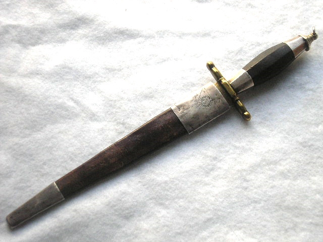

The winner and I have been in contact and we both think that the brass blade is unusual, but may be ceremonial or even talismanic in nature and purpose, since Katipuneros were into that. I will let the owner speak for himself on the rest.
And yes, there have been may European and even US Civil War knives that were really Filipino. The Confederate label raises the price considerably of course. There are signs of being a PI dagger besides the Katipunan symbols (not all had them) but it is best to have them.

Most of the Katipunan pieces like this usually have a core of horn and are wrapped with twisted wire and/or a band of metal spiraled around the hilt of horn. Also the tang goes all the way through the hilt. Something else I have noticed is that the blades of officer's pieces seem to have a diamond shaped cross section.
Spanish daggers that are similar do not seem to have the spiraled metal and the hilts are made more of wood.
In this case the spiraled metal is gone and I would call this hilt Spanish but everything else is Katipunan. For this reason Katipunan symbols are more valuable IMHO.

Here are some other pictures of the piece by permission of the happy owner.

Jose, You have one very lucky friend! I really wanted to add this piece to my collection for two reasons. First is its being a Katipunan piece and second is the brass blade. Unfortunately it went for more than my meager budget could afford. Having the engraved sheath is just icing on the cake. Again my congratulations to your friend for getting this great dagger.

Yes it is a unique and beautiful puppy, and my thanks to him for letting me share his pictures with you!
