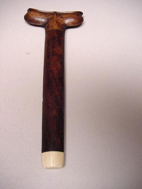

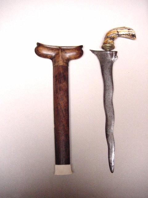

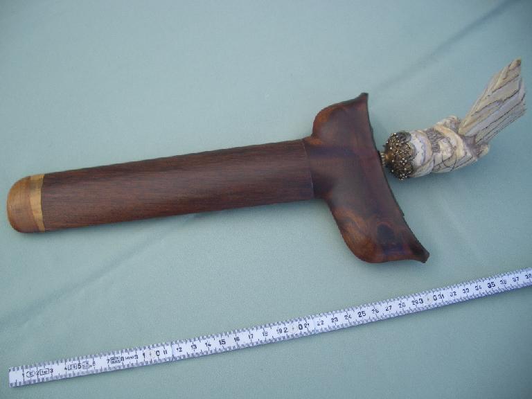

I'm trying to replace a missing bun tut and realizing I am less sure about the correct shape for this sabit bulan type sampir. Any help identifying the kerises correct place of origin and most importantly photos of proper shape for the bun tut are desperately needed.
thanks, Steve

Hi Steve,
That sampir is not bulan sabit or sari bulan type but it is of Minang Kabau, more towards central Sumatra. Nice fossil hilt too.

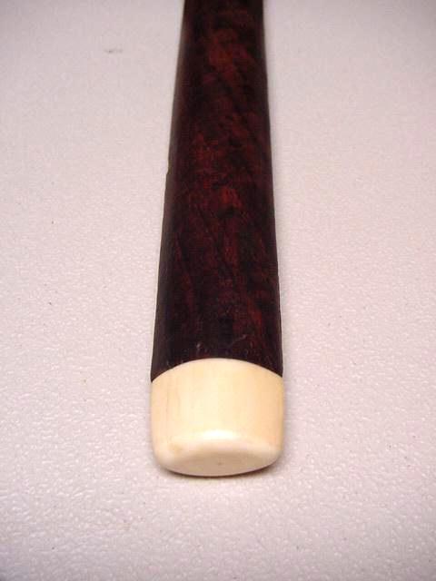

About the buntut, my opinion is that it need to flow down harmonously from the stem (batang) down to the buntut. I found that yours is slightly too big. Maybe other members (like VVV, AlamShah) can show some better pictures for example.

Minangkabau sampir, I thought it looked more Palembang, but of course when discussing Sumatra, it could very tricky
I think that the sarung is not original to the blade because the blade looks Bugis or Bugis inffluence with the Northern Malaysia/ Southern Thai hilt and pendokok. But the previous owner could have used the sarung for the blade, maybe more than 60 years or so.
Just my 0.02 cent.

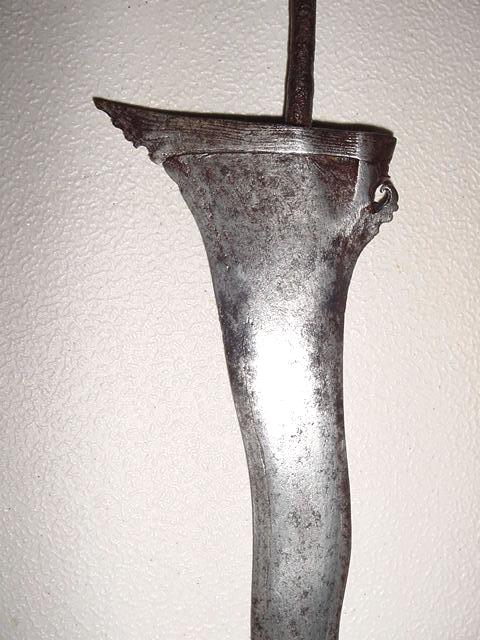

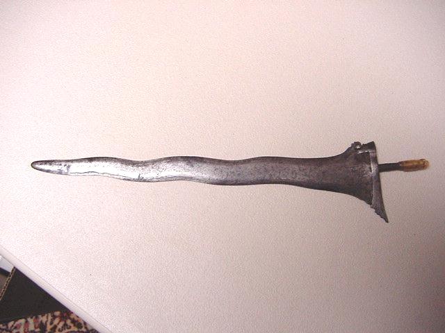

I'm wondering if it's really a Bugis blade. The ganja seems too perpendicular to the blade on the aring side. The sampir still remains similar to those mentioned;but, definately different. Could the blade and sampir be from Thailand? The buntut is still loosely fitted and roughly shaped.
I added A couple of blade closeups. I tried to upload three Minang kabau keris
from Van Zonnevelds traditional weapons, top of page 64, with no luck. It was the ganjas on those keris that were sharply angled and confusing me. The older you get the easier for confusion to errupt.

looks Bugis to me, but some close-ups would help.

Taking a long hard look, I think this keris is a keris debek from N Malaysia/S Thailand.
The sampir is rather compact, but is definitely more akin to the other keris debek sampir I've seen. The other possibility is Banjarmasin, but that form does not have overhanging daun like this. As for a Minang origin, the roundedness of the underside is something I've not really seen in Minang kerises. Another point is that if this is Minang, the batang should be tapering, but this specimen here does not.
Blade-wise, first impression was that this was a coteng-type blade. Meaning it comes from the Singora area in S. Thailand. Such blades can look very very Bugis, but the styling of the base of the keris is the part that differentiates it from Bugis blades from the South.

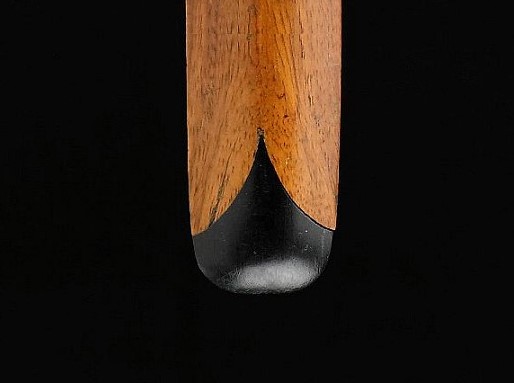

You could consider a buntut like the type on the example below (not my keris).
