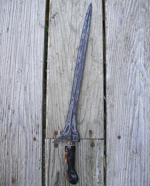

Hi Michel, I'm not too sure what you mean by angle in this case .
This first example I've posted seems to be pretty much at a 90 degree angle to the ganja.
Or do you mean the attitude or angle the keris blade assumes when dressed as shown in the second picture ?

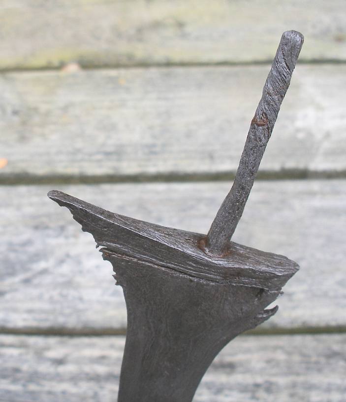

Thanks for your answer. There are two angles to consider:
The first that you mentioned with your first picture: is not 90°. It is systematically slightly off 90°.
The second is the clearly seen on your second picture : If you prolonged the Axe of the ganja you have clear angle with the Axe of the blade.

Hi Michel, I was told by one of our members that this attitude of the blade is called Condong Leleh and that it relates to the gesture of sembah.
Perhaps our fellow member could comment on this as I do not wish to simply parrot information given to me by others.
