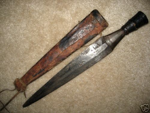

Greetings. I am new to these forums but have learned a great deal in the few days that I have been reading the posts. I believe the photo of the blade below is Sudanese but anyone have any idea as to its age and what the "S" may symbolize on the blade? (I have placed a bid on Amazon for it and am curious.)

Well I now own this piece so would really appreciate any information anyone can give me on it. Do you think the blade is a repurposed spear head? Does the "S" engraved on the blade have any meanings?

Most interesting, as Sudanese weapons always are! While this appears to be an arm dagger it is interesting to note that in upper regions of Sudan, typically in Dongola there are large shortswords of similar blade shape and configuration.
The 'S' marking is also most interesting, and I have tried to discover more on such unusual marks found on Sudanese blades that are clearly not the typically seen imitations of European trade blade marks. I have seen kaskara from Darfur with such deep, highly stylized marks and have been of the personal opinion that these may be somehow associated with the brands that occur on camels and cattle, particularly from Kordofan (a province which was primarily central Sudan). Symbolized marks typically were intended to represent either material objects or often totemically associated animals or creatures. There seems of course a good possibility that the S shape may well represent obviously, the snake.
The idea of such markings used by tribal groupings on weapons remains unproven, however it is known that geometric and stylized symbols found on early rock art often was duplicated in adopted symbolism in such brands on animals.
Please let us know if you acquire the weapon and would like to see close ups of the marking.
All best regards,

Why do you think it's a spear blade?
I am interested in what appear to be bevels at the shoulders of the blade, where it narrows to the tang (or tongue; the part in the handle); it looks like there are sharpened bevels facing toward the handle, that would cut(?) any stray fibres or skin that gets caught in that joint?.....

Mark, no the auction is over--I was the only bidder it appears luckily for me. Tom I was just wondering if it could possibly have been a spear as its shape is similar to other spear points I have seen but I also have seen illustrations of similar Sudan and central African daggers/swords that weren't originally spears. I am rather unfamiliar with this weapon. I was told that it was probably in excess of 100 years in age but I don't know how to determine that.

Thanks Jim! Very helpful and interesting indeed! I did obtain it for a very good price too I am pleased to say. I have attached a close up of the marking on the blade and the decorations on the handle. Do you think this was a repurposed spear by any chance?
