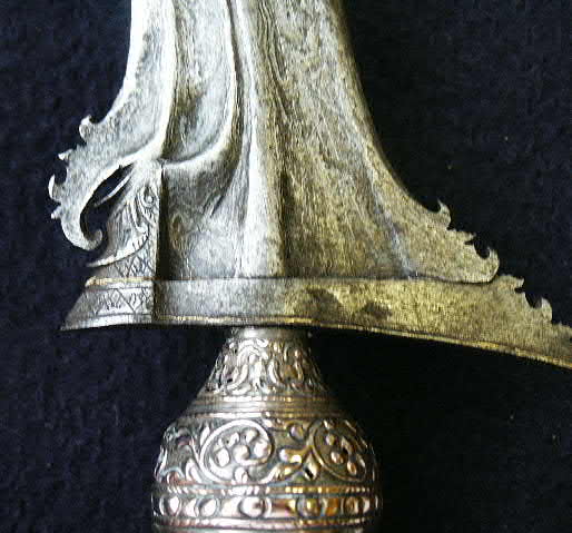

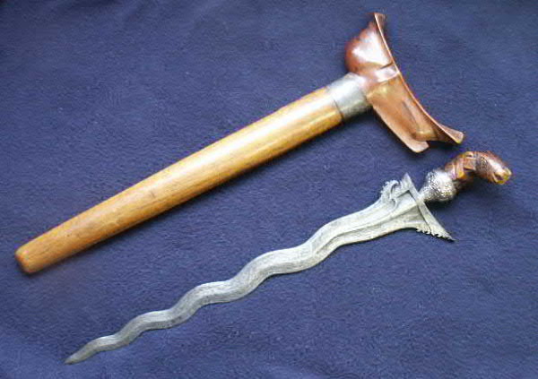

Need help in ID'ing this Keris.
Dimensions OAL 18", blade 14.75"
There seem to be a thin copper sheet sandwiched between the ganja and the blade and also in the ganja itself. There's a piece missing from the hilt.
Is it Sumatran?
Thankx.

Yes, it is Sumatran, Palembang i'd say, and a sweet one at that. It looks like scattered rice to me. The execution is beatiful. It looks there there was once kinatah on the gandik and the top of the gonjo. Nice repousse work on what appears to be a silver selut. is the hulu ivory?

Yes, it's seems to be from Palembang, Sumatra. The sheath's cross-piece is typical Palembang but the shaft (batang,gandar) seems a bit too big for the sheath joint. The brass piece is probably to strengthen the repaired joint.

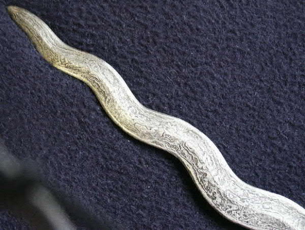

The blade is pretty nice. The picture of the blade is too shiny. Difficult to try IDing the pamor type. Better picture might help.
The sumatran selut, (a nicely made piece), seems a bit oversized for the hilt. For the hilt, the beak-like portion is missing. See here, [ BluErf's example ] for comparison.
As for the dapur and pamor, I hope others can assist soon.

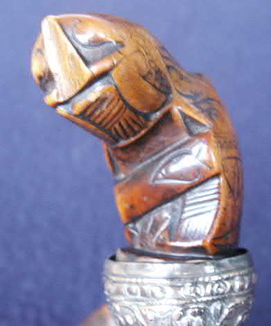

It would be nice to see it in stain. I would like ti see more pictures of the hilt. You are probably right about the beak Shahrial, but it would help to see better pictures. The selut might be a bit oversized, but i wouldn't complain.

I see what you mean by the selut being a little oversized. The selut is rose colored, somewhat coppery, not silver. From what I can tell, the Hulu is wood.
Yes the beak has broken off.
I will take more photos tomorrow.
Old 21st March 2007, 04:08 AM   #6
Posts: 7,303
Same about the beak. Still not the end of the world and you could swap it out if you felt like it. The selut does look more silvery on the screen. That's the problem with pics on the internet. Could the it be suaasa? Wouldn't be too unusual given there was once gold on the blade.

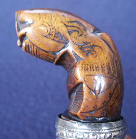

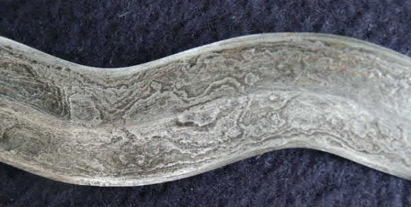

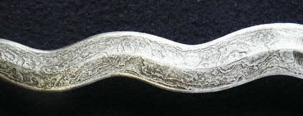

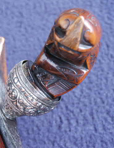

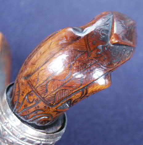

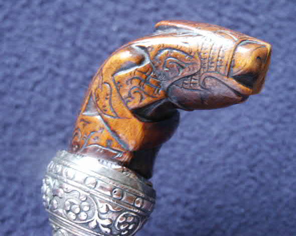

Here are some additonal photos.

For the pamor, my first impression was Beras Wutah (scattered rice) as well, but I would like to confirm with better pictures.
Kino, I believe the thin copper sheet (visible from picture 3), are remnants of kinatah works. Like you mentioned, it can be seen on the ganja and on the underside of the kembang kacang.
