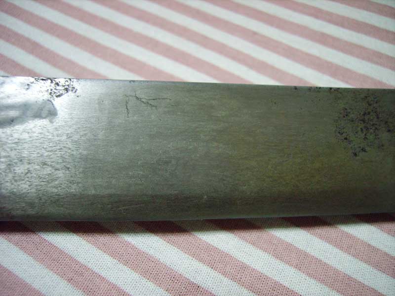

Smile Tulwar with wootz blade!!

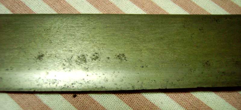

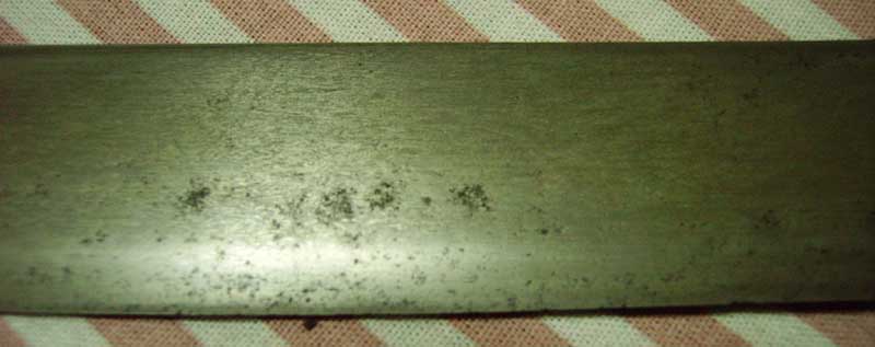

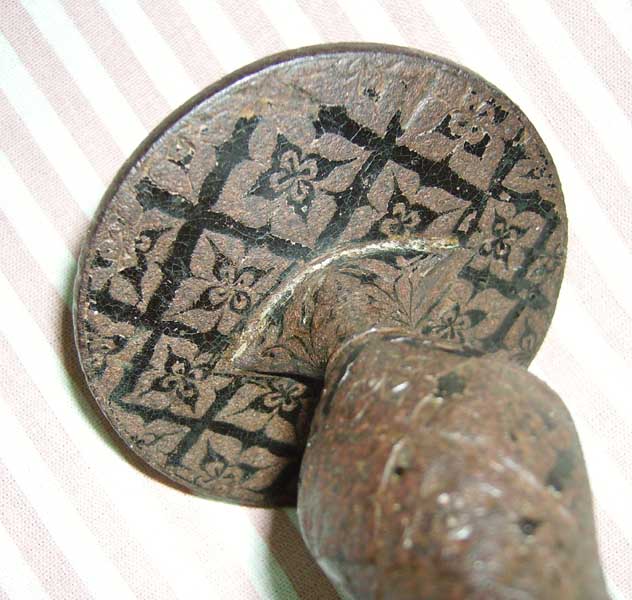

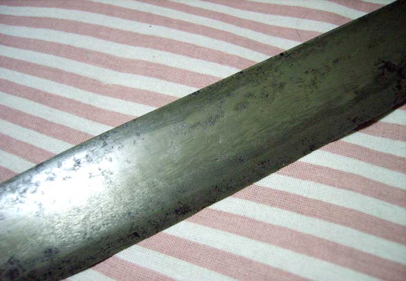

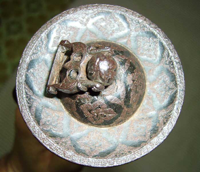

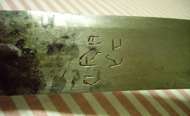

Hi all, finally i can show you my first wootz blade!!! I have etched just a little the blade and now you can just see the wootz, but i will etch a little more (it's more complicated to make evident wootz, more than on moro blades to show the laminations!!! any suggestions are welcome, i have used vinegar with semi-hot water). The handle is nice with black enamel, but it's rusty and i don't know what i have to do: i have to gently pass on the zones whitout enamel a fine iron wool or i have to leave the handle as it is? More the blade shows some letters - marks: can someone tell me what they mean? the blade shows also a part where two pieces of iron wootz were forged togheter (i think) and if i'm correct i have already read that sometimes this happens. Any ideas one the age? Unfortunatly the scabbard is in very poor conditions!!!! Thank you very much for the help!!

Hi Flavio
Nice sword! Search forum there is much information on bringing out patterns, personally I use different chemical solution based on acids, just lately I found CuSO4 as a very nice way to work with some damascus blades....
To bring out pattern and see nice blade is a matter what you choose, polish it or leave with "patina" I prefer first option and always try to bring old glory of my blades but some collectors dislike it

Thank you Husar! Sorry for my ignorance but what's CuSO4?

Flavio
You can use ferric chloride solution 1 part ferric chloride to 3 parts distilled water. Apply with a brush or clean cotton cloth to a small area of the blade to see if the wootz pattern emerges. You can rinse the blade with warm water. Be careful this stuff stains so wear a latex glove for protection.

Hi Lew, thank you, i will try, but where i can find ferric chloride?
It is copper sulfate

Any idea about the signs-letters on the blade? and about age? thanks
