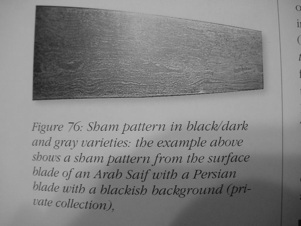

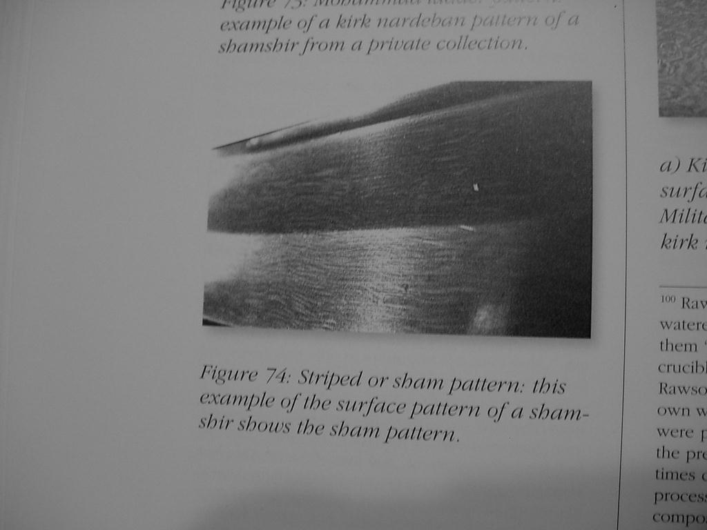

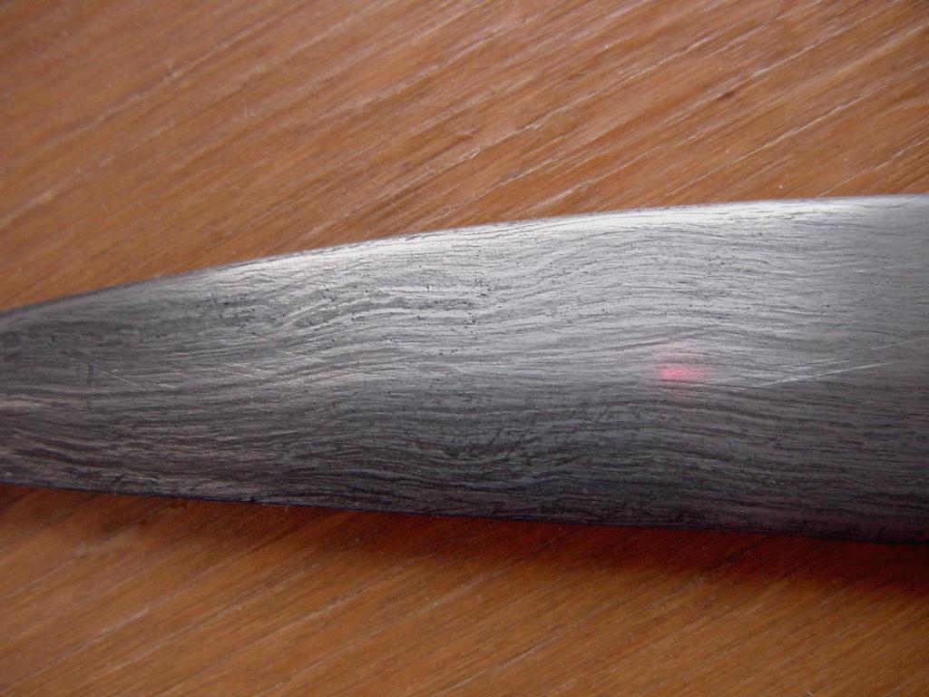

Awhile back I posted this Jambiya and used the sellers photos, opinion was it is Shear Steel. I found information about this type of steel but photos seemed scarce.
I've included some better photos of the blade and I'm very curious to hear your opinions. Photos from M. M. Khorasanis Arms and Armor from Iran, show Persian Sham and Striped Sham. This blade starts out grainy the gradually goes linear, maybe due to scarfed billets?

Steve,
You bring a good topic. Visually, it does look like sham, and the opinions will vary. My personal opinion is toward layered or shear steel. Sham is one of the wootz patterns, and based on complexity and type, I'd not attribute this particular pattern to wootz. Some references above are M. Khorasani's opinions, and leave some room for discussion...

What I find funny is that the pattern fades towards the end near where the blade meets the hilt and there is a defined edge which could be some type of faux etch ? Could be shear steel or blister steel or even some type of local carbonized wrought iron?

I would say it is not crucible steel, but something else.
I would say the same to several of those book photos as well.
It is still very nice.

Ric, Your input is always valued your hands on experience in making and forging shear and crucible steels gives first hand expertise. Your comment that this is something else, has impact. Does the apparent pattern loss Lew mentions give us a clue?
Alex, Your wootz opinions have always been of interest. This could be Mechanically produced. I've included a couple of photos where I thought to
be the result of scarfing. the thicker pattern at the hilt may be the result of
extra forging required in shaping the hilt vs. the finer lines toward the blade
tip. I'm guessing that this pattern was visible even unetched.

The only way to be sure is putting it under the microscope so without it in hand we really can't be sure . I studied the making of pattern welded steel for quite a number of years before I went rogue and started collecting antique pieces and your dagger does remind me of simple case hardened wrought iron if not the surface was just acid etched .

must say my intial reaction is also case hardend, heavily forged old wrought iron, {pre. mass production.} seen the same linear appearence before in such material..
Of course that doesnt mean other iron,steel,alloy mixes couldnt have the same appearence.
