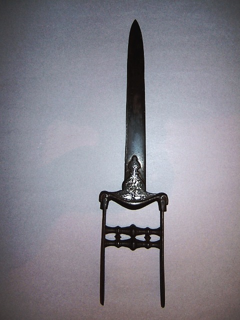

Hi All
I just picked this up. It needs some cleaning but it should turn out nice. I really like those two serpent heads on the side bars. Let me know what you think?

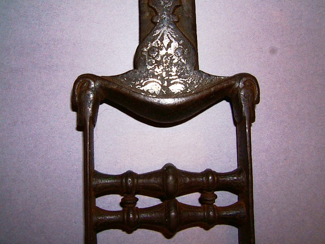

You have gotten yourself a nice old south Indian katar – congratulation. Do you know if the two small wheels between the cross bars can turn? I have one, also south Indian, with seven small wheels between the cross bars, and some of them can turn

The katar arrived today and except for some light surface rust it is in great shape. Jens yes the little beads spin quite nicely.

I have often wondered what the meaning are with the small wheels, could they be small prayer wheels – or maybe something else?
I have BTW only seen these small wheels on south Indian katars.

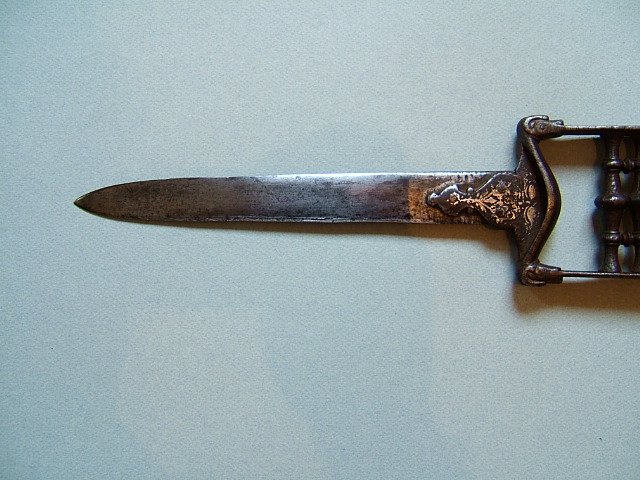

Well I got busy last night and used some 600 grit wet dry sand paper on the blade with water and the blade came out nice. It's no longer brown but I left it with some patina. The side bars are almost free of rust but the grip bars still have some brown patina left. I will post some pics this weekend when I have some good natural light to take them in.

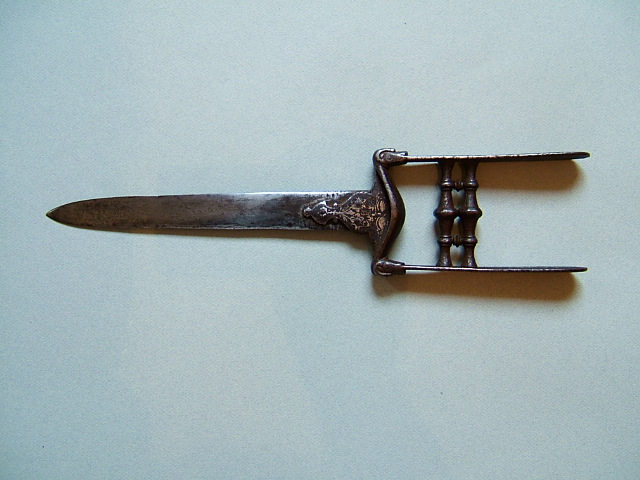

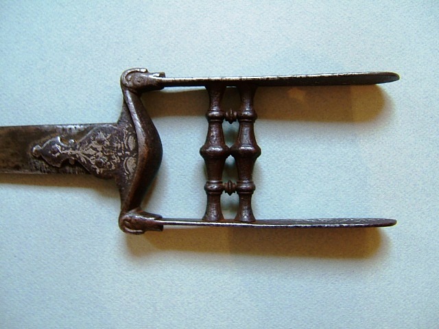

Hi All
Cleaned the katar a bit but left it with some patina.
Lew

Lew, that is one really pretty piece of steel!
Nice job of keeping the patina and still cleaning it up a bit.
