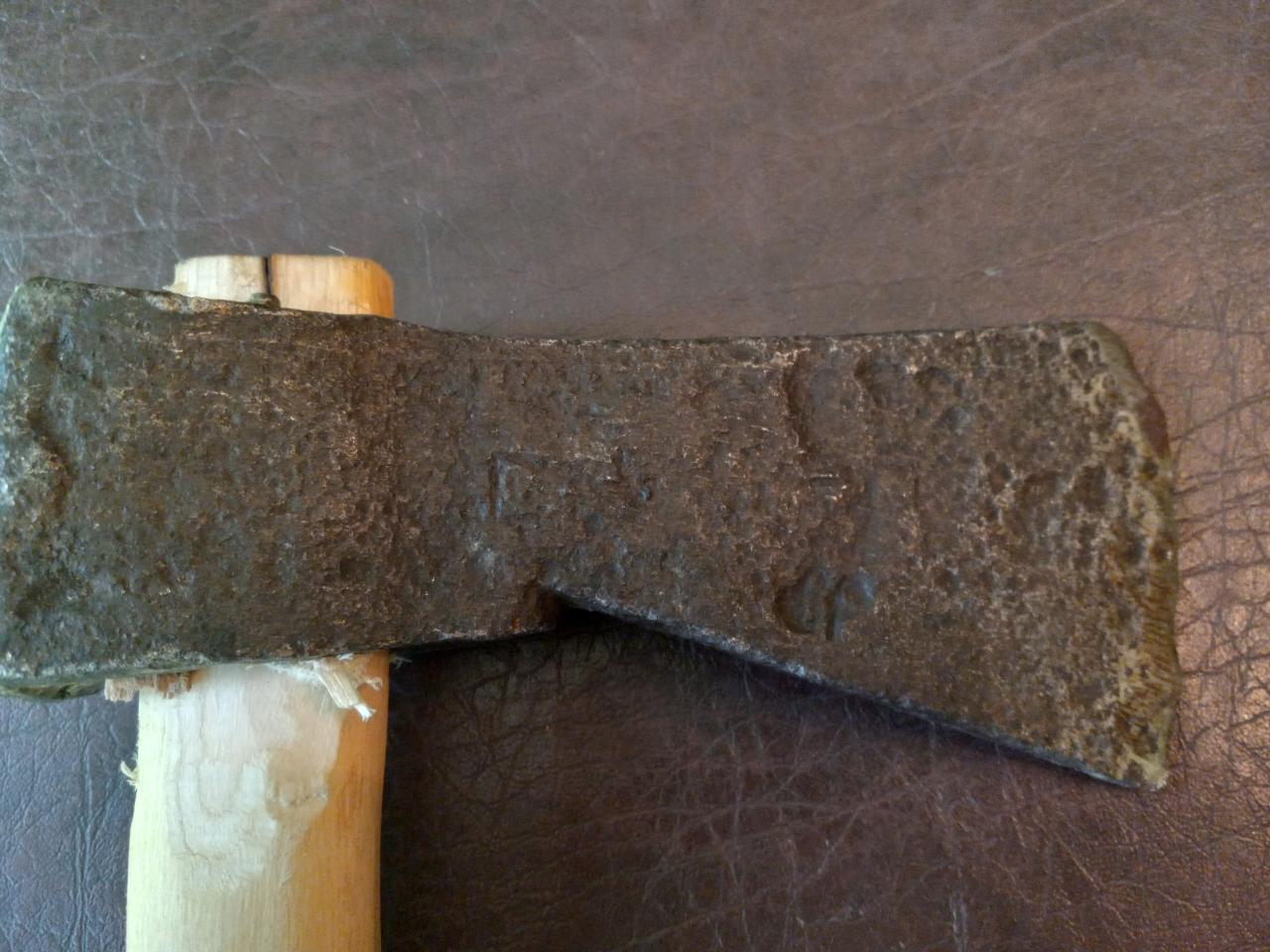

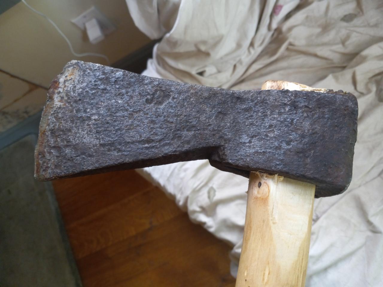

I purchased it in Southern Indiana by Vincennes where the 8th Regiment was involved during the American Revolution.

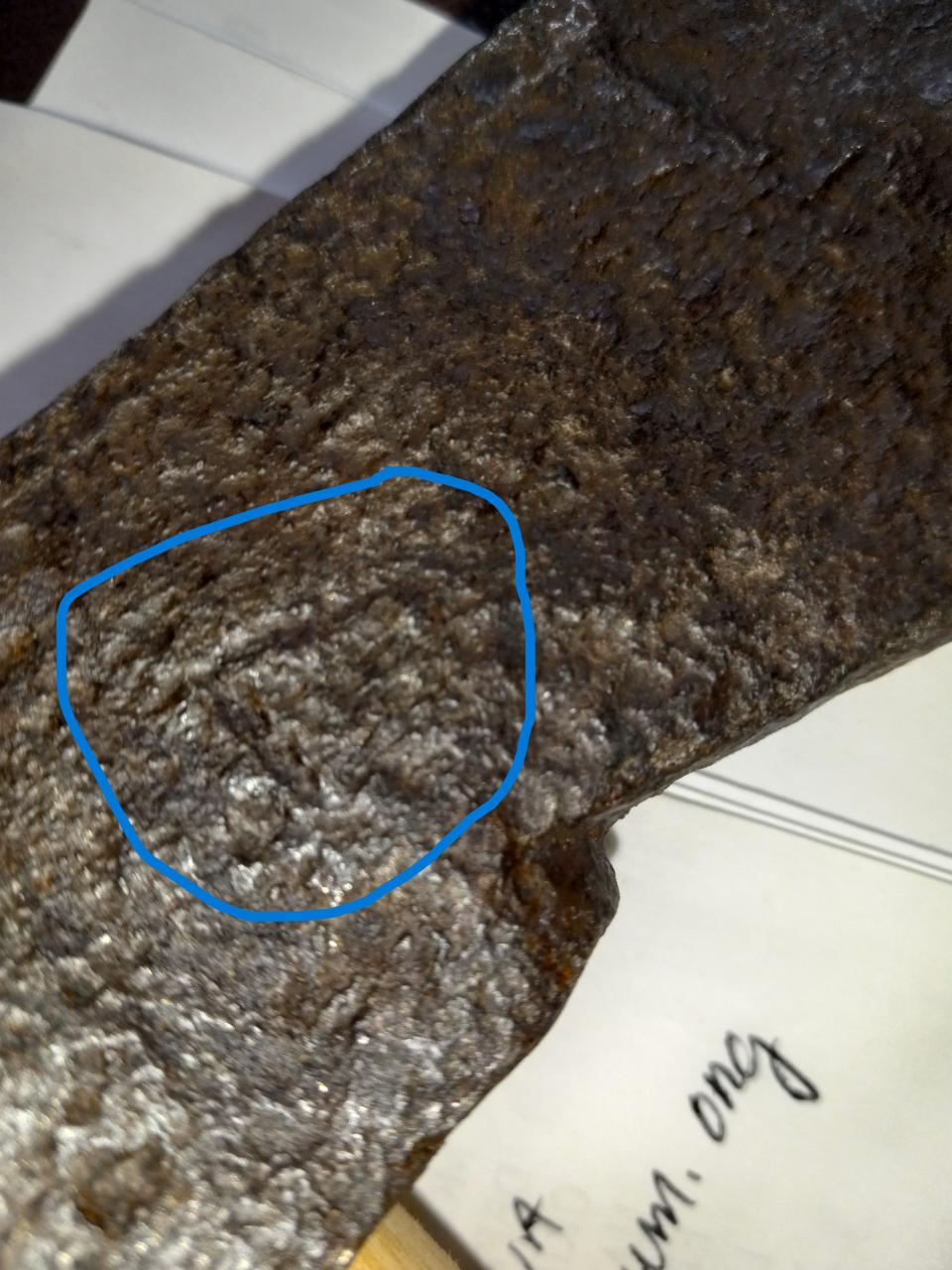

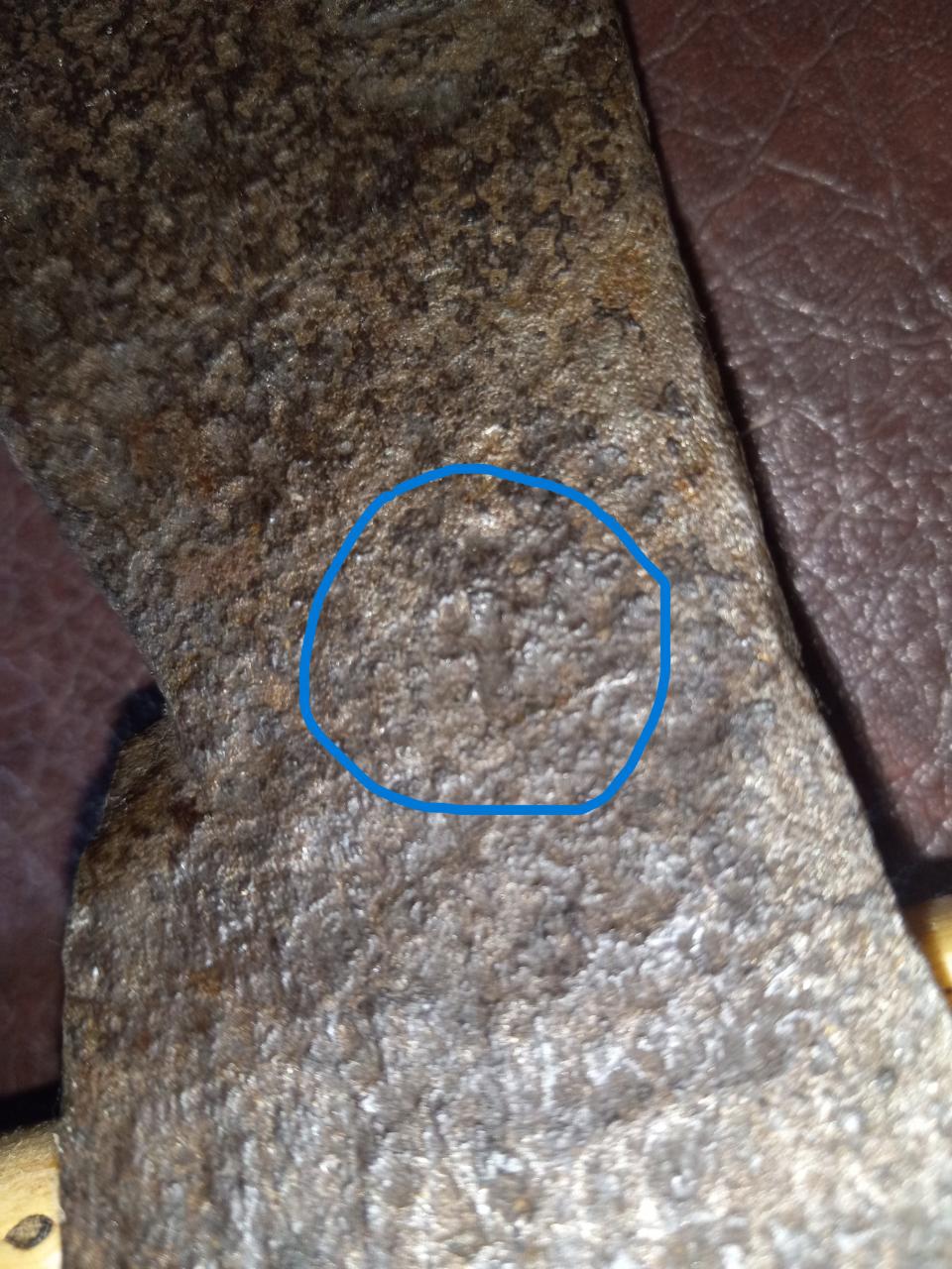

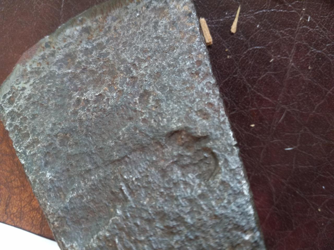

On the one side of the hatchet, there appears to be blacksmith initials and the number “4”. On the other side, are more marks, not sure whether proof marks, rack numbers, “8” with a “P” or “F”? The axe appears to be 18th century, hand forged. Not sure whether I also see a faint broad arrow mark on the side with the “8”.
I added the handle.
The head is slightly under 7 inches long.

I don't think that an ax would be "proofed", that is a firearm issue. Inspected more like.
Nice find.

Excellent example of the old style poll axes. These types made their way into North America with the French and the Hudson Bay Company British fur traders. Both Neumann and Hartzler's guides show similar examples. Great find, Mark!

Are we quite certain that this hatchet head can be called a "poll axe"?

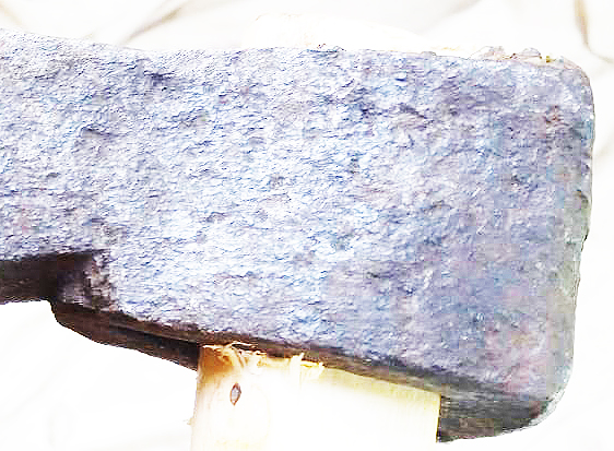

A picture taken from above would help answer this question. Picture 1 seems to show a little thickening towards the heel of the ax. Or are you referring to size?
EDIT: On rereading the entire thread it was originally called a hatchet in the OP. My questions would be is it a belt ax? Which were to my understanding smaller than what we think of an ax today. Either way I like its profile.

I saw "poll axe", but the first thing I noticed when I looked at the pic was that eye was not round.

I think that the poll refers to the back part of the axe head opposite the bit, not the shape of the eye. A round poll referred to the curve around the head not the eye. The axe pictured in 1 is a square poll. Square polls appeared in the early 1700's and were widely adopted because of the use that could be made of the flattened area as a hammer. Hammer polls are those where material is added to make a full hammer shape.

The eye in the hatchet under discussion appears to me to be a teardrop eye, I've brought the contrast up a bit & it is now quite easy to see.

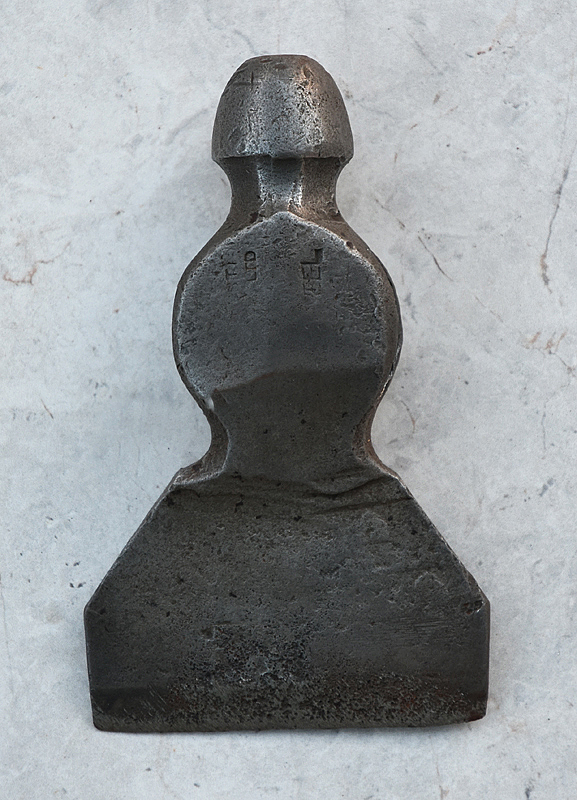

Maybe we could call this a poll axe?
It is a ball-pein hammer head that had a chipped face & has been forged into a carpenters hatchet.
I've never put a handle on it, & never used it, but it is fit for purpose.

Neumann in 'Swords and Blades of the American Revolution' classifies many axes from 1600 to 1800 as round, square, hammer, or spiked polls. Kaufmann's 'American Axes' traces the development of axes from much earlier and also uses the term. This axe would be classed as a square poll axe.
