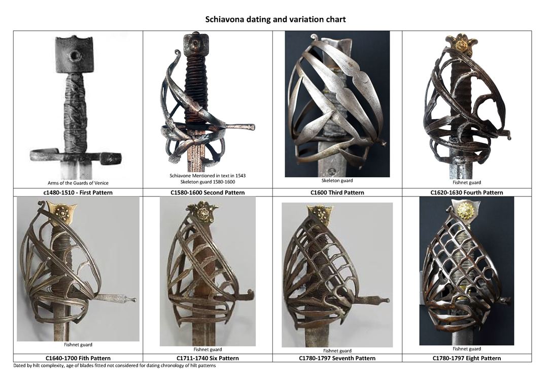

I am trying to put together a rough dating chart for Schiavona Swords. Like many of us I keep a data base of examples that come up at auction however the dating is often just c1600, which given the length of time these swords were around rarely accurate. For this exercise I am ignoring the dates attributed to blades and just concentrating on Guard construction.
This is what I have put together thus far, based on my library and Oakeshott of course. I understand that this is not even close to covering the variations out there, but have just picked those that appear to show the progressive complication of the baskets.
Any help with dating or validating this chart would be most appreciated.

Thankyou Hotspur, much appreciated. I have also just found an article Jean sent me many years ago before we lost touch in French by Martin Ehretsmann, part 1 and 2 the skeleton guard. It is interesting, this is the first article that talks about the different scabbards.
Do you have any comments with regard to the dating chart, it is pretty much a best guess at this stage, I am hoping as I follow up references, I might be able to nail down the developmental stages. I will keep posting updates on my early research. I am surprised no one else has replied if only to criticise the assumptions in my chart.
Cheers Cathey.

As a result of reading a french article by Martin Ehretsmann, part 1 and 2 the skeleton guard, I have revised my chart and brought it down to 8 patterns (or groups) becoming progressively more complex. Ending with the last and most complex of what Martin describes as the fishnet guards.
I understand that this does not cover ever variation but hope that I can use this as a method of grouping available examples and to try and create an easier chronology for collectors, particuarly new collector to follow.
As this chart represents the preparation work for an article on the Schiavona, I would be grateful for any assistance and advice.
I have patterns 2,4 and 8 in my collection and access to a pattern 5, I am still looking to secure patterns 1,3, 6 and 7. However, finding these swords when you live in Australia is challenging.

I’m not familiar with the Ehretsmann articles, and it seems many in the forum aren’t either, so perhaps you can be so kind and share them with the forum?

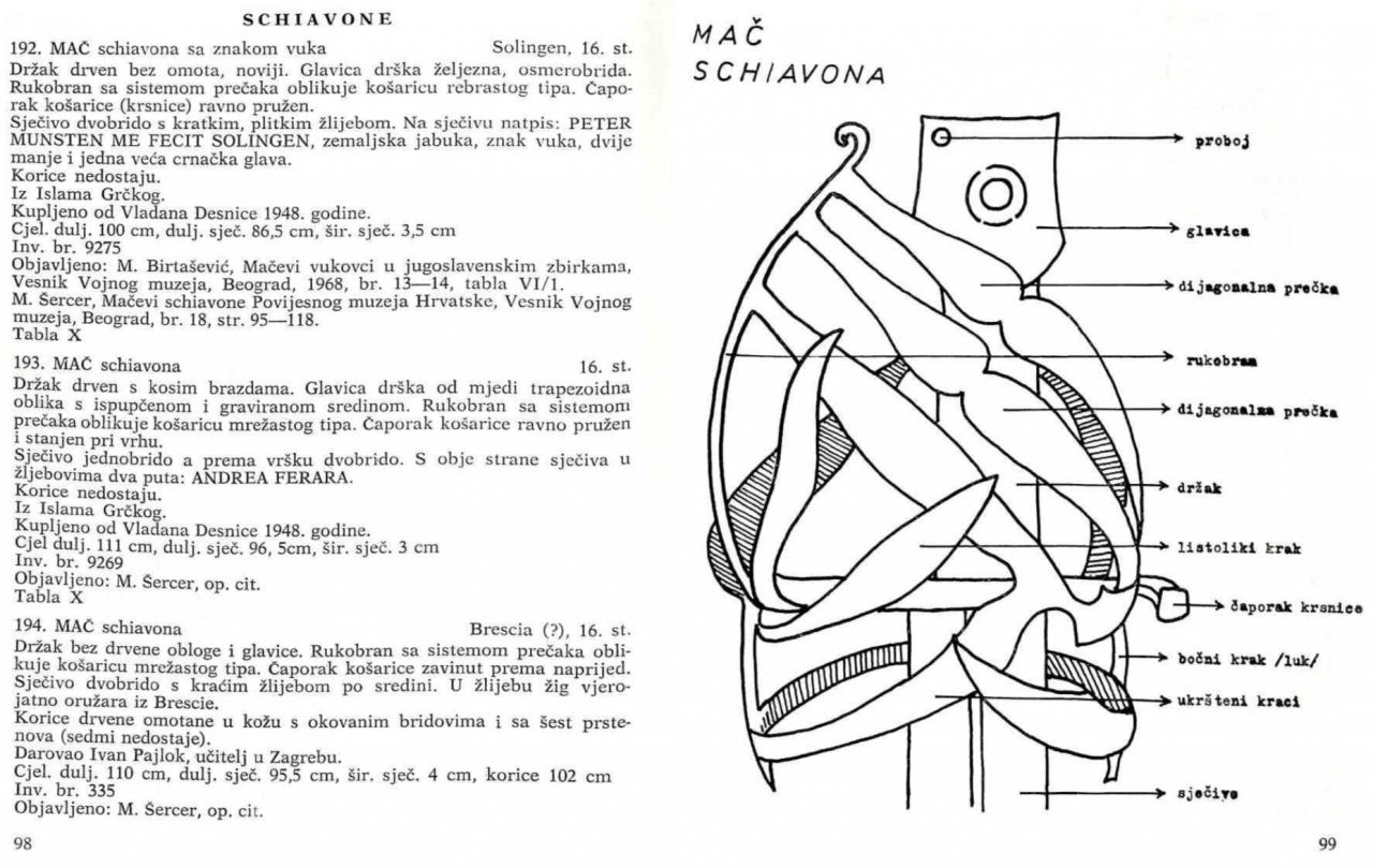

In The Collection of Arms of the Split City Museum (2012) the author Goran Borčić distinguishes between schiavonas with skeleton and lattice hilt baskets which makes sense. He mentions the oldest known record of the spada schiavonesca in a testament from Dubrovnik (Ragusa) dating from 1391.
Citing a number of sources including Marija Sercer (Macevi schiavone Povijesnog muzeja Hrvatske, 1972), A. Cimarelli (Armi Bianche, 1969), Heribert Seitz (1965), etc he provides approximate dating for schiavona swords. The earliest skeleton hilt swords are from 1H to mid 16thC, those with heartshaped sidebars dating from 1600-1640, and the ones with more decorated sidebars from 17th-18thC. The lattice hilt schiavonas date from as early as 2H 16thC with single layer side bar items from 1H 17thC (more decorative ones 17thC to beginning 18thC), double layer side bars from 17thC, and triple layer side bars versions from 17th-18thC. It seems schiavona swords continued in use by city guards on the Dalmatian coast into the 19thC. I think dating the swords is difficult in that they each seem quite unique (not standardised or regulation issue), and Ewart Oakeshott in his book European Weapons and Armour suggests different styles may have been in use concurrently.

Found a link to the book by Marija Sercer but it’s in Serbo-Croat and not many pictures unfortunately: https://www.hismus.hr/media/document...oževi.pdf Needs lots of use of Dr. “Google” translation to get much useful info out of it But the author seems to have been a scholarly lady, the more so given that the book was published during the communist time of Yugoslavia.

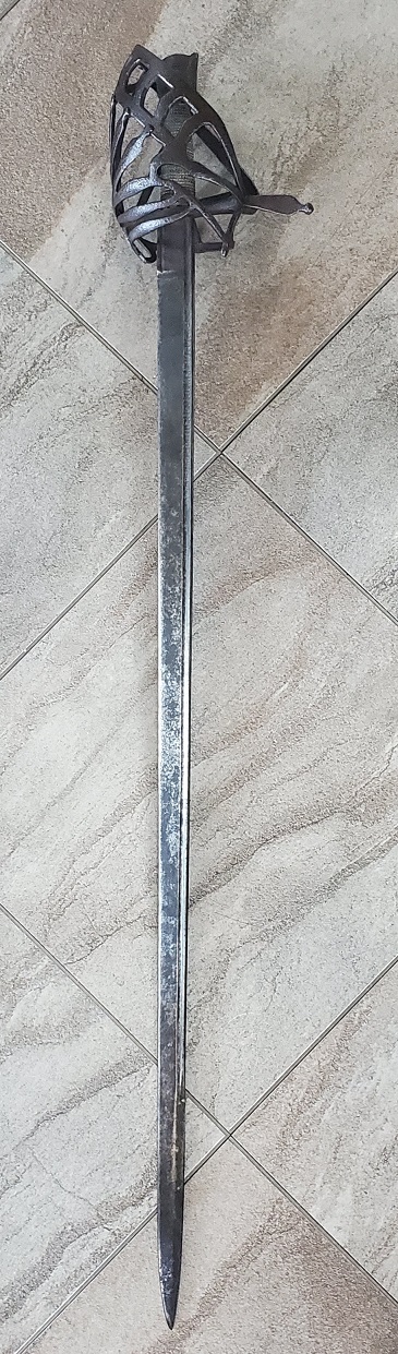

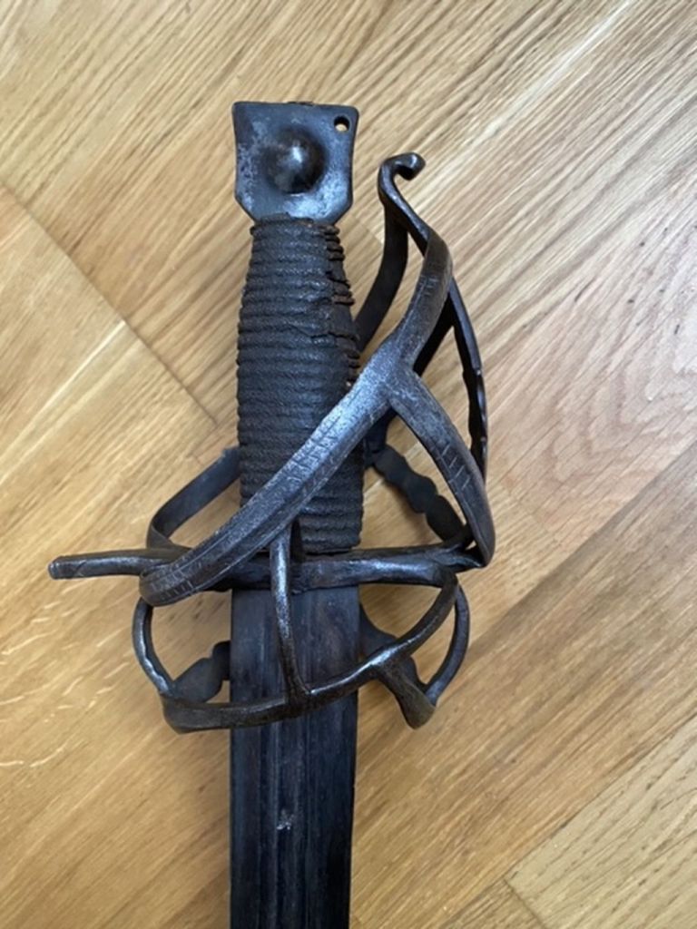

Default my oldest Schiavona

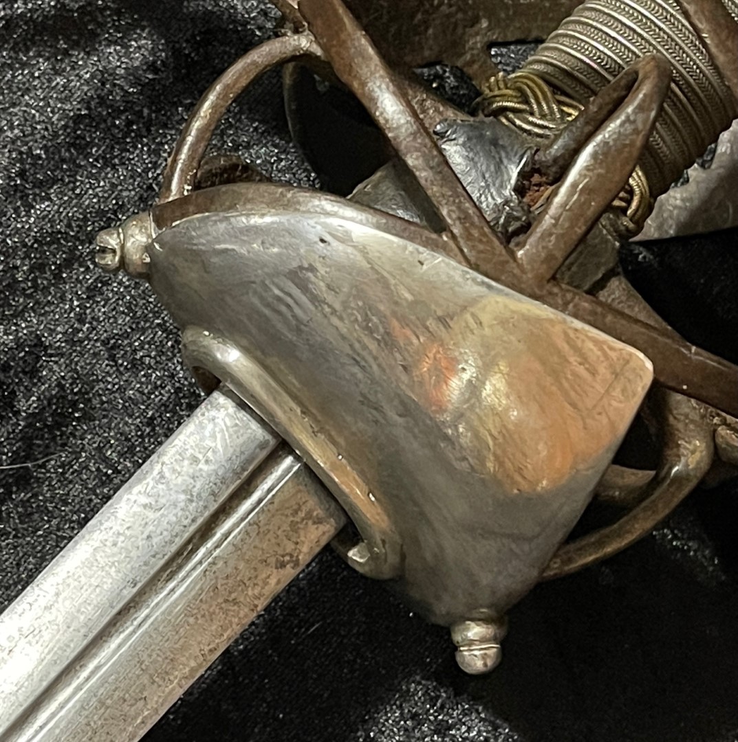

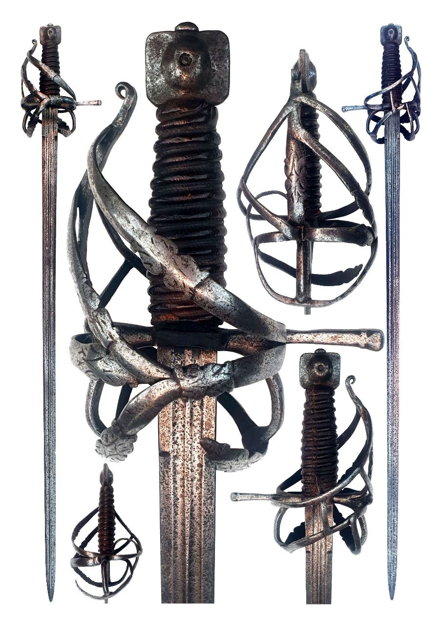

Hi Victrix
I have tried to find a copy of The Collection of Arms of the Split City Museum (Split City Museum, 2012) by Goran Borčić , but it does not appear to be available anywhere. Would you be able to scan the pages relating to Schiavona’s for me?
I have also found some additional material by searching for the word Schiavona sword in Italian and French, and I am now able to start pulling my source material together.
I agree with your observations the more complex the hilt the newer the sword.
Attached is my oldest Schiavona which is has no lattice work and limited bars. I refer to this one as the second pattern and it dates from 1580 to around 1600.
Cheers Cathey

That’s a fabulous sword, Cathey! I think the plain iron pommels are also an indication of age. It seems the bronze ones with relief patterns and “cat’s ears” came later.

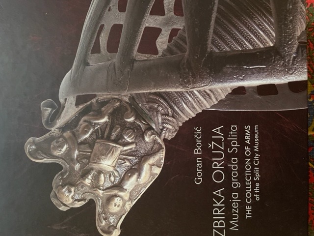

As I mentioned earlier, I obtained my copy of “The Collection of Arms of the Split City Museum” (Split City Museum, 2012) by Goran Borčić by chance when visiting the City of Split Museum on vacation (highly recommended!). Roman Emperor Diocletian retired to Split where he built a walled palace for himself. The old town of Split is built into the ruins of this palace and you can stay in hotels within the ancient palace walls. You could try to contact the museum to see if they still have copies of this publication for sale: https://www.mgs.hr/ and email muzej.grada.splita@mgst.net. Bear in mind that this is a substantial coffee table book and postage fees will likely be substantial. See some photos enclosed on the section covering schiavonas.

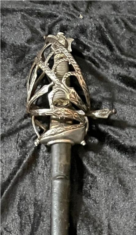

Probably my favourite sword and one I have yet to acquire.
Here are two examples purely for entertainment.

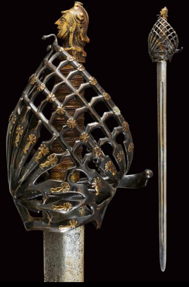

The first one (lattice basket) was auctioned by Czerny last year but was too expensive for my wallet.
The second one is still for sale but you would need to re-mortgage your house to afford it.

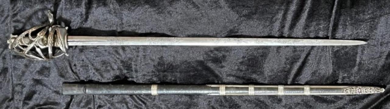

Here is a part of the vendor's description of this spectacular sword and some more photos.
The basket hilt is encrusted in silver, the massive pommel is also silver and decorated with a figure of a noble - perhaps the original owner that commissioned the creation of this masterpiece. The lower hilt is most interesting in that it has a silver guard and original rain-guard built into the tang. The sheath is decorated in leather and pierced silver moulding, and silver extended chape.

Old 7th January 2023, 07:00 PM   #16
urbanspaceman
Join Date: Sep 2017
Posts: 736
Default Me again
I'm raising more questions I'm afraid.
First: what are those little hooks for, if not for attaching to the pommel?
Second: is that a wootz blade!!! on the luxurious sword I posted?

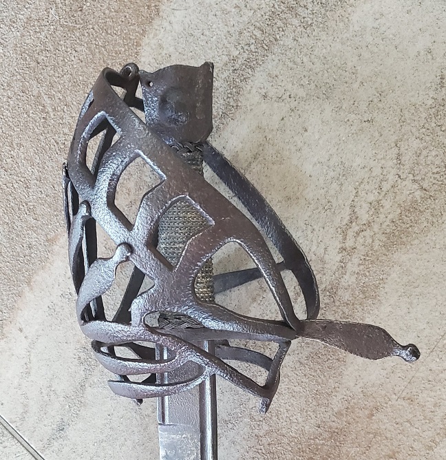

Default The Shiavona
Hi Urbanspaceman
I don’t think we are looking at a wootz blade, just some pixelization in the image on that one. I know the site it is currently posted on and some of the images always appear to be lower resolution and tend to pixelate.
With regard to pommels, it appears the latter the sword the fancier the pommel. Also, if it is a fancier version obviously made to order the pommels again vary greatly. I have a sword with a plain Iron pommel that has a mark for the hole, which is not punched through. The brass pommels and wire wrapped guards appear more often on latter swords, the early one plain iron with leather wrapping sewn in place on the grips.
My article research is progressing, so far I have had to google translate, Serbian, french, German and Italian.

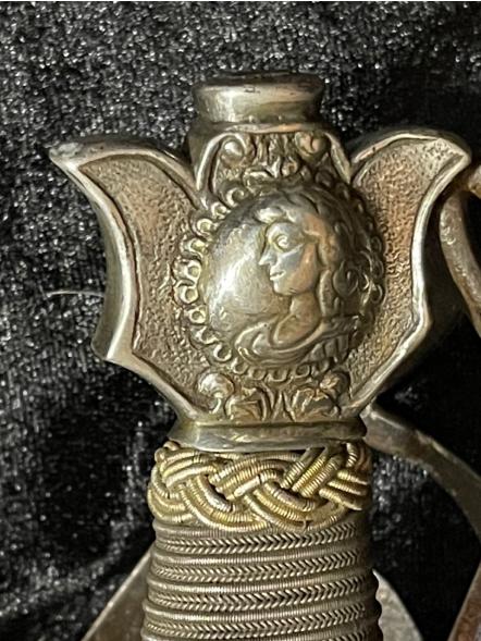

Here is my latest Schiavona probably around circa 1780. Note this one has a wire wrapped grip and the most complex hilt variety, being three rows of lattice pattern. This is the one where the hole in the pommel does not go through and at this stage, I have not been able to identify the mark on the forte.
Cheers Cathey

The last sword may be a composite. The iron pommel looks like a modern replacement to me. The blade does not seem to fit the lattice basket and does not seem to be original to it as the tang is visible and forms a ricasso. A similar composite is illustrated in “White Arms of the Royal Armoury” (Sweden, 1984) by Lena Nordström.

Hi Victrix
I have to disagree with you on this one, having the advantage of having this sword in my hand and knowing the provenance of the collection it came from. Many of these latter Shiavona’s, have blades of this type that are original to the sword. The blade is the correct period for this hilt. Perhaps the photos do not show the age and consistency of the patina on the component parts. Also the entire sword has wonderful balance considering the size of the blade.
Cheers Cathey

Take a careful look at this image below:
there is no pixelation on any of the hilt.
The image is pretty sharp; although I take your point regarding some of his pictures.
I would suggest extra eyes on this one because I think it is wootz but I will wait and see who else agrees/disagrees.
Old 9th January 2023, 09:56 PM   #21
urbanspaceman
Join Date: Sep 2017
Posts: 736
Default Dating
Judging by the basket style, this sword appears to qualify as the fifth issue 1640 - 1700.
Am I right in thinking this keeps it in the Solingen camp?
Is it possible that Solingen had access to sufficient wootz to make this blade?
Considering what a luxurious sword this is, it is not impossible wootz was acquired... perhaps demanded.

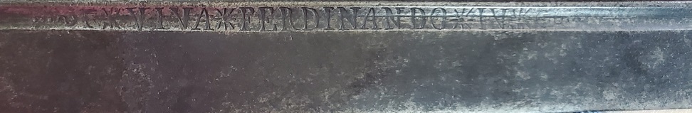

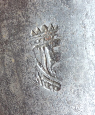

This is the only example I have of schiavona, which is interesting in reflecting the latter period of use of these distinctly hilted swords.
It is in the traditional lattice hilt with asymmetric styling, and the blade is what suggests possible cavalry use as it resembles dragoon blades of Spanish form in latter 18th c.
The inscribed lettering to Ferdinand IV of the Kingdom of the Two Sicilies suggests to loyalists to him during Napoleons conquest of Naples in 1806, and after French Republicans had previously invaded Naples in 1799, with Ferdinand evacuated to Palermo.
The Two Sicilies are both Naples and Sicily which were collectively both deemed Sicily.
Ferdinand IV was son of Carlos III of Spain, and Carlos had built an arms factory in Naples at Annunziata in 1758 when he was king. In 1771 as king of Spain he built the arms factory in Toledo to try to retrieve Spains place in arms making. This may account for the blade similarity to cavalry backswords of the 18th century.
This is an amazing thread (thank you Cathey!) and great to have such a comprehensive look into these swords, and these outstanding examples posted.

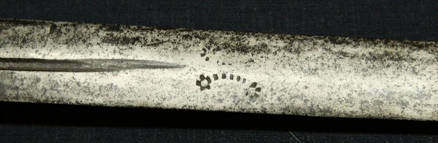

I always have a piqued obsession with perhaps mundane factors, and wonder what the piercing in the upper quadrant of the pommels of these is for. It seems a repeated feature, and in cases, as seen, is not even completely through the pommel.

The 'kings head' on one schiavona blade (Wundes, 1580-1610 Solingen; unidentified mark on another, likely Italian and another 'marca di Mosca' noted from the centers situated in and around Belluno (of course the location of the fabled Andrea Ferara).

It seems most I have ever read regarding evolution of the distinctive schiavona hilt suggests they evolved primarily from Hungarian/Croatian swords with the familiar S-guards seen in the landsknecht type 'katzbalgers' and other such fighting swords of 16th-17th c.
It is tempting to associate the 'cats head' pommel with the cat simile (=vicious fighting) of katzbalger, though clearly this is simply a suggestion.
The Hungarians, Croatians and Venice seem to have been aligned in diplomatic arrangements from the 16th c. onward, though I am unclear on these details.
The so called 'skeleton' type hilts which resemble rib cage I think were termed squelette in French and referred to rapiers with these complex hilts.
I have not seen the examples in Venice of these, but it seems they were well established as a rapier hilt form contemporary to the swept hilt.
It would seem that the lattice type hilt evolved much in the manner of the rapier hilt in Italy which simply added elements of bars and rings for hand protection, but seem to have evolved somewhat gradually. The Italian arms makers were known for innovation and very much set the pace for arms and armor in these periods.
I think such evolution of the schiavona hilt most likely evolved in Italian context with the Dalmatian swords having their innovation added from early times in 16th c. in accord with other Italian sword development.
The lattice style is unique, and it is hard to determine what influence might have promoted it.
The basket type hilts of forms of dusagge and such fighting swords of North Europe and Germany may well have influenced the hilt design.
It was once thought that the Scottish basket hilt developed from the influence of the schiavona, but these seem to have evolved from the same European developing of the baskets on these swords.
