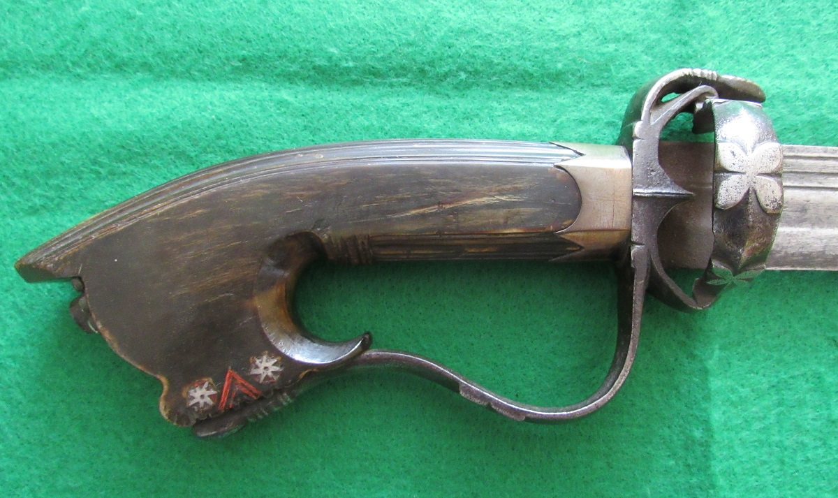

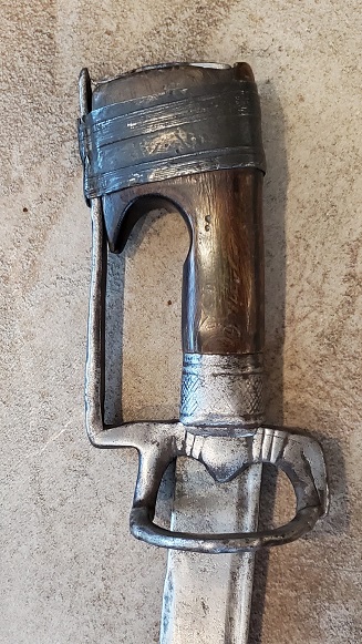

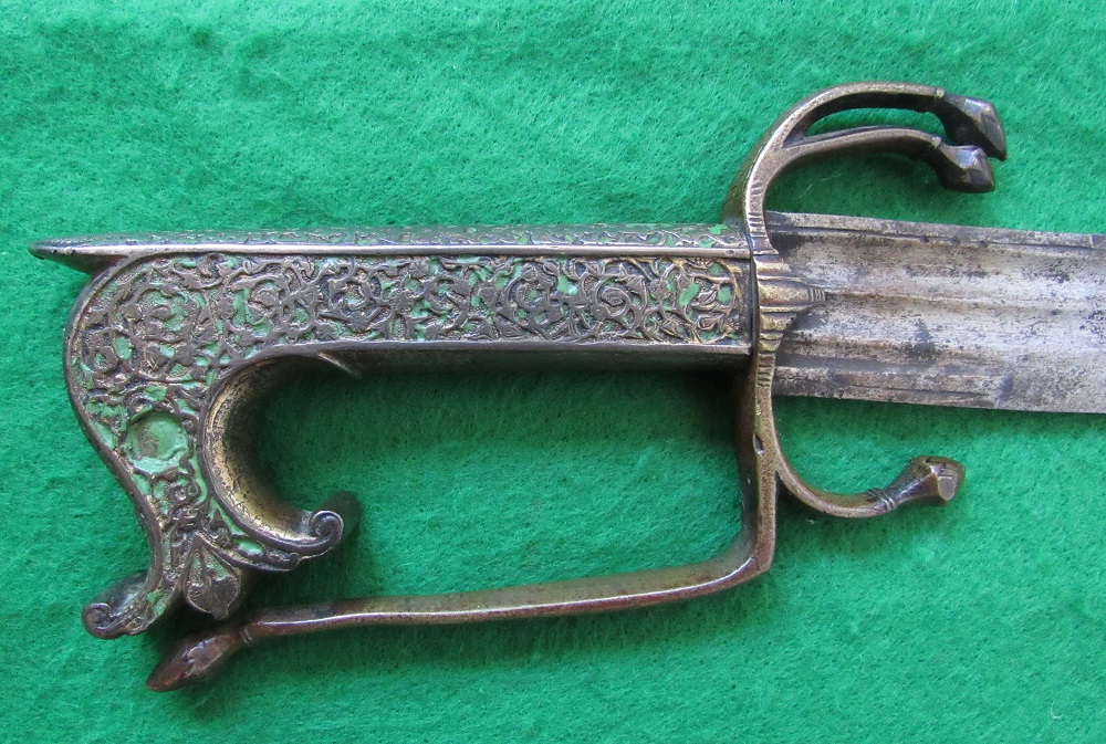

Type I - Guards with a D-Ring. These are all the Zanzibar nimchas with a D-shaped ring to the side. As a general rule, these all have hilts of dark horn (I know of at least one example with an ivory hilt, but it is a really rare exception). There are two sub-types within this type.
Type IA - Guards with a D-Ring where the D-Ring is filled. Those guards are the hardest to forge and all the ones I have seen are on nimchas of high quality, with nice blades, hilts and scabbards with fittings almost always made of silver.

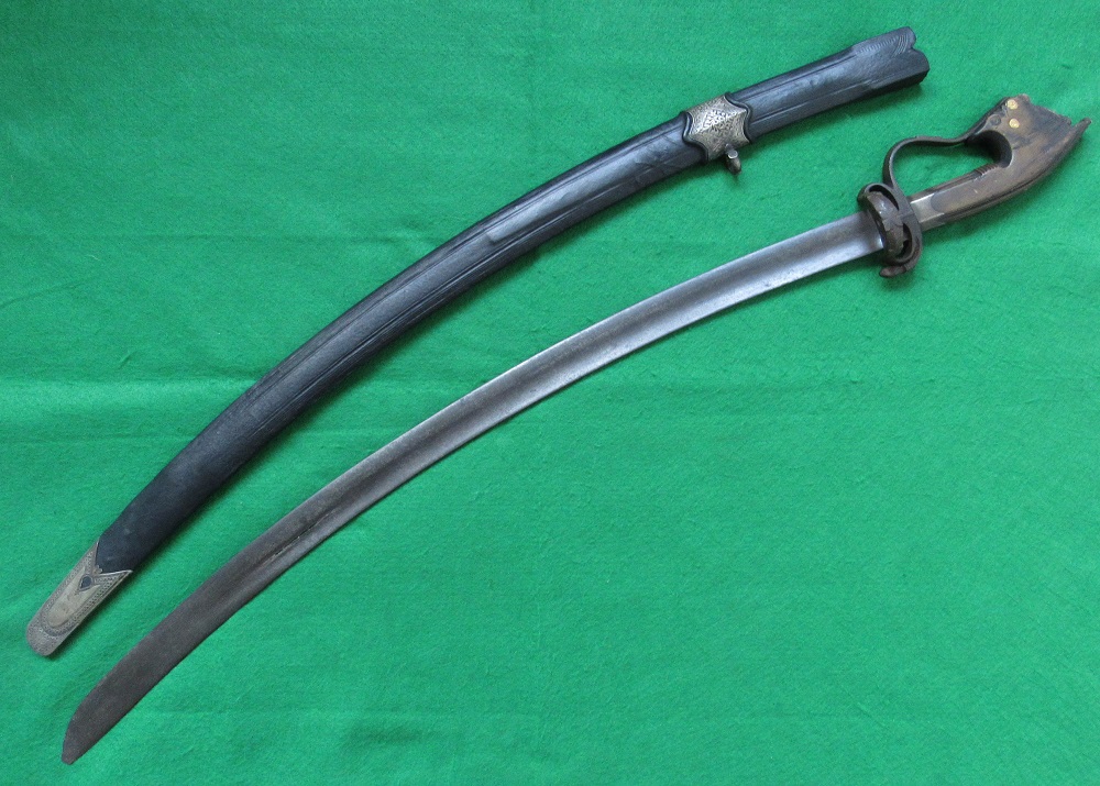

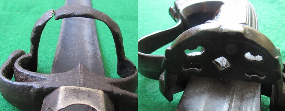

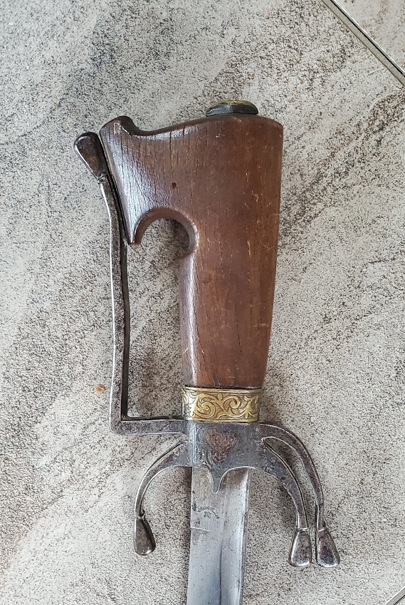

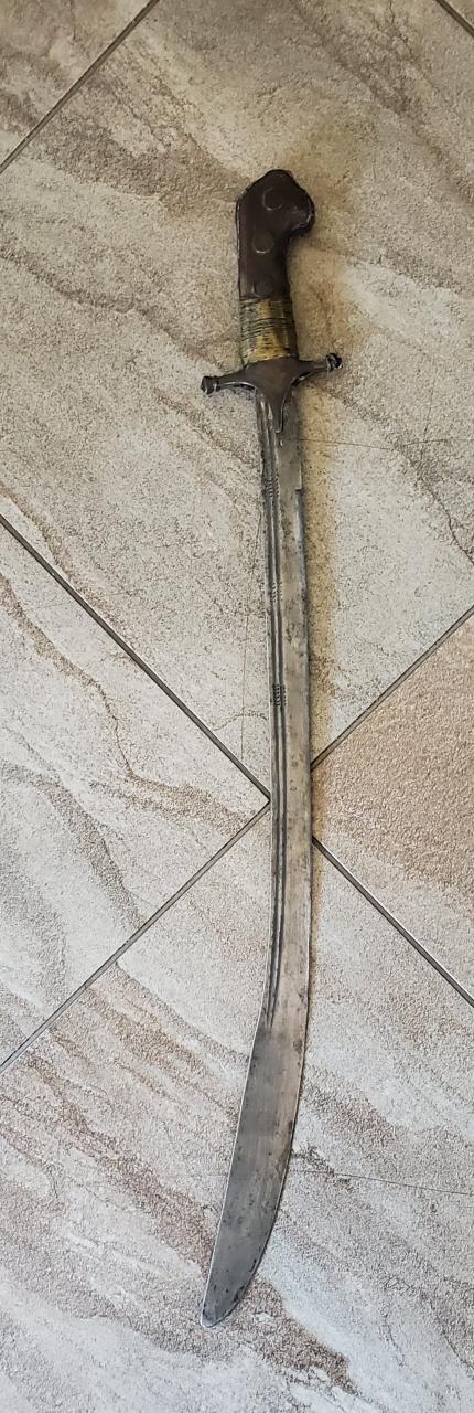

Type IB - Guards with a d-ring where the ring is not filled. Those are almost the same as IA but the rings are just that - rings. Some nimchas of this type are just as nice as the IA ones, while others are of lower quality. On my example, the ring is actually broken, perhaps showing a potential structural issue with Type IB compared to Type IA.

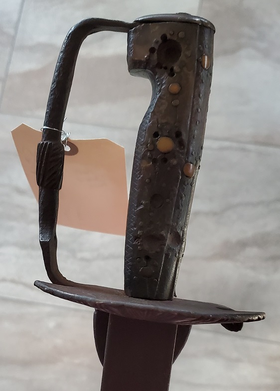

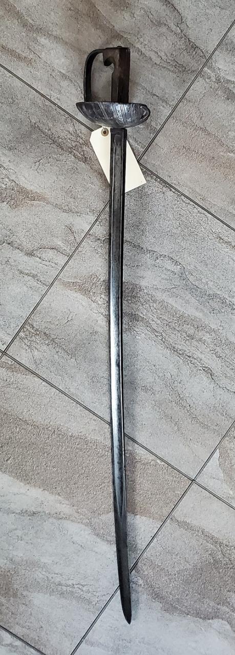

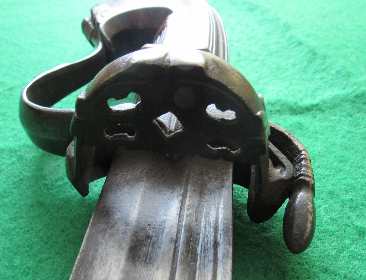

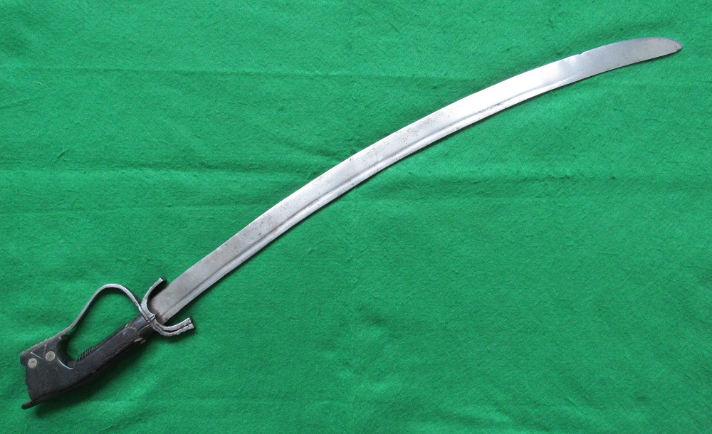

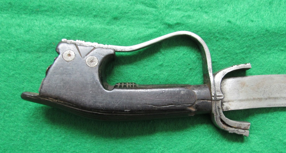

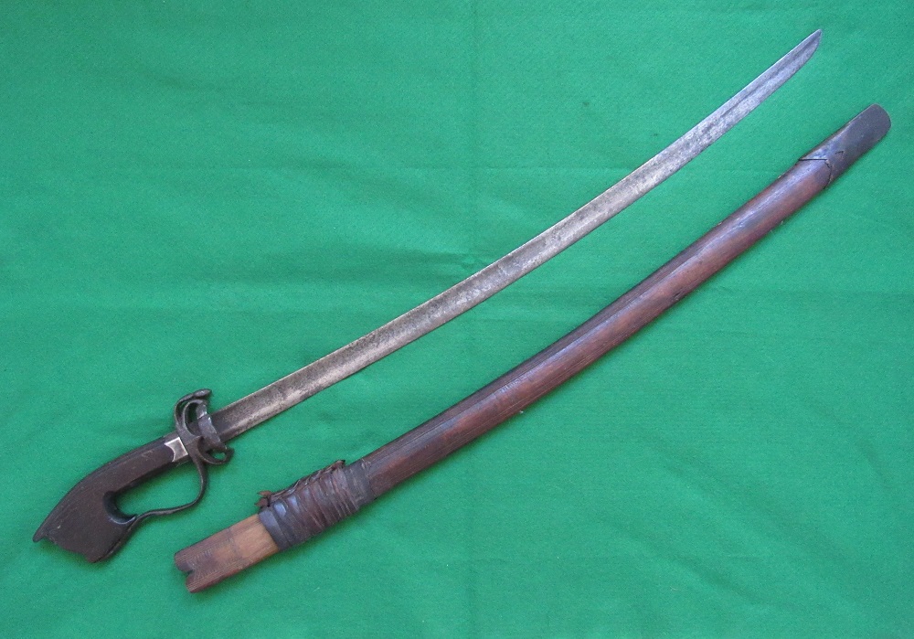

Type III - No guard, the quillons' finials worked to resemble the heads of dragons (or other monsters/animals). You can see some very nice examples in Hales, and for a really low end of the spectrum example you can see mine below. Many of the hilts with this guard are made of ivory and many also tend to be decorated lavishly with gold or silver. The vast majority of this type have curved blades, though there is at least one such nimcha with a straight blade.
