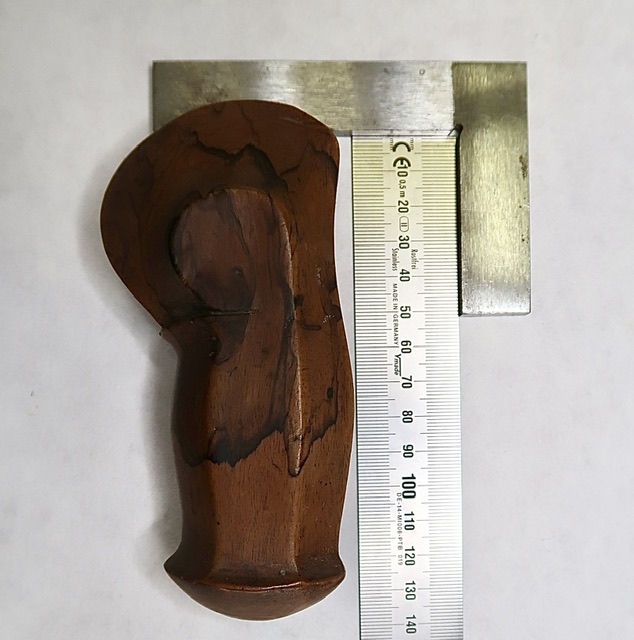

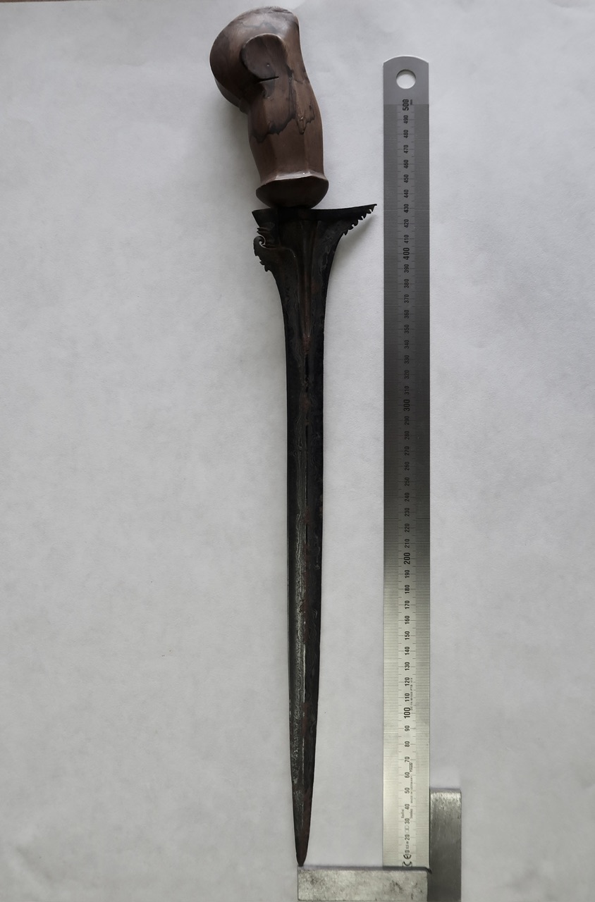

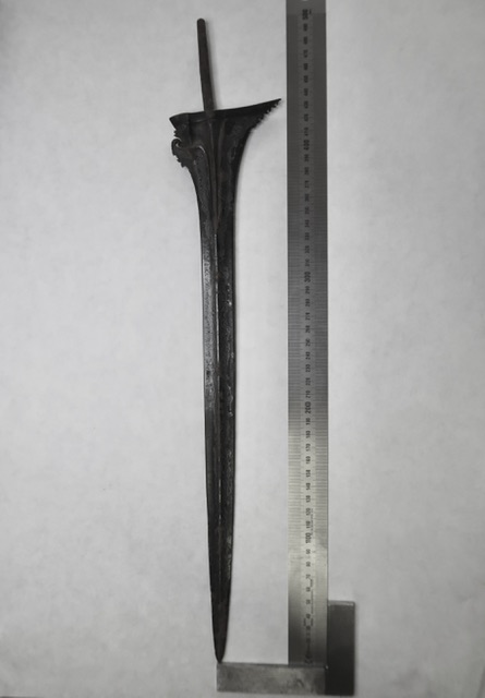

Hello all,
My name is Martin and I am from Amsterdam, i am a teacher in restoration and art history and collect since several years Keris mostly from Java Surakarta and Solo. Although the occasional Sumatra Keris is in my collection too.
After lurking for months on this forum about the Keris I will post my last addition to my collection. It,s a Balinese Keris I bought at an auction and it comes from a Dutch collection that was housed in a castle in France since 1923. Sadly no warong or mendak. It,s a beautiful blade I guess from the 19th century. ItÂ’s slightly rusted and I just started the removal of the surface rust.
Would like to know in what type of warong it would have been dressed..
Best wishes, Martin

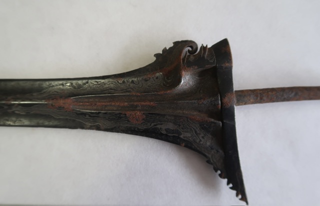

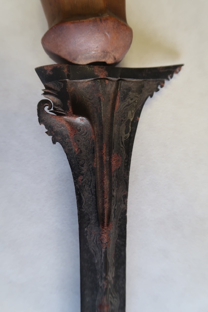

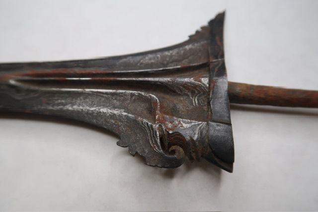

This seems like a decent blade and does seem to present as Balinese, though the greneng seems a bit strange me for 19th century Bali blades. Though i can't think where else i would place this blade.

As David has commented, the greneng is not really what we might think of as typical for a Bali keris. I'm wondering if this particular keris might be a bit older than it appears to be, or another possible reason for this greneng variation could be that it has been made somewhere out of the mainstream.
Still, all that perhaps irrelevant detail that I've written can be put to one side, this is a pretty nice keris, and well worth bringing back to life.
