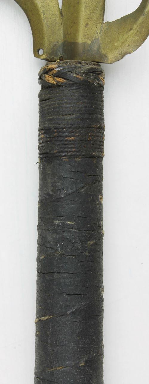

I recently added a remarkable spear to my collection.
Total length: 239 cm
Length spearhead: 20 cm
Length shaft: 219 cm
Length sleeve: 33 cm
The shaft is plain over the whole length.
Does anyone more about this type?
My guess would be a kind of ceremonial spear from Java.

It is is a shape called Nenggala. Ones made of iron were used as weapons at Raffles time. They can be found in Central Java and Pasisir, and I have seen one like yours, Besi Kuning, collected in Borneo.

Albert, are parts of the blade gilded. If so, that suggests a ceremonial role to me. The blade reminds me a little bit of an African throwing knife.

Nenggala is, I believe, North Coast Jawa terminology for this blade form, in Central Jawa it is known as a "Cis" (pron. : "chis"). The Javanese word "cis" means "angkus" or "elephant goad".
In East Jawa it is known as "pancing buaya" = "crocodile fish hook", for the very good reason that it was used as a crocodile spear.
In parts of East Jawa these were still being made & used as crocodile spears up until about 1950.
Interestingly, the word "nenggala" means "plough" in some dialects & in Balinese, it does not take much imagination to understand the similarity in form of this blade shape to the shape of a Javanese/Balinese plough blade.
Hello Ian, there are no guided parts.
The whole is entirely of brass.

Being made of brass might fit for a blade used for fishing. No corrosion in salt water.
