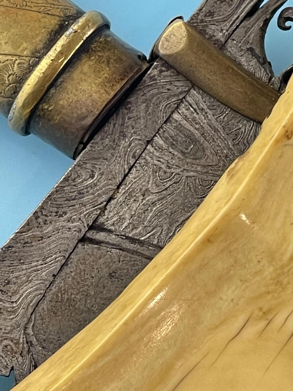

Just to show one example, this was sold a few years ago on Catawiki , it certainly was a new example but I think it fairly depicts the kind of thing which I do mean

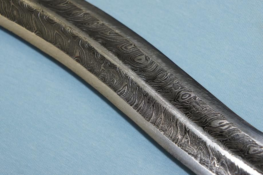

Yes, they can be laminated for sure but don't get etched with warangan like the recent example Milandro has shown. I think that he means this.
yes, this is what I mean.
I have seen a number of modernly made Melayu Sundang kerises with pamor made visible and evident by washing with Warangan on internet .
If you look for the term " Sundang Melayu" Keris" you will come across several and also on Youtube there are a number of videos by Malay makers and collectors.
Undoubtedly the vaste majority are modern made krises (much frowned upon here I gather) . I would still like to see examples. I am not at liberty to publish what I can see because they are all items for sale (with the exception of the one shown above which was auctioned a long time ago and beloved at that time to a Dutch dealer ).

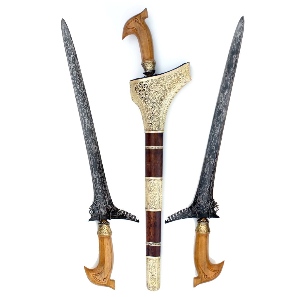

Post #1 shows a keris & dress that was most probably released to the world through Pasar Turi in Surabaya. The keris itself, ie, blade has been made by Madurese craftsmen in either Sumenep area of Madura or in Surabaya & hinterland. Time frame is post 1980. This is not a guess.
In Post 11 the keris on the reddish backcloth has the same or similar parentage. Again, not a guess.
The keris with 7 luk & twist core presents every indication that it is 19th century Brunei. My opinion in this case is based on a similar keris that I have in my care & that was the state execution keris of Brunei, dating from 1842, and the fact that the only other keris of this type that I have handled also came from Brunei.

Alan,
I guess, this Sundang could be quite similar to your specimen from Brunei.
I understand why certain people would attribute it to a Madura smith. I am quite sure, there were Madura smiths working on Peninsula too. On the other hand, wasn't Jasper&Pirngadie writing about smiths from Terengganu working in malay parts of Borneo? Some kind of geographical loop, which is very acceptable.
Sundang from #11 has a quite distinct Luk shape, and this Luk shape points to Terengganu. Kembang Kacang is different from the example I posted here below. Its sheath is (or better say, was, for antique examples) specifically Kelantan, which borders to Terengganu.
By the way, that Sundang from #11 is Luk 5, not 7.

Gustav, in respect of geographic location of origin of the keris in post 11.
When relative certainty is lacking, we can hypothesise with relative freedom. I can only be relatively certain about a very limited number of things, & I try not to hypothesise about things where I lack sufficient data.
My opinion of place of origin of the post #11 keris is based on very limited certainty: the presence of a limited number of indicators that match with a limited number of keris from a known location.
However, what I do know with absolute certainty from Jawa is that the overall form of keris and the characteristics of keris detail do change from period to period, geographic location to geographic location, and maker to maker, but these changes occur within defined parameters. I believe it is reasonable to assume that a similar pattern of change can occur in other types of keris.
In respect of the number of luk in post #11. My initial professional training was in accountancy, one of the skills I learnt quite early in life was to add 2 + 2 and make 5 --- or 3 --- or in fact any number that might fill the need.
It is not such a big jump to turn a 5 into 7.

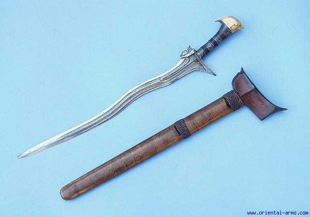

It is interesting Gustav, the reference you note about Jasper & Pirngadie and their studies. Has the work been published?
I was sharing similar imagery to an author about the subtleties of Malay state influenced Sundang in the Borneo and Sulu regions recently, although that seems to have died a natural death...
The Malay states of Northern Borneo is a fascinating region and it is quite easy to see influence from Terengganu for me, not so much Kelantan, my eye is not yet trained to pinpoint these aspects.
I still struggle with modern keris, only in so far as misinformation and those mimicking other cultural materials.
There are thousands of "Malay" types that are modern Java made keris, made in the name of commerce.
They are bought in to Malaysia and sold on. The issue I am seeing more and more is many of these are being bought at the point of sale in Malaysia and then aged, mixed a little with other components, sometimes non regionally correct dress and sold to new collectors as old pieces over and over and over again...

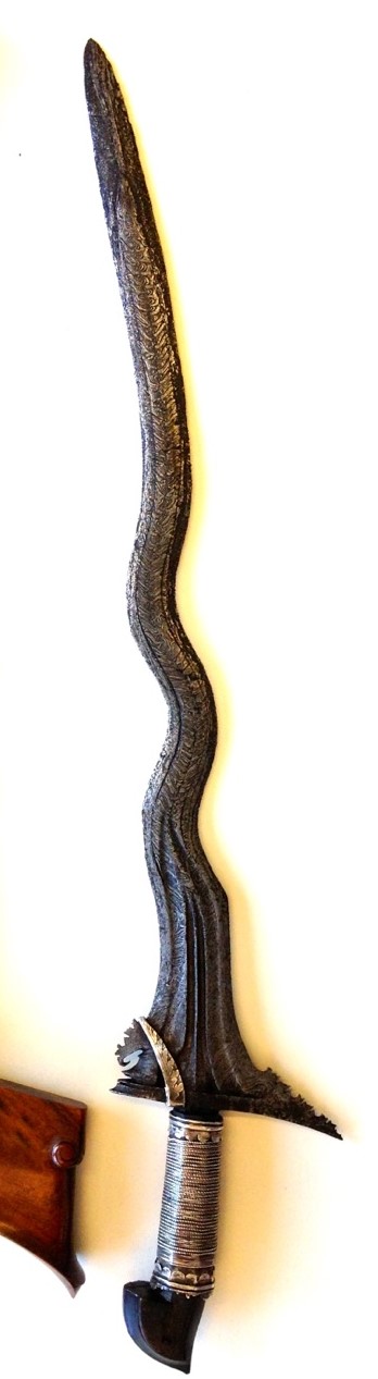

Attached are a couple other other images.
A 3 luk kris that retains a stain in the parts not over polished.
The other the sundang I referenced with the twist core gonjo.
Gavin
