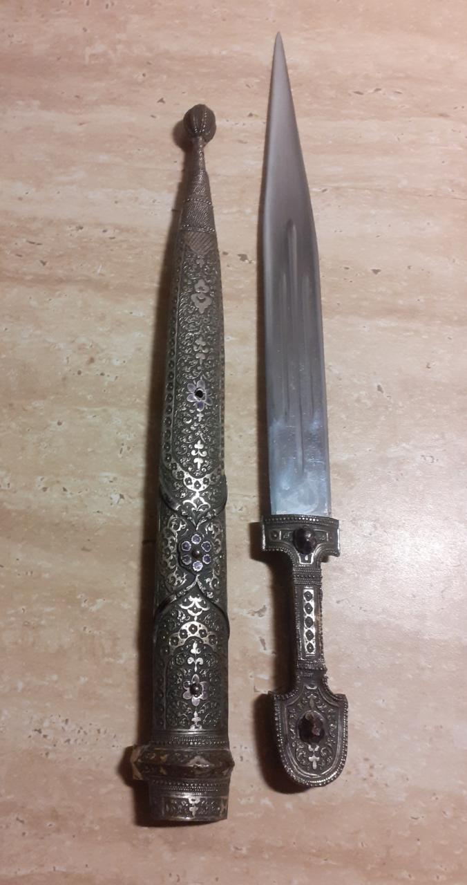

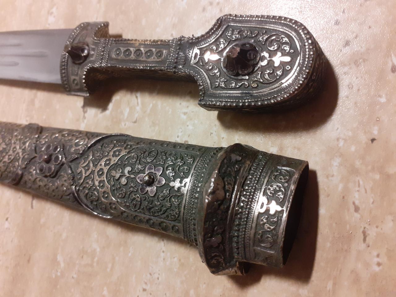

Good evening everybody,
What do you think please of this kindjal ?
A ''bad'' recent blade but the scabbard seems well made and not top recent.
Maybe silver or silvered copper with some colored parts.
A recent copy ? not the usual recent kindjal but made for look antique ?
Or an antique kindjal with a new blade ?
? ( hilt seems broken and welded again )
Last : mid 20th model when real blades disappeared...

Can you show the back of the scabbard? Sometimes there may be a telltale mark.

According to the style of decor, I can assume that this dagger was made in Dagestan by an Avar master from the village of Gotsatl. Production time - 1980-1990. I agree with ariel, you need to look at the back of the scabbard. If the item was made before 1991, then there will definitely be manufacturer's marks.

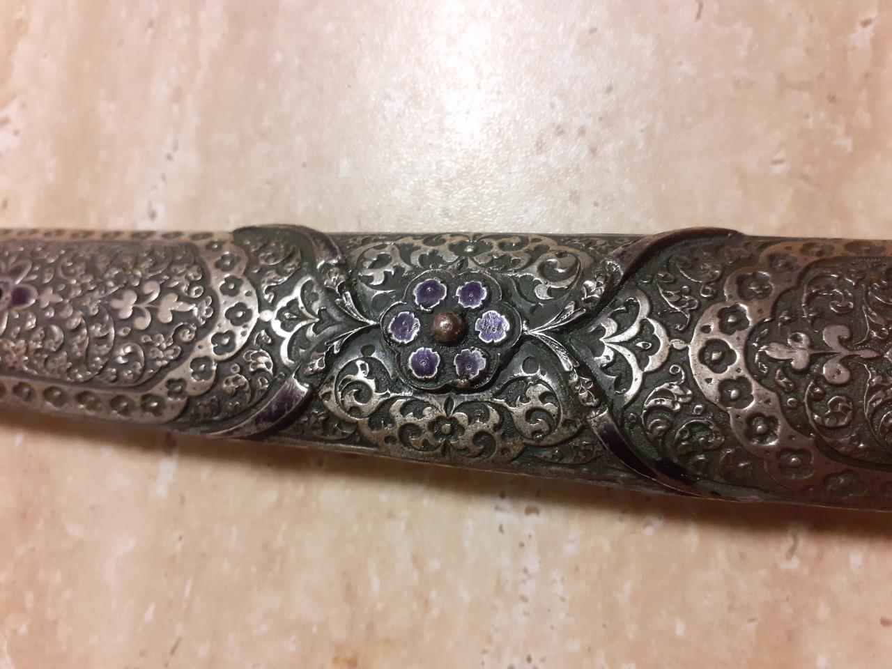

Here some pictures of the back of the scabbard.
Really nothing special / no stamp or other drawing / engraving...

Well, the back of the scabbard was not informative, but even without it one can be certain that we are dealing with a recent, mass-produced tourist kindjal. Nothing “old” or even “vintage”.

Here in the Caucasus, there are many of these new made kindjals available in flea markets and tourist areas. Some are even purposely aged to look like antiques. But it is also quite possible to find true antique fittings for the blades and scabbards. Some people are making use of these on new blades.
It is very easy to distinguish a "tourist kindjal" - the hardness of the blade cannot be higher than 25 HRC. This rule was valid in the USSR, and is still valid in Russia.
