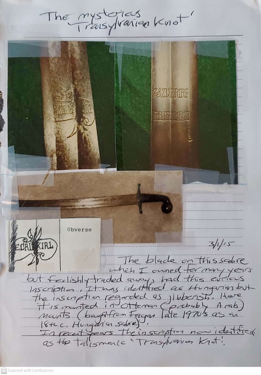

The 'Transylvanian knot', if I understand correctly, is simply an idiom describing a phrase or group of symbols or words in acronym or combinations thereof which are intended as talismanic or magical imbuement. As I noted, in the 17th and 18th centuries Europe had popularized these kinds of themes on blades in many cases. Addendum: Just found photos of a saber I had, since 1976, but traded it away in the 90s. I bought it from a well known mail order dealer with the 'description' (?) '18th century Hungarian hussar saber. It turned out this was an Arabian saber hilted with a much favored Hungarian blade. I was told the inscription was basically 'jibberish' and non translatable. I was surprised in 2015 to discover this material on the 'Transylvanian knot' which told a lot on these strange words on the blade of this saber. I wish I still had it. Last edited by Jim McDougall; 2nd May 2021 at 01:40 AM. |
#9 |
Posts: 10,859
Adding the photo for previous post as unable to find manage photos attachment in edit.

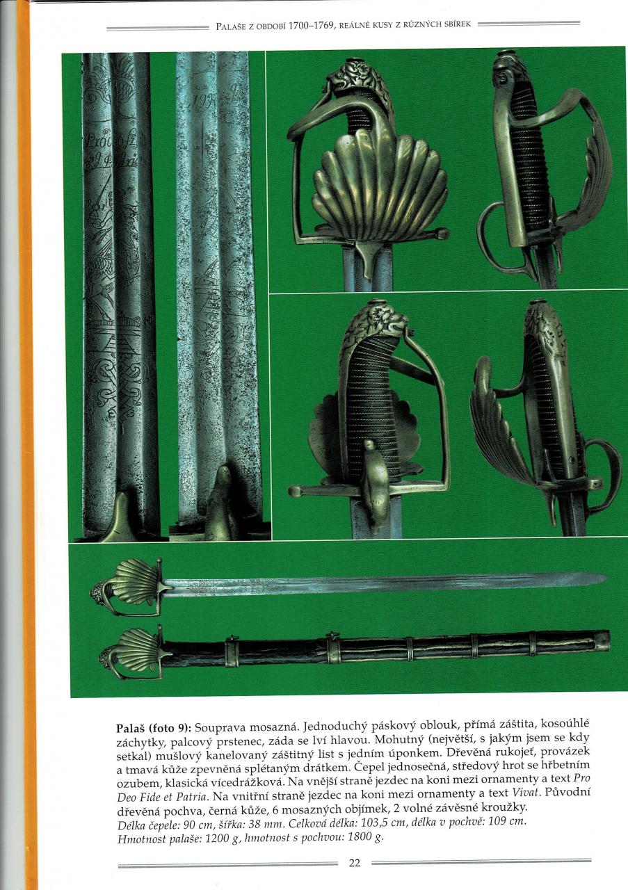

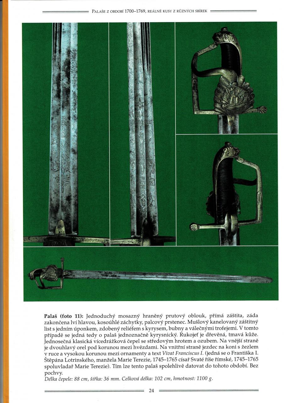

As Hungaqry has been a long time part of the Habsburg monarchy the following title might be of interest too. Jirí Protiva, Palase habsburske monarchie, hardcover 193 pages, ISBN 978-80-86783 0-37-6, Hungarian text, at the end of the book desriptions of all pieces in German language. It contents 120 colour prints of swords (pallaschs) of the Habsburg army between 1679 and 1825. For those interested in this kind of arms this book is very commendable.
#12 | |
Posts: 10,859
Thank you so very much Udo!! This looks like a most useful reference and great photos. I know what is meant by many of these publications only in the languages where published, but many have taken to including English sub captions and often summary text. |
