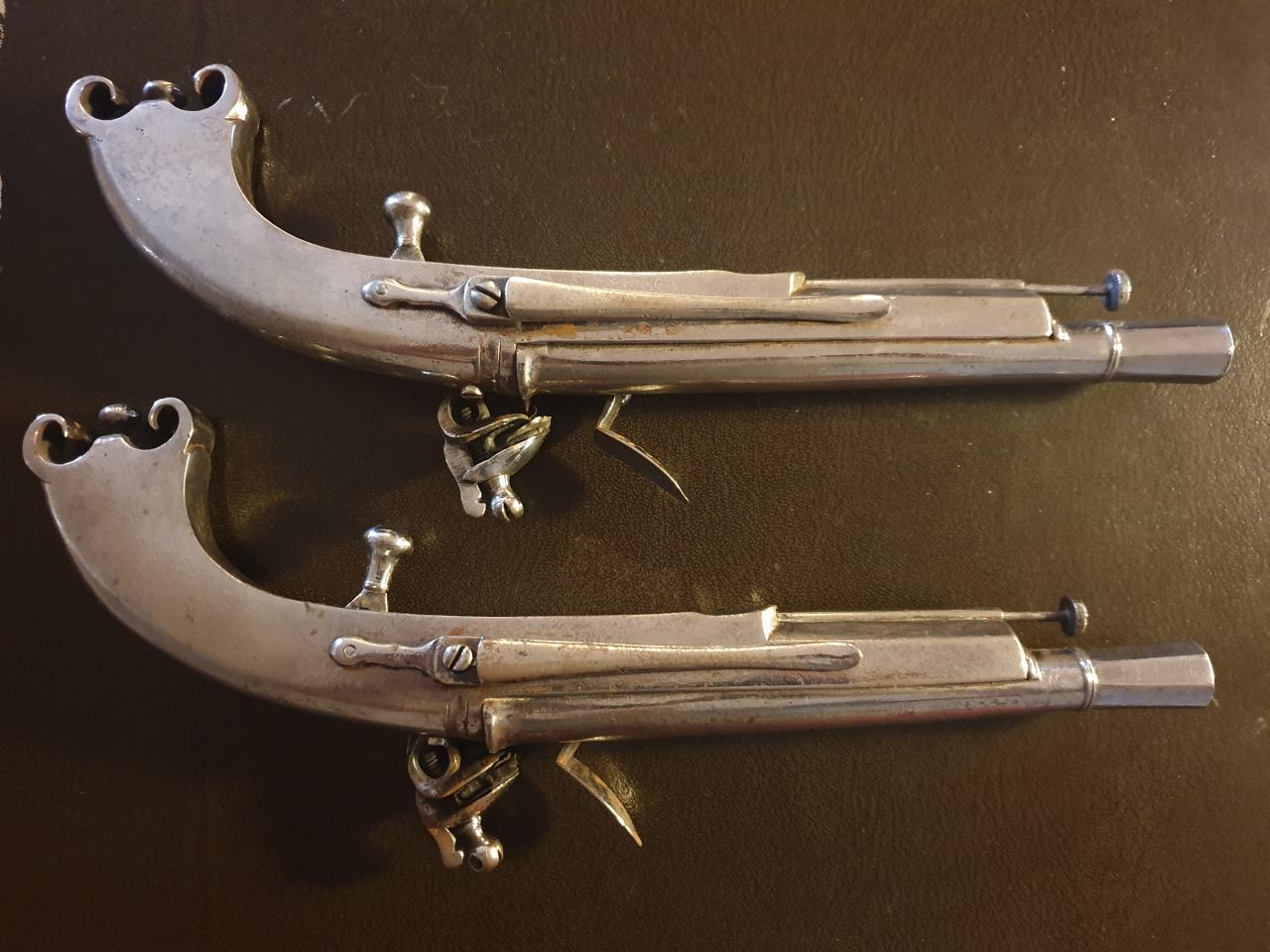

My knowledge of Scottish flintlock pistols and early Scottish snaphance pistols is very limited. I just picked up this pair in the Scottish style marked / stamped Tower.
Assistance in dating and identifying this pistol pair would be much appriciated:

Posts: 432
They appear to me as somewhat crudely made reproductions. They would function well for re enactors props.

Old 1st May 2022, 09:53 AM   #4
Well Tordenskiold, Will's prompt judgement sounds as if he is well under what goes on with this type of pistols.
Alli know about them is that they are not easy to find and not cheap at all ... specially being found in pairs,a greater added value.
Let us expect Will offers further details that explain their non genuinity; or that other members step in to opine in this subject.

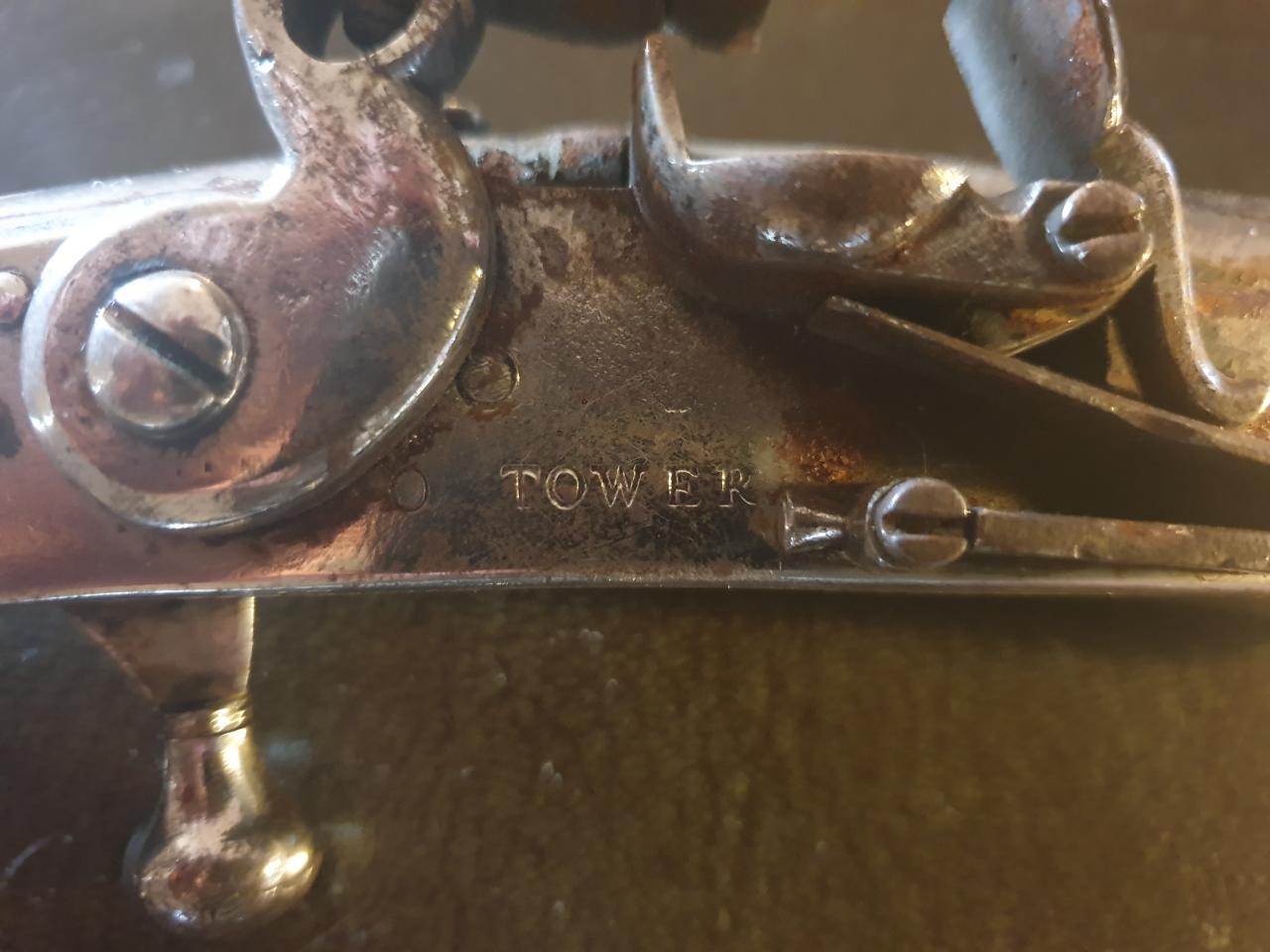

Posts: 252
Admittedly the quality doesn't look great and the stamped (?) Tower difficult to account for . But . A lot of Scottish pistols were in fact made in Birmingham . Bissel was prolific maker . Paradoxically a lot of modern reproductions copy Bissel type pistols from the 1770s because they are relatively plain and easier to reproduce than the engraved Scottish examples. The attached shows a late pistol by Bissel which like the pistols under discussion has a military style ring neck cock and the later style of cock spur. It's from Edinburgh castle so I think we can assume it's authentic. The two screws visible behind the cock of the pistols under discussion follow nineteenth century practice. Scottish style flintlocks with German silver stocks were being made in Birmingham the 1850s so we can assume these were regimental regalia following the fashion for all things Scottish in the early victorian period. What looks like a 2 on one pistol might have some regimental significance . On balance I can't see why these are not nineteenth century Birmingham made pistols possibly slightly out of period . Probably irrelevant but the old name for the Birmingham proof house was the Tower.

Hello
The Scottish model pistols provided by the Crown to the Scottish regiments had a bronze stock and the firing system was the original Scottish, horizontal movement, with a window in the plate that let out an appendage that held the cock in half- cock and that was withdrawn to shoot, not like the specimen in this post, which has a vertical trigger, like in the French lock.
I think it is a modern reproduction. Raf has made it clear that the word TOWER is stamped and we still don't know what material the stock is made of. Maybe it's a reproduction of India, I don't know
