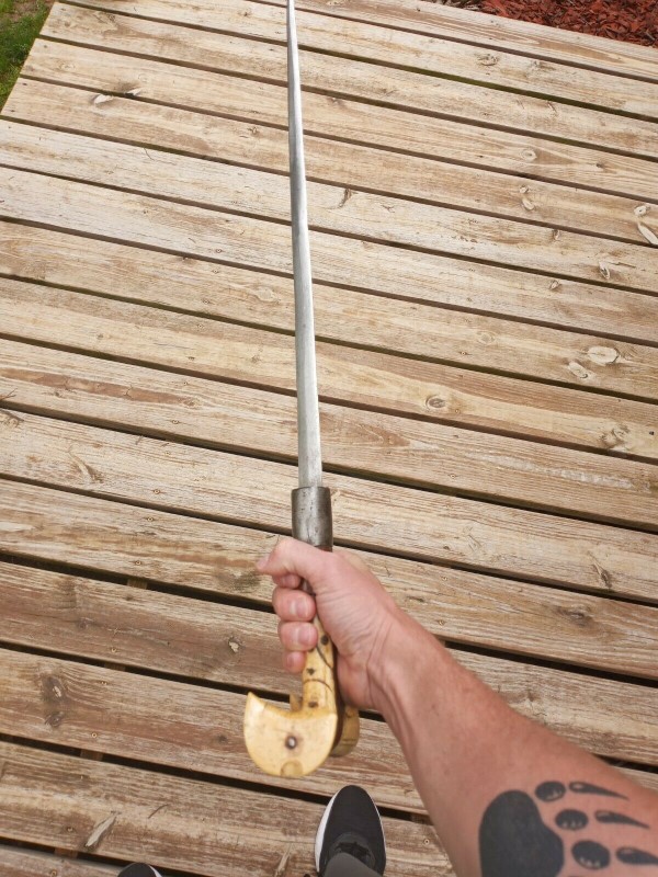

Hi all, long-time-no-post! I suppose like a lot of people that frequent this forum, I have plenty of topics that I want to ask/comment about as a posts, but very little time to sit down and type up such things. Introductions aside, I was motivated by the unique & pretty clear history of this item to sit down and post about it!
I just got this off of ebay earlier this week by the way, so the pics I'm sharing are just from the seller, but according to USPS it should be here tomorrow! Fingers crossed a truck doesn't accidentally sit on it or something lol.
Anyways, what I have here is clearly a sword stick with handle scales transposed onto it from an archetypical, large-eared yataghan! To me the most logical story here is that it's some kind of bring back/trophy, either from actual combat or (I suppose more likely) from some kind of exploitative tourism or colonialism. This then to me seems like it would be a rather cool heirloom piece - the valuable, identifiable handle scales passed on to a style of sword more owner-friendly, long after the blade was deemed obsolete. Or, perhaps less romantically, stripped soullessly from the original piece, put on a more "refined" and "eloquent" style of weapon. Either way, a very cool juxtaposition of cultures and martial traditions. One further origin that's possible is that the whole piece is natively made; perhaps the native turkish owner of the original yataghan wanted this sword stick to be fashioned for it, keeping the scales, and reformatting it as a more western, then-socially acceptable style of sword, allowing them to be able to carry their ancestry about in public without scrutiny. Either way, somehow it got to Ohio, and will soon be in Minnesota lol.
I have yet to memorize the attributions for different yataghan styles, but I believe ears of this kind were just found on straight turkish-made examples right? Not greek or balkan? Also are the handle scales a discernible kind of ivory? I know walrus was quite auspicious but idk if elephant is the more likely material.
Also also I'm no expert on sword sticks, so if this one belongs to any identifiable style please let me know that too. That's actually part of the reason why I'm sharing it here, as the whole item is rather out of my area of expertise.
To be honest, part of the reason why I bought it in the first place was just because I liked the contrast between the wood, ivory, and metal fittings. I've always wanted a large-eared yataghan, but as a college student I've never had the money saved up for one, so this is a welcome alternative.
Finally, speaking on the materials, I'll post more close up pics of everything once I get it, but I'd be interested in conserving pretty much every aspect of this sword, so if someone could give me advice here or in private it would be much appreciated. There are some gaps/cracks in the wood and also quite clearly some kind of epoxy was used to fill several chips between one of the handle scales and the rest of the grip, so any advice on how I could remove that and at least replace it with a slightly less blatant repair would be similarly appreciated.

This is a very interesting piece and I must confess I have never seen anything like it.
The hilt may be some kind of ivory (walrus ivory?) but we will need better photos to make an educated guess.
However, characteristic for a yataghan is not only the eared hilt but also the recurved blade with a single cutting edge on the interior. To the extreme, the blade can be straight, but it still has to maintain the general shape with a single cutting edge.
In this case, the blade appears to be a multi-faceted rod with no edge and a pointy tip, more like a stiletto. That's why I wouldn't call this a yataghan but a "sword-stick with yataghan hilt."
Regarding the attribution, for yataghans it is generally very difficult to pinpoint to a geographical area because within the Ottoman Empire skills and smiths traveled freely. Sometimes, for some particular pieces the geographical location can be pinpointed accurately, but this is generally if the yataghan has some revealing text or some characteristic style/decorations, which isn't the case here. Moreover, in this case the only clearly recognizable Ottoman feature are the scales, while all the rest appears quite European.
So, the eared scales could have been taken from an older yataghan and mounted on an European blade simply for their exotic appearance, since the mounting style is quite different from the Ottoman style and looks very European.

Even I would call it, sword-stick with yataghan grips.
I saw several sword-sticks with nimcha type hilts. I don't think the blade is European. Please send us good photos of the scabbard, stick and the blade. The grips are, of course, from the Balkans, but the sword stick might be North African.

Update: it arrived this morning! I have to run some errands today however so I probably won't be able to take, let alone post, images until the early evening. Initial impressions though are that it's quite nice! It's definitely not a super professionally made piece (i.e. made by a super skilled artisan), but I very much like how rugged & functional it feels, outside of the fragile handle lol.
Overall length is 38.5 inches, blade length is 18.5 inches, handle 8 inches including the ear protrusions, with the scales themselves taking about 4.5 inches of the total hilt length (the part of the hilt you can actually hold is 5 inches).
Everything is surprisingly solid, and the only movement is in the metal collar that connects the handle to the scabbard. There have clearly been numerous repairs to the wood and ivory over the years, as you guys will see once I post pics. The blade is of an elongated diamond shape, tapering steadily to the tip. The edges are indeed blunt but the tip is still very pointy and interestingly there's a section of the blade close to the guard that actually was beveled and sharpened at one point, perhaps for utilitarian purposes. The scales now appear to me to be clearly walrus ivory, as there are sections that feature that characteristic warbled texture

I very much agree with Marius' well described observations, especially with the fact that like many ethnographic weapons, regional classification of 'yataghans' is often difficult. As noted the larger 'eared' examples are typically regarded as Balkan, and within the Ottoman Empire. With those two very broad denominators, it is often hard to define more specific attribution.
