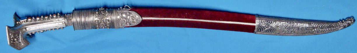

Greetings folks!
I got this yataghan in horrible condition (but I could afford it for the first time) to replace the one that was stolen from me years ago.

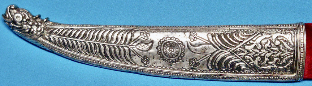

Here are pictures of my restoration attempt. Lots of hard work and the learning curve was a sheer cliff! I had to teach myself how to do Turkish silver filigree (which is not on Youtube nor is anyone teaching it ). It was a lot of trial and error (more error) and I had to create my own techniques. I also restored the wood scabbard top and the leather with velvet. Finally I had to re-inlay the missing brass on both sides of the blade and I had to do a little grinding and polishing to get rid of the areas of the blade that were beaten up. This took me 8 months.

These are the main sections (circled in yellow) that I made from scratch:

More pictures:

Finally here is the inscription that needs to be translated.
Yes the blade is laminiated. And yes that is a tugra, but of which sultan?

Well, the top part of the silver work I used patterned wire, wire I triple twisted myself, and used sheet silver underneath.
Regarding the bottom of the filigree section, well, I used sheet silver and soldered pattern wire on top. When it comes to the silver pieces, I had to make those from scratch. Let me explain. I had to make different sizes of individual little silver balls. Then I had to make twisted silver wire rings of different sizes. The diamond shaped silver pieces I cut from silver sheet. Taking square wire and twisted wire I made and soldered the "petals" of the large flowers and then the balls and wire rings on top. I also soldered the rings onto the sheet then placed the other components on top. In honesty, I did use some balled beads and some pre-twisted wire rings in some parts, but the majority I had to make by hand.
The big catch to this work, besides patience and time to make every single component (with a couple of exceptions), is making sure that the components are completely soldered without melting the pieces, or melting holes into the sheet beneath. So the right heat and type of flame applied is crucial. And finally the type of solder is important too.
TVV - you are right. I did a lot of research not only in style of Balkan (Focha Bosnia to be specific) but also in comparing Russian, Yemeni, and Mexican filigree work. Yemeni was the closest, but no one is demonstrating, instructing, or showing how to do Turkish (or traditional Bosnian) filigree work. So I had to also create my own techniques.
Bob A - you are right in that I also took this as an opportunity to learn to make filigree, something I had no idea how to do originally.
I always want to increase and improve my skills. Now I may add filigree jewelry to my sales. Nice since I also taught myself chasing, repousse, soldering, wood carving, and metal inlaying into steel.
Thank you folks!
Is there anyone who can translate the inlay inscription?

Your silver-working skills are just getting better. I would like to ask you about a feature that you did not have to replicate but is interesting to me technically. Attached is a copy of one of your pics that shows (*) two strips of what appear to be made of plaited silver wires/thin silver strips. Have you done anything like this yourself?
Also, on the inlaid sections of the blade, I can see small "knicks" in the base metal which seem to hold the inlaid metal in place. Were these features present in the original blade, or are these part of your inlay technique? I don't recall seeing them on Ottoman pieces before.

Regarding the "nicks" in the inlay - that's original. With my techniques I don't do that. However, I have seen this on different Ottoman and other Middle Eastern inlaid blades before. It is the method of striking hard when engraving, especially when making curves with a big chisel. These are the hammer strikes as the large chisel digs into the blade. Then with the inlaying of softer metal, the softer metal fills into the hammer/chisel marks. I guess this method can have the effect of keeping the inlay more stable by gripping it better. This is my guess anyway, though not my method.
Asomotif: Inlay is not that easy. Looks and sounds simple but it is not. Many times one would only make the grooves and then inlay, but what you talked about will happen or they pop out. There is a whole process and many tricks that would take too long to explain here. I have been doing this for years after lots of research and study. Even some Philippine swords with original inlay had the inlay pop out. I have had to improve and modify techniques to where now I can't even get my own inlay out (accidentally inlaid a blade with some bright brass instead of silver ). So don't be down on yourself - sounds easy but I garantee you it is NOT! BTW - don't use brass if the original is in gold - brass is stiffer and much much harder to work than gold (as well as being harder than sterling). Only thing harder than brass inlay is steel inlay!
NOTE: some little tiny areas of inlay I did not attempt in fear that I would dislodge the rest of the original inlay - something that can happen easily (and does if not careful - I know from experience )
