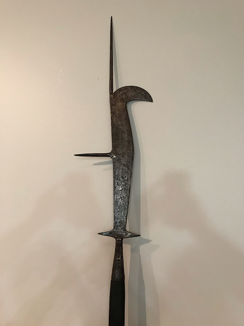

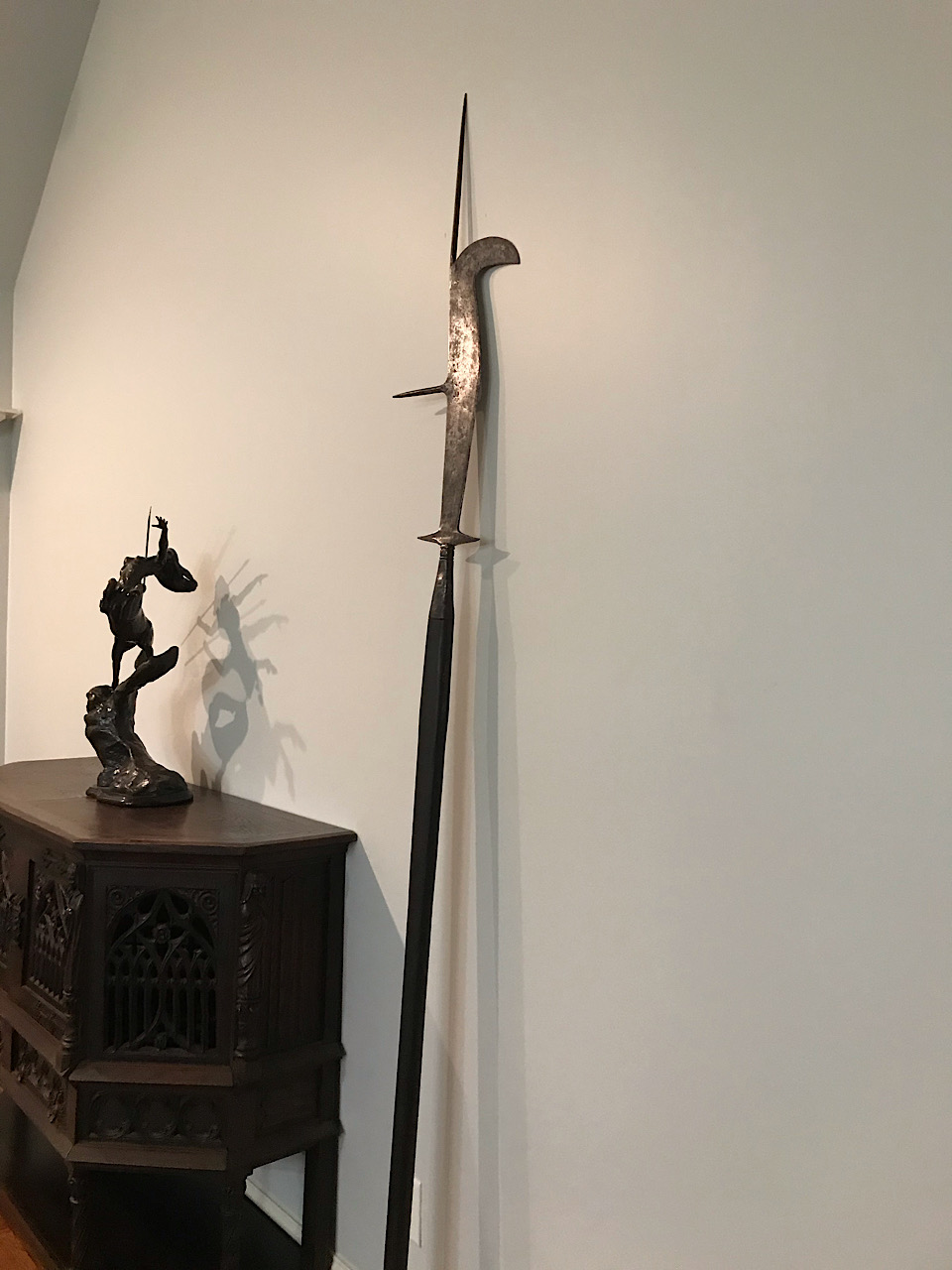

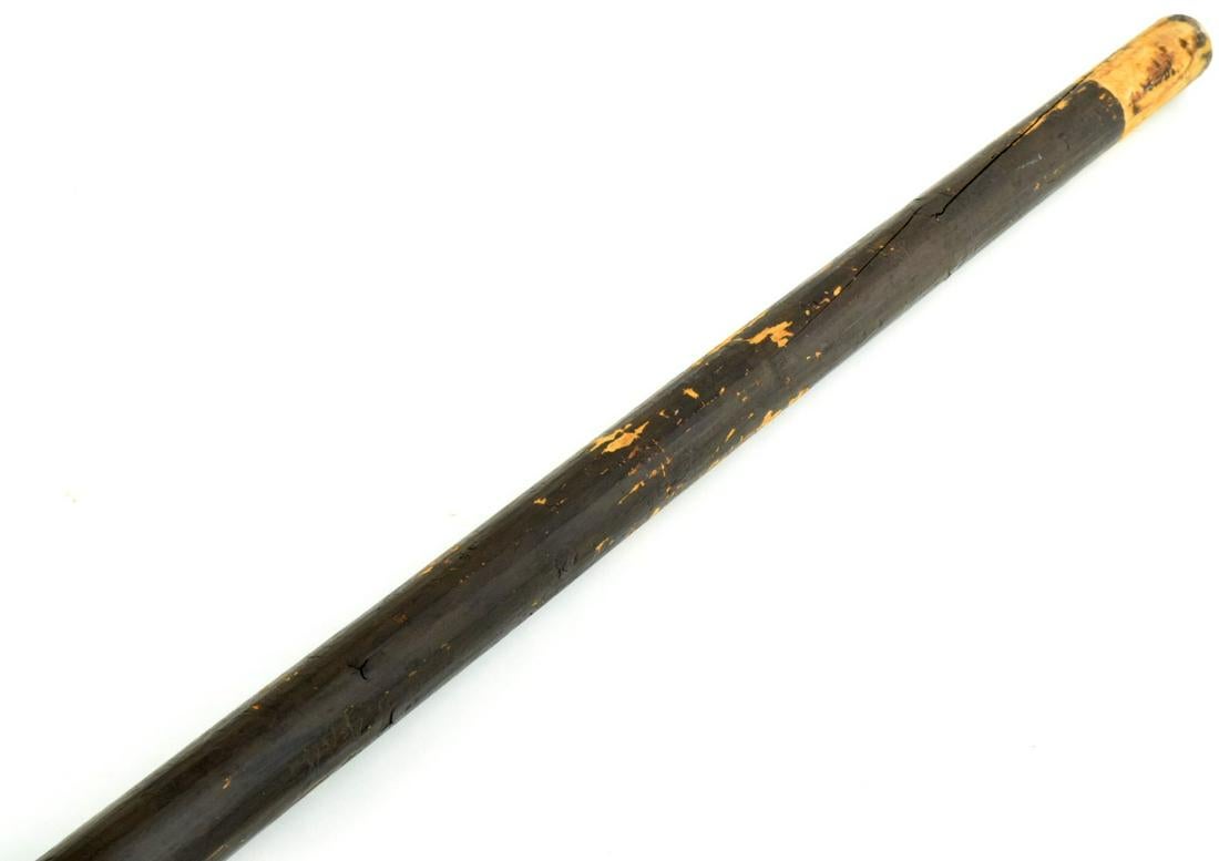

I am trying to find more information on the lance in the attached photo. It was reportedly acquired via de-accession from the Metropolitan Museum of Art in 1972 and it is pictured in George Cameron Stone’s “A Glossary of the Construction, Decoration and Use of Arms and Armor“ on page 500. (I misplaced my book and ordered a new copy.). It was reportedly from Stone’s collection.
Does anyone have any information, particularly photos of other examples, that even remotely resemble this type? I have never seen the side-mounted blades before.
It will likely be several weeks before the lance is in my possession.

Well, I got to my 'Stone' finally and had been barking up the wrong tree entirely as Stone (p.500) shows this among 'pikes', which have nothing to do with lances or Polish hussars. These are of course infantry weapons, but do have basic similarities to many lances of course in that it is a pointed spear head attached to a haft or pole, usually using the langets extending down to attach with screws.
I have not seen those side 'wings' nor the curious hooks on the shaft on anything, and I have gone through every weapons and arms & armor reference I can think of. While lances were indeed used in Eastern Europe long after they had fallen out of use in the west, the Polish hussar lances were hollowed fir halves glued together a ball type vamplate mid shaft, looking mostly like medieval tilting lances.
There is the possibility this is a boar hunting spear, which often have 'wings' to prevent the prey from coming up the shaft, though these elongated side 'blades' seem contrary to the extended wings typically seen.
Whatever it is, it is certainly 'one of a kind' and having something of Stone's, one of the pillars of arms & armor scholarship, is outstanding!!!

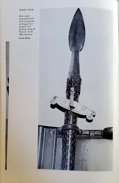

Jim, your suggestion is food for thought but this weapon does not fit the functional criteria exhibited by every boar spear that I have seen in person or in the literature. The head on this example is much less substantial than the norm, keeping in mind that a boar spear is designed to deal with a thick-skinned animal with a low center of gravity, consisting of several hundred pounds of muscle and bad temper that power a set of tusks that will disembowel any man, horse, or dog that gets close enough. The long blades on either side of the shaft don't do much good because the spear head, properly designed, is what does the job. The wool tassels are superfluous. A simple cross-piece (either forged integral with the socket as common in southern Europe, or a piece of antler or iron lashed or riveted to the shaft below the head in the German lands) suffices as a limit to excessive penetration.
Here are two "classic" examples of boar spear of a style common to the German-speaking countries, with antler-tip crosspieces lashed on with rawhide. The leaf-shaped blade on the left is a variation encountered in other northern and eastern European countries as well.
