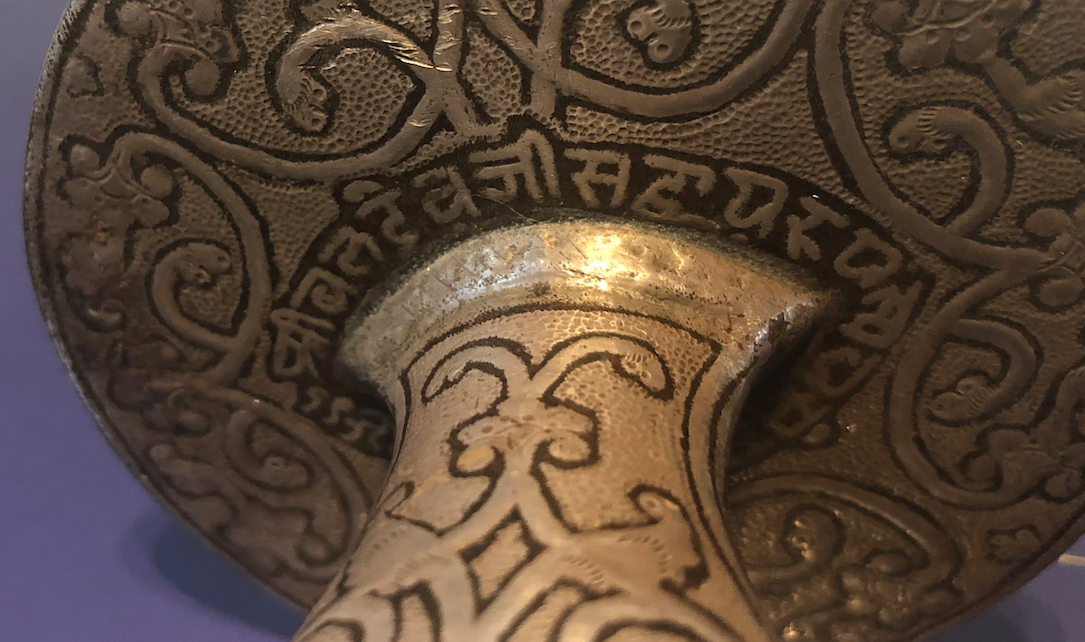

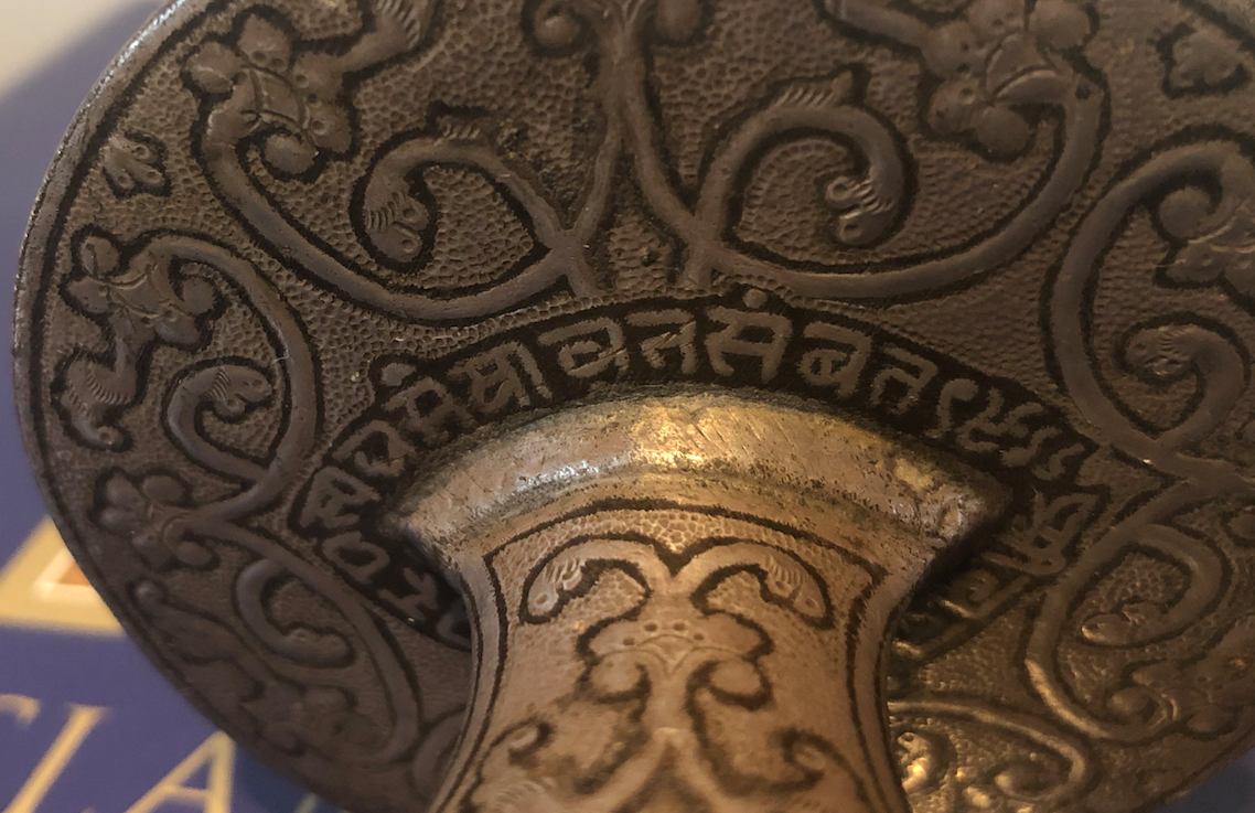

hello forum members.
I need your assistance in deciphering this inscription, which I believe is devanagari. I have picked out a few words such as 'sri baldev ji sahai' and 'samvat'.
Is anyone able to assist with this? much appreciated! images are attached. there seems to be some date at the end? especially since 'samvat' is written before it...

A friend in India has helped with translating the text.
Shri Baldevji Sahay Rup Singh Sangawat Samb(v)at 1911.
Shri Baldevji is the Deva to whom obseience is paid. Rup Singh is obviously the ownern of the piece who belongs to the Sangawat Rajput clan. Samvat is V.S. the Northern Hindu year.
The year looks crudely done (maybe a local variant of numerals) VS 1911 So this is around 1855 AD.
I have a tulwar from Alwar/Ulwar with a closely related text dated VS 1856 - 1799-1800 AD.

thats fantastic Jen! Might you know who Rup Singh Sangawat is? I also noticed 'sri baldevji sahay' is on a shield at the V&A which belonged to ram singh of kotah. So maybe its 'region'/rajput specific?

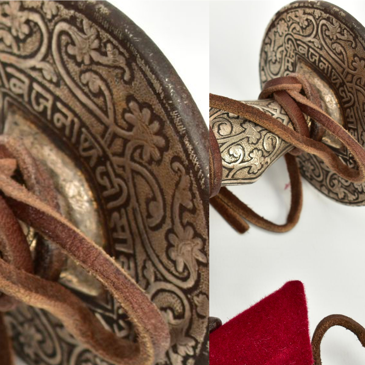

I'm afraid it doesn't matter. I don't think this sword belonged to him. There are handles that are very simply decorated, with poorly made inscriptions often with errors and missing characters. Such inscriptions always start with "Shri Baldev Ji Sahai" but what's next doesn't matter.
In the best case it is possible that such swords belonged to the rajah's servants or officers.

Surely there are very poorly made hilts with spurious inscriptions, but this one looks very well made... at least from the photos we have.
So this definitely doesn't look like a servant sword hilt.

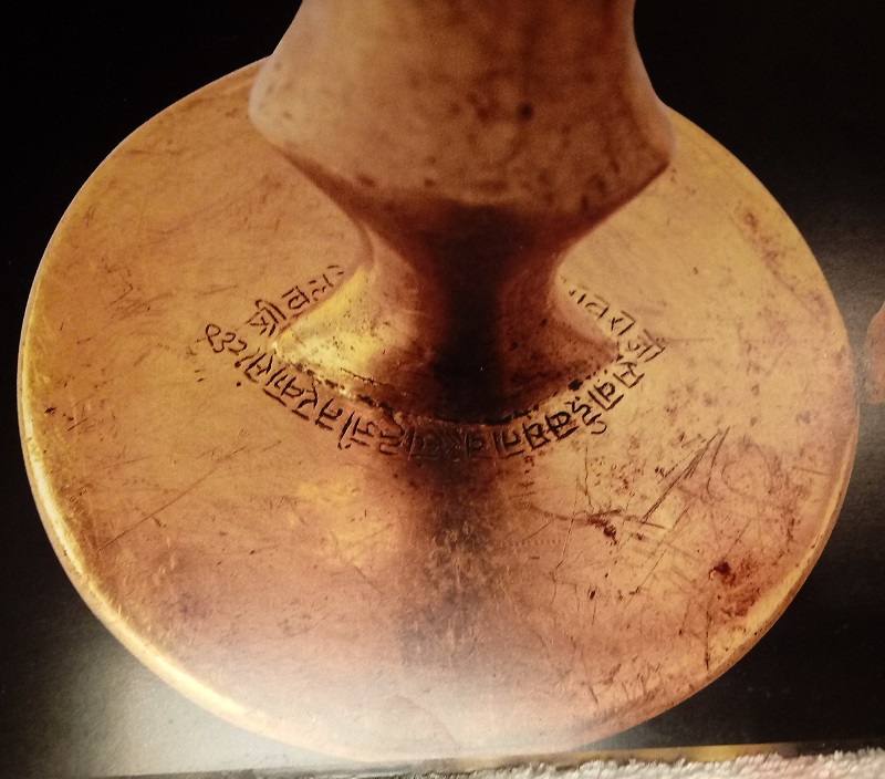

Surely there are very poorly made hits with spurious inscriptions, but this one looks very well made... at least from the photos we have.
In the case of the "owner's inscription" exactly in this place of hilt I only trust in such a sword of raja and an inscription (attached). I am talking about swords of 19th - 20th, when, apparently, such a fashion appeared. In Gold we trust.
Jens' translation clearly states that the sword DID NOT belong to Shri Baldevji.
See:
"Shri Baldevji Sahay Rup Singh Sangawat Samb(v)at 1911.
Shri Baldevji is the Deva to whom obseience is paid. Rup Singh is obviously the ownern of the piece who belongs to the Sangawat Rajput clan."

Ariel, thanks for responding. I really went deep into the study of the religious culture of India, but I am still far from looking for the sword of Shri Baldev Ji.
I just wanted to point out that we need to be careful with such inscriptions on the hilt.
