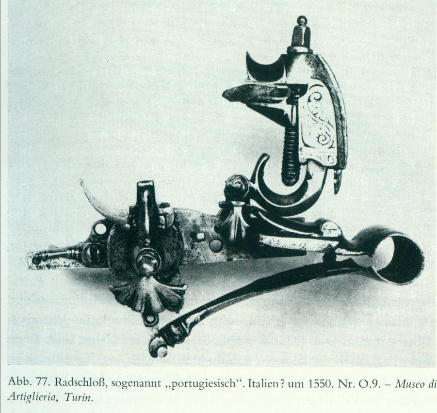

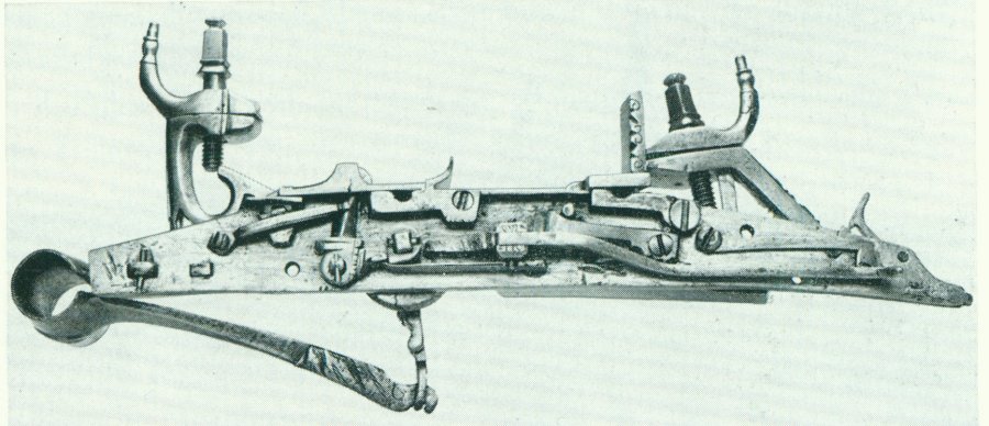

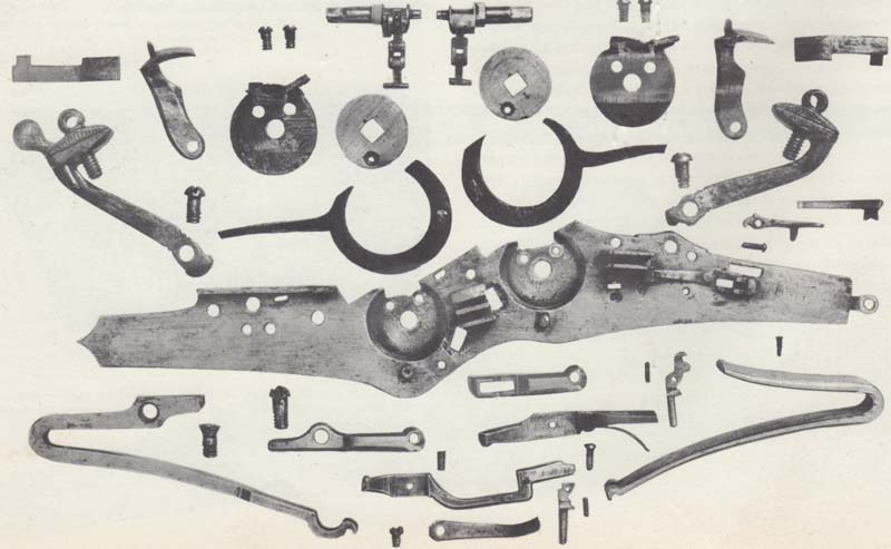

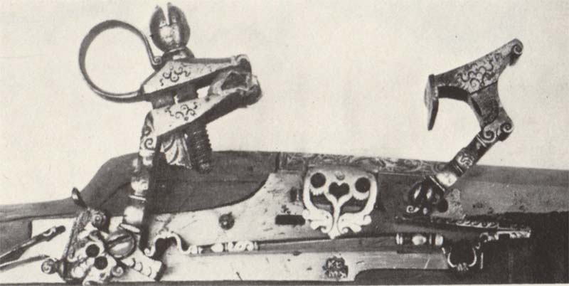

Brilliant! Thanks for that Fernando. I hoped somewhere their would be an internal detail of the Turin double lock . I am re posting it here because I think it makes sense in the thread. The long locking bar for the wheelock wheel with no secondary prop looks like an interim stage in the evolution of the idea . It does have some other interesting features. The pancover appears to be pushed open not , as one would expect by a cam on the wheelshaft but by a spring which is released by the cam on the end of the wheelshaft. Which again suggests an early stage in the development of an idea . However I cant immediately see how the trigger mechanism for the snaplock is supposed to work . Any ideas ?
I am also re posting a second Wheelock from the same museum because technically and stylistically it is very similar . Also note again the distinctive style of the cock screw and the matching square headed bolt on cock pivot. The suggested date for this is 1550. If the Turin double lock is of a similar date then this ought to make this earliest known example of a snaplock with a combined steel and pancover .

Hello :
I hope that the translations do not betray me
Regarding the key (lock ) twice , the fact that the heads of some screws be square has no significance : the key also has ordinary screws. Even the flintlock has (I see ) rake screw ( Frizen ) with his square head .
Regarding the absence of first detent is a result of elongation of the plate ( plate) is needed and act with the pawl from far back . Even the hole in the wheel should be flat rather than tapered , so that the end of the latch , driven by its spring , remaining there until he was introduced to fire . Just different , that cam cubrecazoleta ( COVERPAN ) is not driven by the crankshaft of the wheel, but by the guarantor.
Regarding the comparison with the key ( lock) Portuguese , this has all the characteristics of a late model the cubrecazoleta is driven by the crankshaft and even has a spring that keeps it permanently closed
Regarding the trigger system of the flintlock , any review would not be more than a fiction , without seeing the original weapon . Calamandrei , in his book " Acciarin nei tempi " ( Keys ( locks ) in time) imagines a trigger button, which goes outside the plate ( plate) . For me, the two holes below correspond to cock a spring which kept the hook (dog ) away from the rooster ( cock )

Hullo Fernando. Thank you for helping to keep this thread alive.
I’m sorry your comments didn’t translate very well, and if I have misinterpreted them apologies. I will try and answer them as clearly as I can.
Bolts rather than screws. –" Of no significance."
If we see similar stylistic or technical features (the bolts) that are shared by other locks it is reasonable to suggest that they might form a group, and that they might belong to the same geographic area or be of similar date. If these locks also have some early features and we don’t see the bolts on later locks it is reasonable to suggest these bolts might be a characteristic to some early locks that was later abandoned. Unless we are prepared to make these kind of comparisons we couldn’t research or try to date anything.
The wheel release mechanism with no prop. "Just different."
Sorry. No. The second prop is a fundamental stage in the development of Wheelock design and seems to happen quite early. It was found; probably through bitter experience that the single locking bar, (which was occasionally simply a flat spring) could, if the nose of the sear was worn, or more likely the hole in the wheel was blocked with dirt, appear to lock the wheel, but in reality it was just hanging on the edge of the hole. Thus a knock could dislodge it and the gun would fire by accident. The second prop ensures that the wheel will only ‘ lock off ‘ when the sear fully enters the hole in the wheel. Its perfectly reasonable to conclude that wheelock’s with a single locking bar are, at least in evolutionary terms, earlier than those with the double locking system because experience had shown this system was in practice unsafe.
The pan cover opening mechanism.
I’m not sure what your point is. All I can say is that I haven’t seen a similar system before but if someone else has it would be nice to know. It seemed reasonable to suggest that this slightly convoluted arrangement might be an early stage in trying to work out the best way to open a sliding pan cover
The Portuguese lock "has the characteristics of a late model."
I don’t know anything about Portuguese locks. Are you saying the date 1550 is wrong? I thought there was a suggestion that it might be of Italian manufacture? I assume it has a one piece hooked type combined arm and flash pan cover as seen on some early German wheelock’s prior to the introduction of the sliding pan cover. This is shown in the dismantled wheelock attached; German C 1540. (The Met; New York) Notice also that despite its early date it does have a secondary prop for the wheel-locking bar.
The release mechanism for the flintlock.
There seem to be some missing bits in this area. The pivot for the cock looks inadequate. One would expect it to be supported by a bridle as in an aqujeta and I assumed that was what the holes were for. Its difficult to imagine how a spring to release the dog catch (as on the aqujeta) might work as the hook on the catch doesn’t seem big enough to hold.

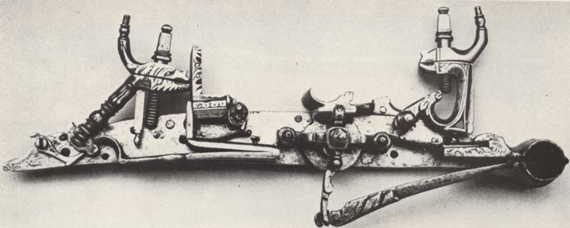

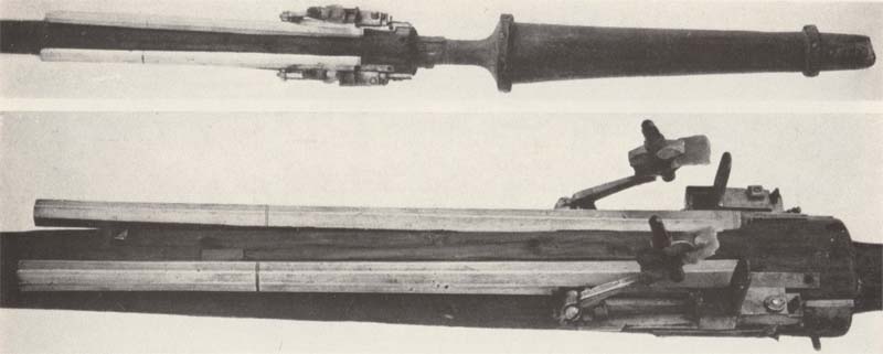

Hullo again Fernando . Just found this image in an old post of yours . It looks relevant so I am re posting it . You obviously know about Portuguese firearms so where in the sixteenth century would you place it ? The stock looks early
and the lock has some similarities with the Spanish aqujeta but with an internal mainspring . Since it hasn't got a half cock dog do you think it has an additional separate flashpan cover?

Hello, Raf.
No. This is a key (lock) called "molinhas todays date". The average riding (half cock) is achieved with the piece that sees before the cat foot) cock) moving manually to engage the tooth can also be seen in the front of the foot cat (cock). In turn, to reach its maximum position (full cock) a projecting part of the shoe (cock) on the bottom hook removed in (dog) and keeps out the tooth. It is a variant of the mediterranean keys.
http://www.invaluable.com/auction-lo...pistol-carbine
Fernando K

Hullo Fernando. Interesting . Does the release sear work directly on the cock or on the tumbler ? Does it move horizontally or vertically and is their a second locking prop ?
Old 6th December 2013, 06:04 PM   #16
Fernando K
Join Date: Apr 2010
Posts: 672
Hello, Raf:
The sear (sear) acts on walnut (tumbler) horizontally with two sureties, primary and secondary.
There is also an evolution, which is named key (cock) half "of molinhas fecho" half and key (lock) means "French", with walnut (tumbler) and sear (sear) vertical, and the key to the French spark.

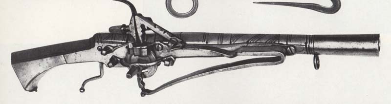

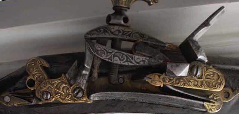

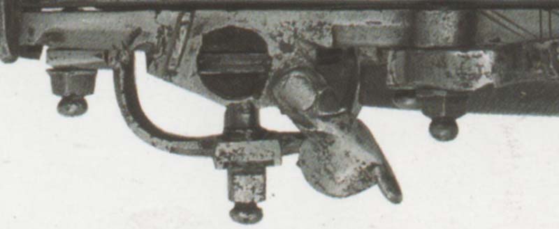

Continuing the theme of early snap locks with combined steel and pan cover. This Spanish combination weapon has slideing steels and pancover. Royal Armoury, Madrid, C 1580. Any comments ?
Old 14th December 2013, 09:20 PM   #19
Fernando K
Join Date: Apr 2010
Posts: 672
Dear Raf:
Yes, of course. This is the key (lock) described by LAVIN, on page 157 of his work. This is a spear with two pistols, listed as I.20 in the Royal Armoury, Madrid. For the description I refer to LAVIN. I think it's one of the first copies to "pin", which is also found in some coils on the keys (lock) wick (matchlock).
An additional fact: I went to the Director of the Royal Armouries, to ask alfuna photography, but I replied that the two keys (lock), had been stolen, and the theft was discovered in 1950, when the last inventory uMake
Affectionately. Fernando

Thanks Fernando . I think I got some of that... I don't suppose you know of any better photos of the lock ? Do you know if the sliding pan cover is attatched to an arm as on a wheelock or something different ? What advantages do you think it might have had (if any ) over a conventional hinged pan and steel ?
Old 14th December 2013, 10:54 PM   #21
Fernando K
Join Date: Apr 2010
Posts: 672
Dear Raf
Like I said, I tried to get a picture, straight from the Real Armeria, but the keys (lock) have been stolen.
I think the bowl (pan) is sliding, and no cam, and has at the bottom a device that ensures slip instead. It has, yes, an arm that pushes the bowl (pan) in the closed position which is driven by the weaker arm spring When the foot cat (cock) hits on the rake (Frizen) overcomes the force of the arm driven by the weaker spring branch and open the bowl (pan).
Affectionately. Fernando K

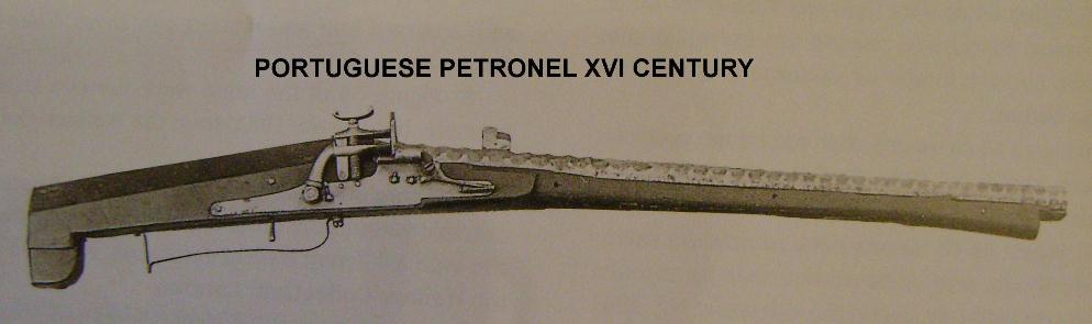

Hi Raf
You must have noticed by now that there are two Fernandos going on; the one that knows a significant lot about locks and has been replying to your questions is Fernando K; the one who has posted the petronel picture (and not only) is Fernando (no K), who knows extremely less about the subject.
Perhaps you like to have a look at this link; it will possibly complement the answers to some of your questions about these Portuguese locks:
http://www.vikingsword.com/vb/showth...light=molinhas
And by the way ... the petronel you have asked for the precise date in this post, was made in the Lisbon Arsenal circa 1560 -1580.

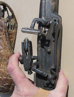

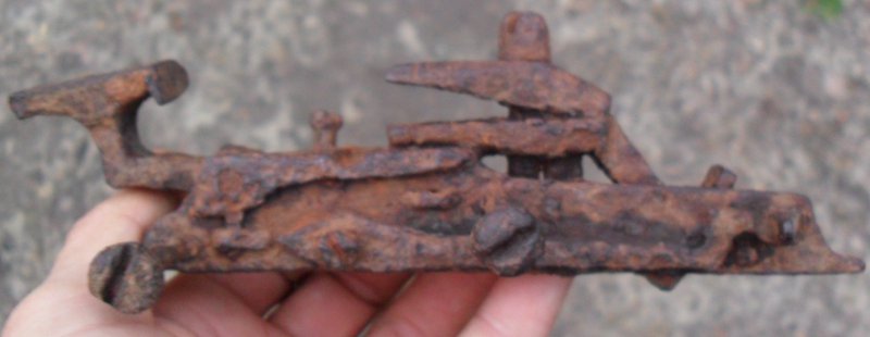

In pursuit of the earliest ( or in this case worse ) snaplock here is a Mongolian version. The trigger release is breathtaking in its elegant simplicity...
Also interesting is the lack of a frizen spring and no evidence that one was ever fitted at least to this gun. Which suggest what I suspected; that early snaplocks may have relied simply on the inertia of a relatively heavy steel creating enough resistance to create a spark. Difficult to argue that something like this could not have been knocked up by any blacksmith sometime in the fifteenth century...
Old 16th December 2013, 06:16 PM   #27
Fernando K
Join Date: Apr 2010
Posts: 672
Hello, Raf:
I think the key (lock) has broken the shortest branch mainspring: the square hole in the plate (plate) seems to prove it. Also that the bowl (pan) in the ball and seems to be drawing the battery dock.
I think any key (lock) could depend on the inertia of a rake (Frizen) heavy, without spring, because any sudden movement would that moved out of position. There is, in any museum or collection, a gun (or its remnants) with this feature.

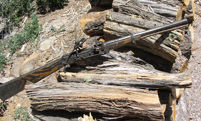

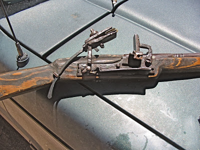

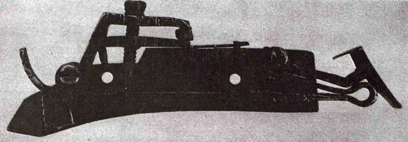

Hi, Raf
There are a number of extremely primitive snaplock guns kicking around the States, having been brought back by American servicemen during the Vietnam War. Smallbore, pistol grip stock not fitted for ramrod, and a very rudimentary flint mechanism with external mainspring and no screw-tightened jaws for the flint which was apparently lashed in place with rawhide or the like. THESE LOCKS OFTEN LACK A FRIZZEN SPRING AS WELL.
The guns do not even belong to the Vietnamese culture-sphere, they are aboriginal artifacts associated with the diverse tribes of the Annam/Lao/Cambodia highlands.
As re your comment about the inertia of a heavy frizzen, my examination of a good number of these guns indicates that the steel is not especially massive, and is a rather loose fit on its pivot. But apparently, these things worked! Unfortunately I do not have a photo handy at moment, if I do locate an image, will post it here.

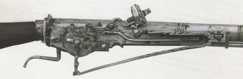

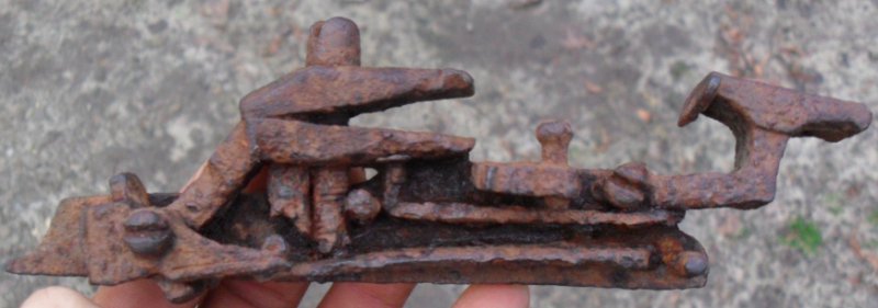

Reposted here is an excavated Russian snaplock originally posted by Evegeny. K . Evidence for the possible early evolution of these primitive locks will have to wait until one turns up in an establishable archaeological context.
