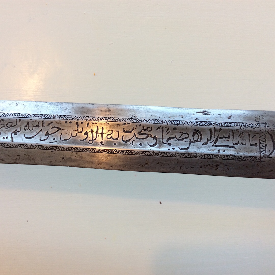

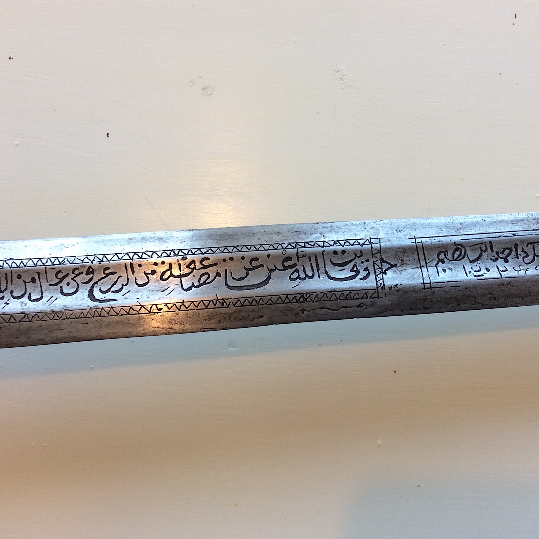

Was hoping someone might be able to translate the inscription that is found on both sides of the blade of this Kaskara. Many thanks in advance for the assistance. I have a couple of pictures of each side in case one is better/easier to view.

Thank you and I agree on both points. I am hopeful someone will be able to offer some translation assistance because this inscription is much better than typically found.

It’s inscribed with verses from al-Busiri‘s Qasidat al-Burda (Ode of the Mantle), a poem in praise of the Prophet, popular all over the Islamic world.
There‘s the name of the maker too, though your photos don‘t show the whole of that part of the inscription. It ends with “... Ibrahim Ahmad” followed by what looks like the date 1202/1787-8, though this isn’t very clearly written and that would be a very early for a piece of this type I gather

This is not a very idiomatic translation, but the verses from al-Burda roughly say:
“God’s protection has no need of reinforced armour or high fortresses.
Whenever time tried to harm me and I sought refuge in Him, I received shelter from Him that could not be harmed.”

Thank you very much for the translation. The blade may very well, in addition to the inscription, be 18th century. While rare, it is not out of the realm of possibility. The poem is really nice. I have added pictures of the missing area in the holes the name is more visible but wasn’t sure which end of the inscription so have pictures of all 4. Thanks very much for the translation and having an additional look at these, hopefully, better pictures of the missing portion.
I wish to have it in my collection too
I agree with Kwiatek the date is too early for a sword of this type.
It's not the date of the sword but rather a commemorative date, please look at this forum you will see other examples with commemorative dates...
