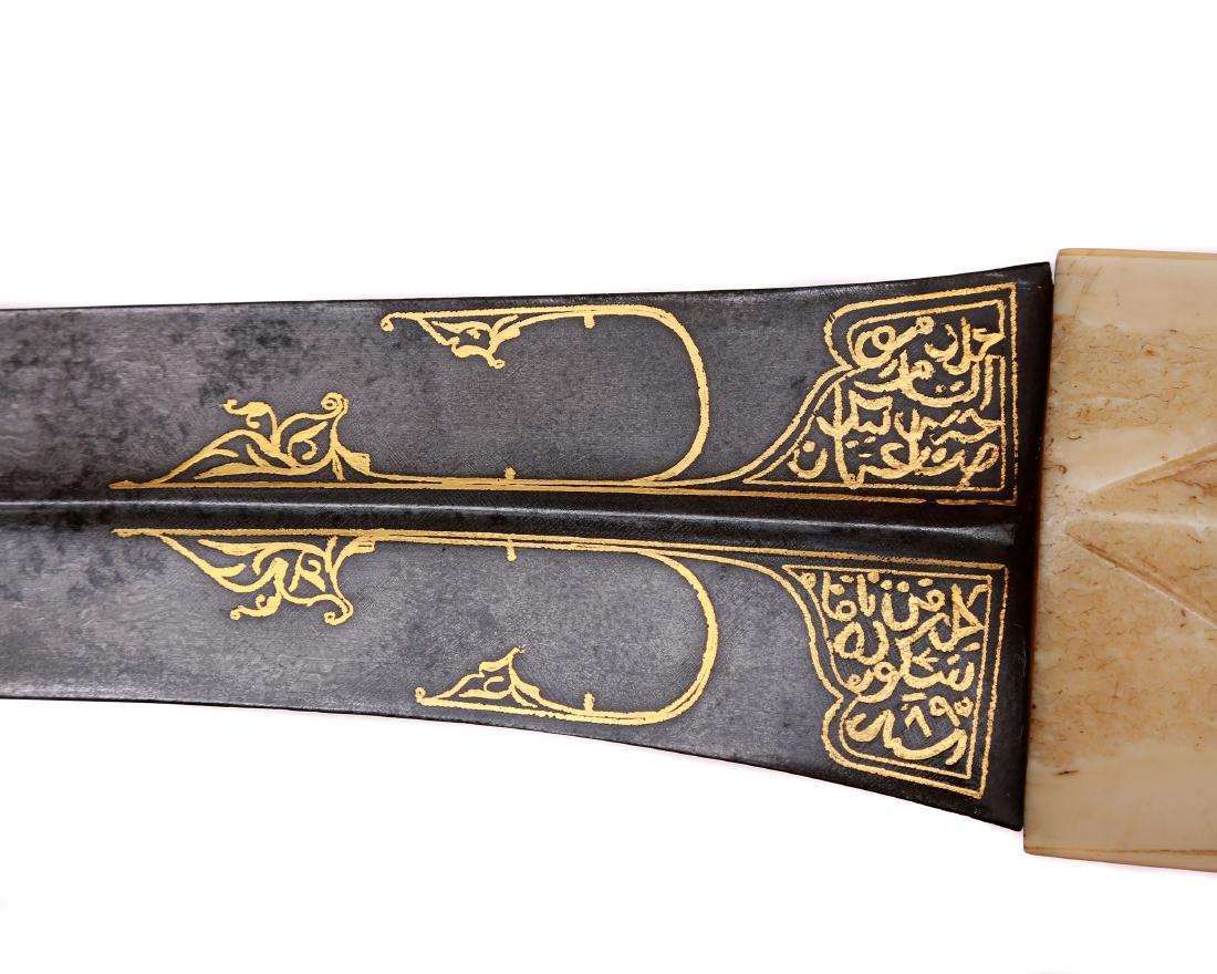

I think it can only be [1]295 even if it doesn’t look like a 2
The upper cartouche reads
عمل دمشق الشام صاحبه عثمان بيك
"Work of Damascus, Syria. It’s owner is Osman Bey.”
The lower one with the year is an Arabic saying, I’ll see if I can work it out

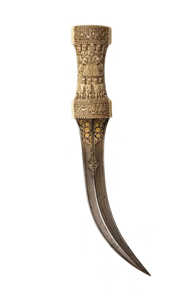

On second thoughts, I would like to add that these daggers are very similar to the Persian khanjars and have absolutely no correspondence in any early Balcanic weaponry.
So I think the attribution of these daggers to the Balkans is completely wrong, like the attribution to the so called ottoman "court daggers"... for example (that in Turkey are called Kama - see the fragment of a photo from the Istanbul Military Museum - pointing out clearly to their Persian/Caucasian origin).

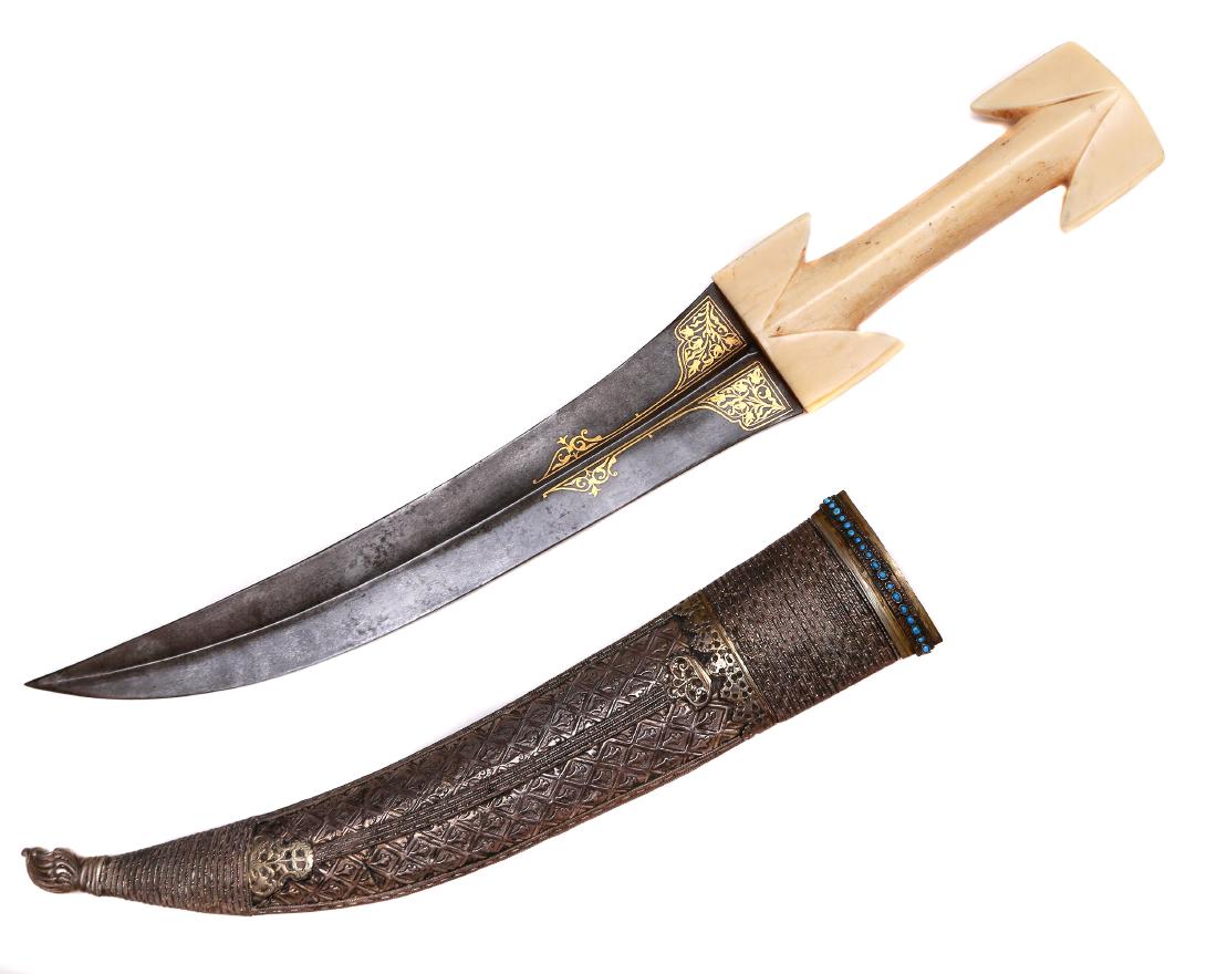

I fully agree!
Well court daggers with straigth blades were Bosnians, on your photo its an old Turkish dagger and the kama is a kind of kindjal if i'm not mistaken... So we are talking about 3 different things...

It does not really look like a 1 or a 2, but it must be surely meant to be one or the other. I would go with whatever stylistically fits the piece best, but I can see already that that is contentious.
It’s likely to indeed be a date as the word underneath appears to be سنة meaning ‘year’

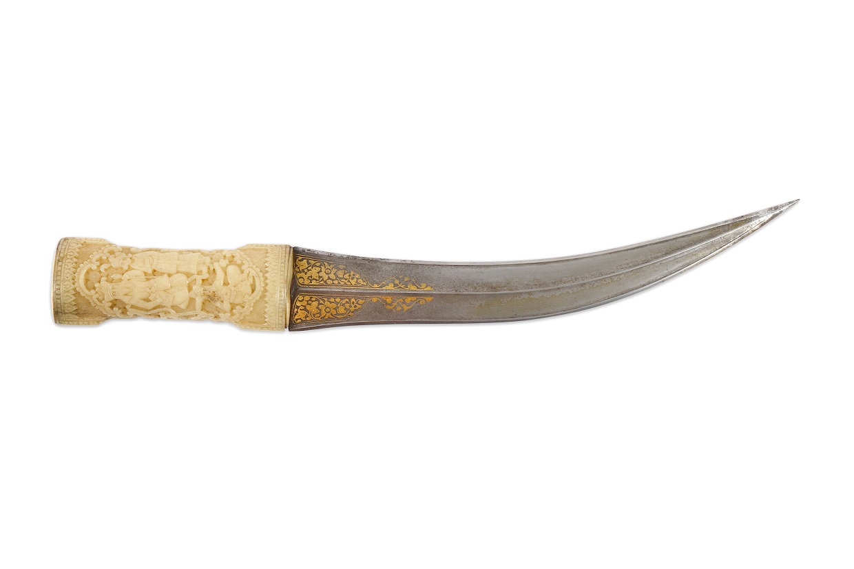

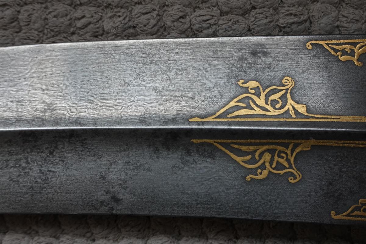

The fact remains that most people think that this type of dagger is Albanian, but we already know that some, like yours, were not made in Albania.
Another problem is that this type of dagger, as well as good Kurdish daggers and some Iraqi daggers have wootz blades of this style, which is NOT Persian of the same period (late Qajar) of good+ quality. All of those are attributed to the 19th century. This is in disagreement with the notion that wootz production has stopped is Southern India in early 19th c and was non-existent or forgotten in all other areas.
To sum it up: very nice dagger , very rare to find provenance on such daggers, therefore extra special. For the rest, it is all open.
PRECISELY! Now, as much as I would like to disagree, I simply cannot find anything in your comment to nit pick and have to agree with everything you said... but...
... there is always a but...
Just because "most people think that this type of dagger is Albanian" does make it necessarily true?!
Also, stylistically they don't have almost anything Albanian or as a matter of fact from the Balkans... (yet they have very much Persian influence in shape, decoration an script).
So... citing from guess who...
... "just want to cast doubt on some conventional notions that have little evidence in support and to demonstrate the problem of" Albanian identity.
Moreover, as you said, many of them are sporting nice wootz blades which are NOT known to be the work of any Albanian smiths as wootz production was pretty much restricted to India and Middle East...
... and, again as you said, they are NOT the high contrast Persian wootz, nor the finer patterned Indian Wootz but a lower contrast wootz of uncertain origin... that happens to be very common in some Turkish blades.
see another example of such lower contrast wootz at the link below
http://www.vikingsword.com/vb/showthread.php?t=25477
Now, how many examples of such daggers do we have with certain (not anecdotal) Albanian origin?!
And even if production of wootz has stopped in India in early 19th century, does it mean it stopped everywhere... at precisely the same time?!
Or the disappearance of wootz production stretched over more decades as old wootz ingots were still abundantly available, and there was a pretty large pool of old wootz blades that could be reworked.
PS: Even if they didn't know to produce new Valyrian steel anymore, they were still capable to rework old blades... right?!
Yes Marius we are on the same page.
As I wrote "These daggers were very popular with Albanian mercenaries Bashi Bazouk. You can see many paintings and engravings with them carrying these daggers".
But I don't recall any book saying that these daggers are Albanians. I think it's a collectors / dealers thing only...
I disagree with you about the script and decorations, they are Turkish Ottoman.
Last but not least I have no idea about the blade, yes you are right it looks like a Persian blade with a central ridge but then what about jambiya are they also Persian?

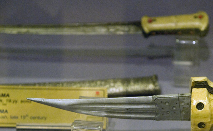

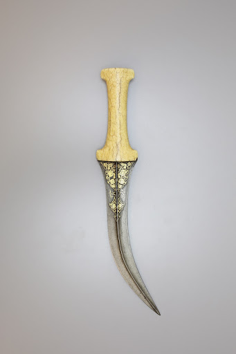

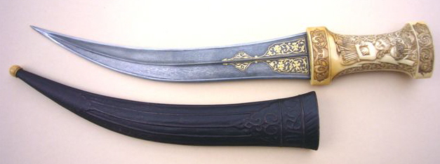

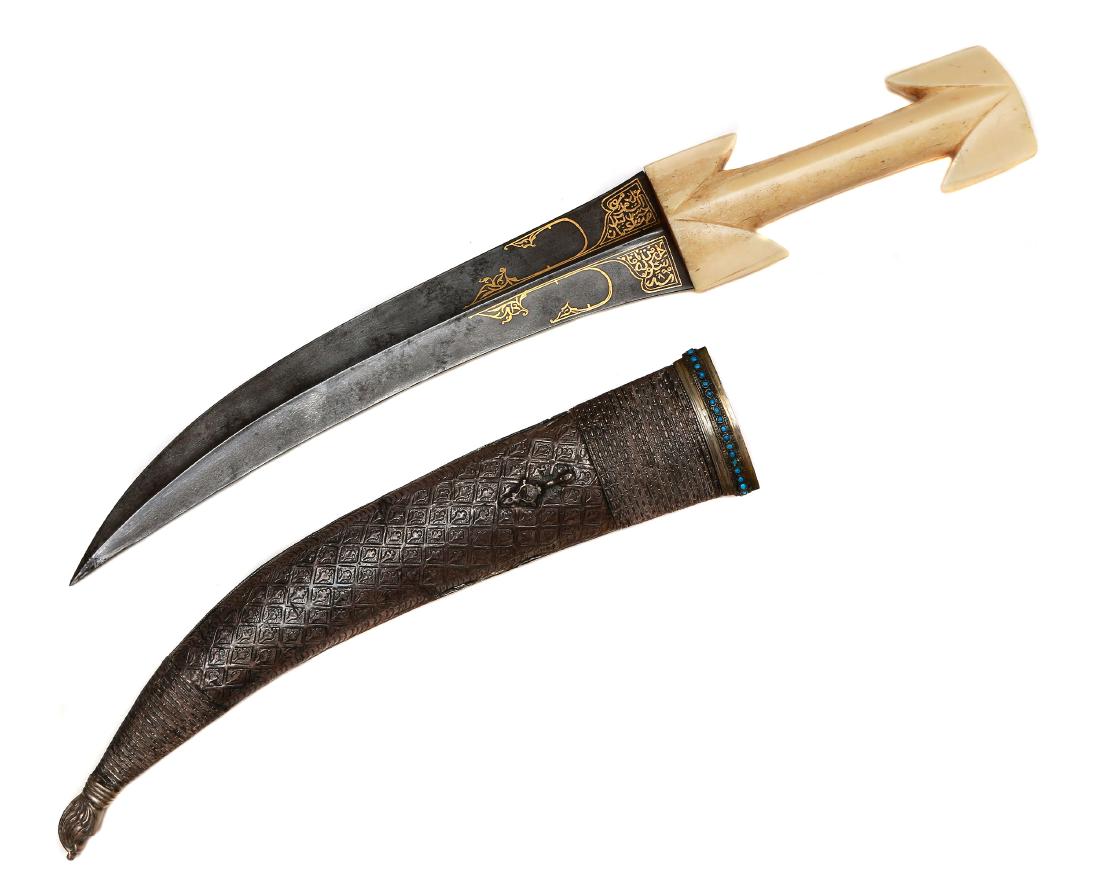

I have a blade like that but i don't think these blades are similar to your Syrian piece.
Old 18th March 2020, 12:59 AM   #29
mariusgmioc
mariusgmioc's Avatar
Join Date: Sep 2014
Location: Austria
Posts: 1,918
It depends how do you look at them.
They all have strongly curved blades with central rib.
They all have similar koftgari, in terms of geometry and style.
They all have similar I-shaped ivory hilts...
... so they are similar.
Mine is much larger and has a broader blade.
Mine has on one side some writing.
Mine has a hilt with some strangely oriented protrusions...
... so they are different.
Take your pick!

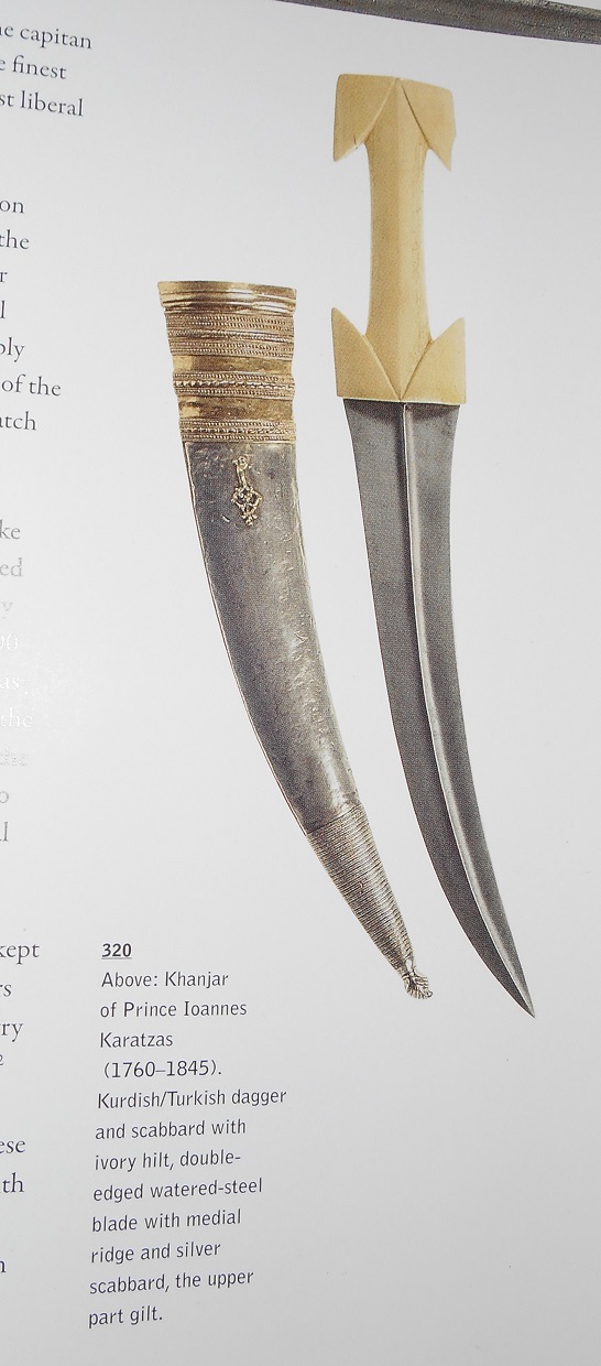

In his book Elgood said Kurdish/Turkish dagger...
By the way, not all the weapons in his book are from the Balkans nor Greeks...
