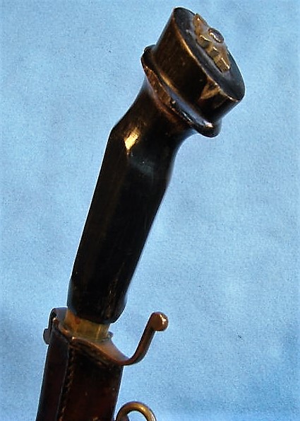

I bought this because it was a bargain, and in such good shape. I recognized it as Filipino, but admittedly know nothing more about it. I am only recently starting to study N. Filipino blades.
So, with that, I'd appreciate any info on this sword.
Dimensions:
Overall length: 23.25in.
Blade length: 17in.
Blade's widest point: 1.75in.

Hi Charles:
I believe that the hilt is Ilokano work in that it is a horse hoof shape with a prominent groove below the "hoof." Ilokano hilts frequently have a notch or groove in this position, where the little finger rests comfortably. It is seen with many of their hilt styles, which are quite numerous and have been described here previously.
The brass (?) ferrule is also consistent with Ilokano work. The bulge in the grip adjacent to the ferrule is something I associate with Central Luzon/Pampanga (see, for example, many of the Apalit knives that have also been described here). Putting all that together, I think this was made in the area from Pampanga up to Pangasinan by local crafstmen who were either Ilokano or strongly influenced by Ilokano styles. The same area was responsible for many of the "Negrito" bolos, which can be used to define many of the Ilokano traits in knifemaking (as discussed here).

Hi Charles,
Hard to say the age because it has been worked on a bit judging from the cleaned blade and the shiny leather sheath--all in good condition. I would say probably pre-WW II, but not as early as the revolutionary war. So first half of the 20th C. would be my guess.
The local name for this one would probably be sinan paddak based on the horse hoof hilt.
Ian.

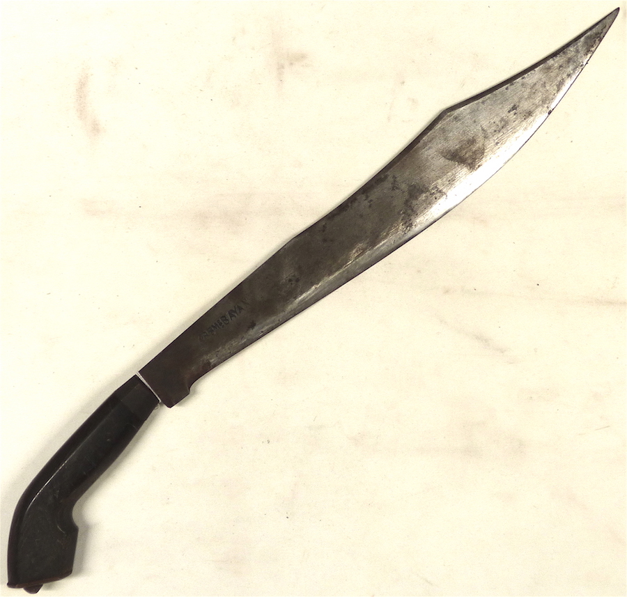

Sorry for necro-ing- but consistent to my quest to give due credit to Southern Luzon blades, I would like to assert that this is a Taal-made blade, as evidenced by the following:
1. Scabbard pattern
2. Horsehoof- type hilt consistent of other providenced Taal blades
3. Blade profile classified in Taal as 'kinampit' (not to be mistaken with the 'kinampit' profile of Panay, Visayas blades).
I'll provide samples to prove points 1 & 2.
MPM is a Taal maker who signed his blades, along with another maker known as JC. As you can clearly see from one of the pictures, MPM placed TAAL below his initials.

Here is a JC.

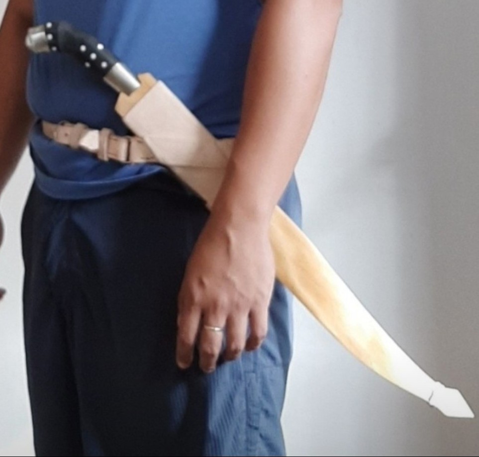

I've come across blades with scabbards like this but never known how they were worn. Can you clarify that?
Peter

pbleed, I have no idea right now- but I have blades with that kind of scabbard too, strange that I've never tried them on...will update you once I"ve worn them
I think I've seen a photo, maybe from Batangas?, of someone wearing a something like this with the "belt" diagonally across the chest, from one shoulder to the opposite hip, like a messenger bag. I can't find it right now but I think he was pictured with a pile of coconuts. This might explain the way the belt goes diagonally across the sheath.
I'll see if I can find it.
Thanks,
Leif

Hallo Leif, here. I'm wearing a modern Southern Luzon trad blade, from Laguna, that's a province near Batangas. Same scabbard tieup style

I posted an old stereo picture a while ago of coconut workers in Laguna Province. Their bolos are quite well depicted, and the sheaths have a simple arrangement for suspension, with the belt angled across the sheath. Those pictures are here.

Yup, thanks for the pic! Same way that I'm wearing it. It must be a Tagalog thing, that suspension type.

Xasterix, could you put a name to this blade pattern if you know it; and could you guess at the approximate age?
I gather that JC is not making bladed weapons now?
Thank you.
Thank you.
Hi Rick, from a Taal/Batangas perspective, they called that 'kinampit' as per a 1917 reference. It's confusing because there's also a 'kinampit' blade profile in Panay, Visayas.
But from a modern Laguna perspective, they call that blade profile 'uhas tari.' The latter name (uhas tari) has different blade profiles depending on the area. But from what I've gathered, the profile originated from Bicol region.

I forgot to give an age estimate. Preww2 I think. 1930s, possibly earlier
