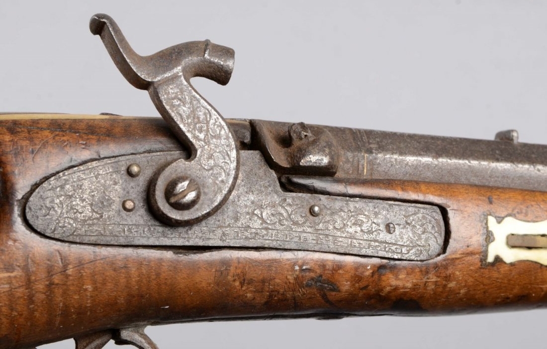

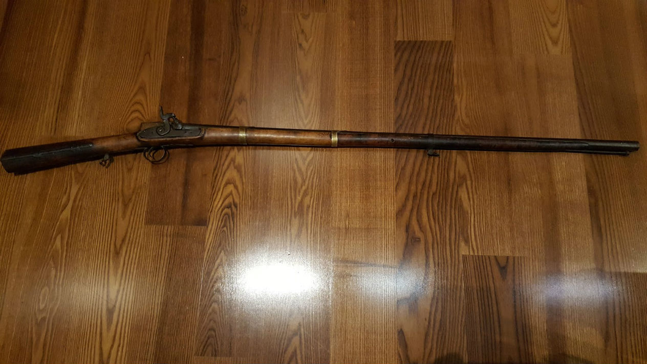

I bought this Persian percussion smooth bore, long gun at auction, it was wrongly described as being Caucasian and the stock had a noticeable crack or splice separation. I asked around in order to find someone who could repair the stock and I decided to contact Philip Tom as his work was highly recommended to me by a forum member I greatly respect.
Philip did a fantastic job, and fortunately the stock was just separated at a joint were two pieces had been spliced together. Persian guns are rather rare, in my opinion possibly due to the Persians early adoption of European firearms and this gun seems to be a very late model, possibly from the last phase of traditional Persian guns. I am really happy with the results, I have no plans to fire it and wanted as little work done on it as possible.
In Philip's words before repair....."there is one oblique crack crossing the point where the sling slot is. Disassembly will be needed to see if there are any related problems inside, and also need to see if I have to address any losses along the edge. I would need the whole gun to work on since the barrel has to be kept in place for proper alignment. The lock is a civilian version, possibly Eastern-made, of a mid-19th cent. Enfield percussion regulation pattern. The main difference being stylistic, a flat surfaced hammer, and a slightly different profile just on the front end of the plate."
After repair.
"As you can see from the differences in grain, this wasn't so much a stress break, but a separation of a diagonal joint in a two-piece stock. When scraping off the crud, there were traces of the original organic glue under the newer clear adhesive of the later amateur repair. The saw cuts on the mating surface weren't perfectly smooth so I had to dig the old stuff out of the crevices to make sure my repair had 100% contact.
The inlaid bone sling escutcheons have these pieces of brass inlaid in them, these are not original and were probably put in by the guy who did the last repair. Rawhide thongs once went through these, which were knotted through holes at the end of the wider leather belt that served as a sling. I decided to leave the brass in, even though not original, because taking them out might open another can of worms as far as stability of the inlays. If it can be done cheaply, a local gunsmith can install a bead type brass shotgun sight in the hole in the barrel. That's what it had originally since the barrel is off an English sporting gun.

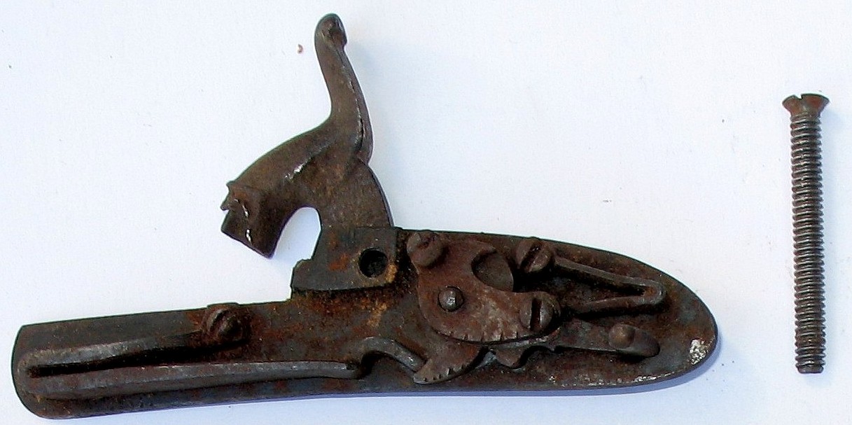

Mechanical repair to the firing mechanism isn't any priority since you're not planning to shoot this. The percussion nipple is all munged up and needs to be drilled out and replaced with a new one -- too much money and the new nipple is going to stick out like a sore thumb. The gun looks great as is in an ethnographic collection. As you probably know, the style of stock inlay and the overall quality mark it as being a provincial piece, from one of the tribal areas, probably from southeast Iran since the decor is reminiscent of the circular motifs on the grips of chooras and other daggers from Afghanistan and the Sind."

Great stock repair! The hammer is out of alignment from viewing the damage to it. It is not aligned or is wobbly. Hammers can be removed and bent slightly to align them with the nipple. This hammer could be welded to replace the loss and then the depression milled out. Probably seen too much dry firing by previous owners.
It's a good looking piece and worth the effort.
You can add a front bead then use a wire brush and bluing on it to help age it.

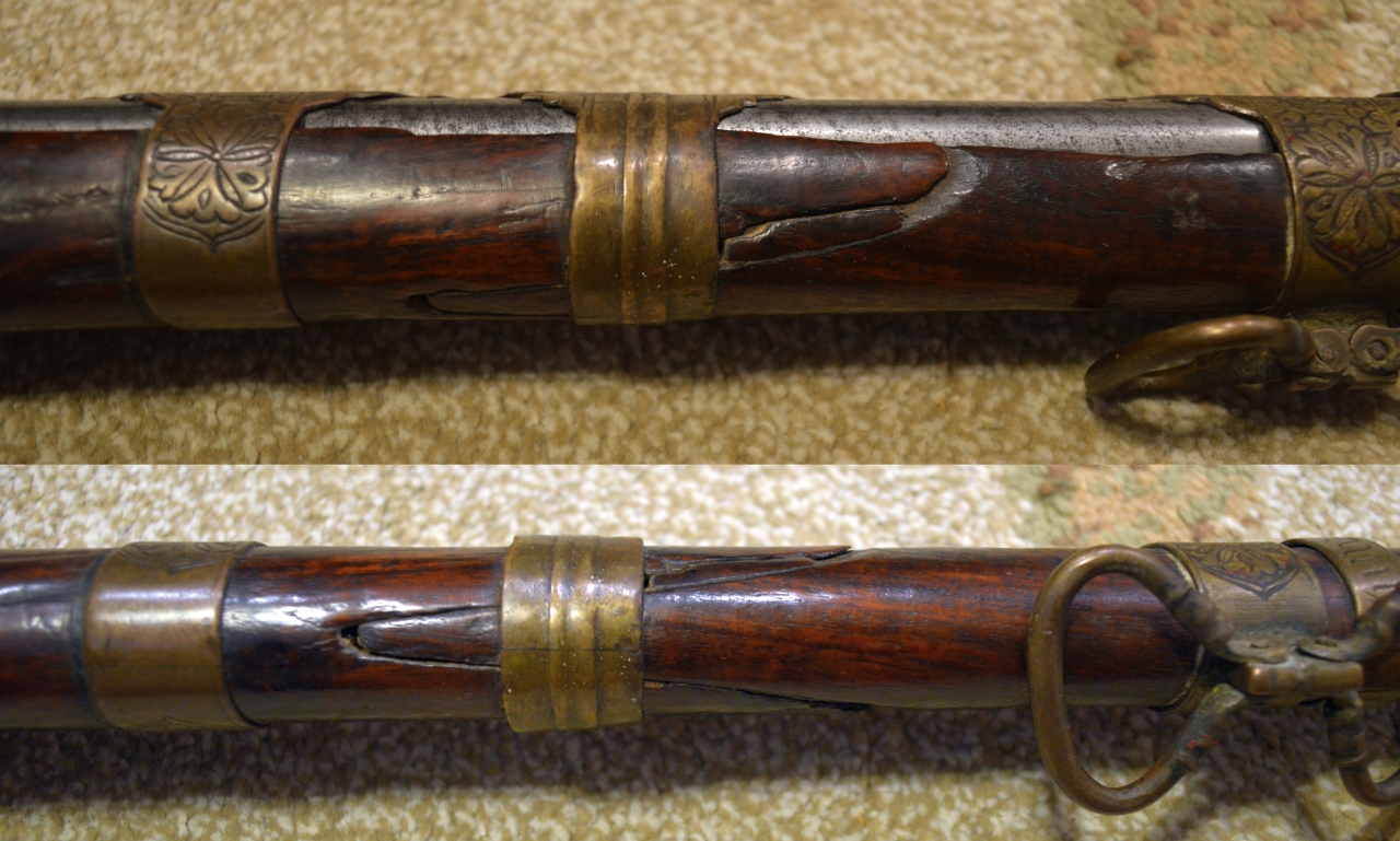

For comparison, here is a very similar stock break in my Caucasian rifle. I had hoped the repair would have turned out a bit better on mine. But that's just the way it had to be in this case.

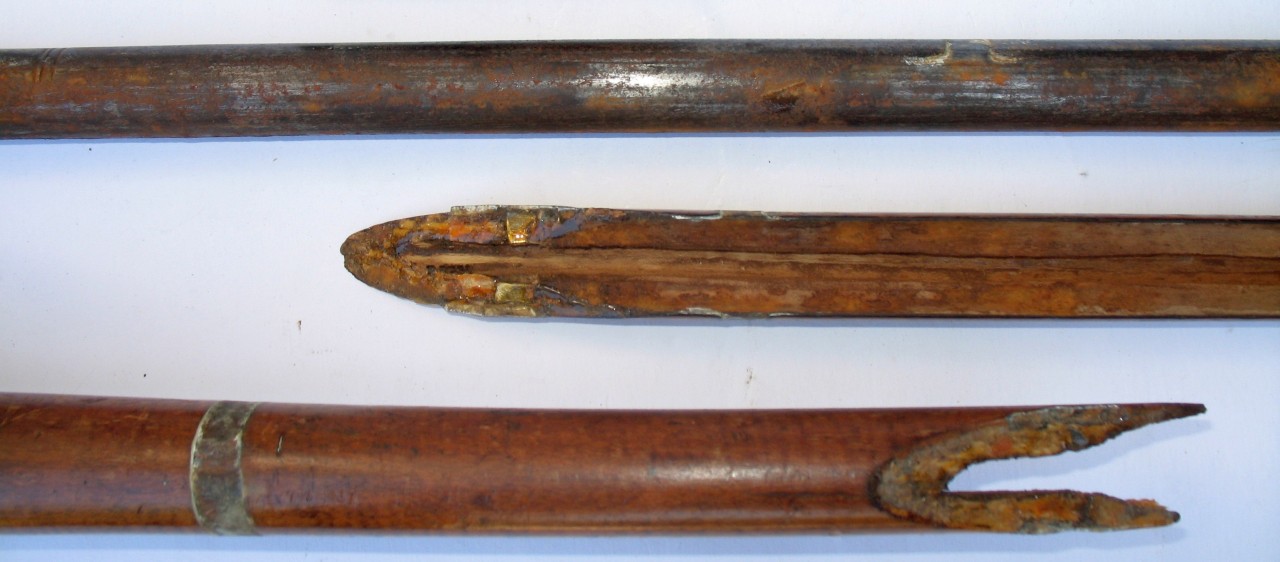

I'm not sure these are 'breaks' as such, but rather a form of scarf joint that has come apart.

I agree, Richard. The stocks were made in two pieces, the original glue joints just happened to separate at some time in the past. This sort of joint, somewhere along the forestock, is common on many types of Eastern guns. You see it on Indian toreadors on occasion. Persian and Caucasian gunmakers liked to use fiddleback-grain woods. and apparently had trouble finding single pieces long enough for a one-piece stock. I once had a very fine Caucasian smothbore gun, this was a class act with really good damascus barrel and a Persian-made miquelet rivalling European locks in fit and finish. But the maker had to make the stock out of 3 pieces, he was obviously cherry-picking to maximize the grain contrast from end to end. Unfortunately I sold the piece years ago and didn't save any images. What's nice is that Caucasian long guns tend to have wide silver sleeves as barrel-bands, and proper positioning of these can really give the impression that you're looking at a single piece of wood unless you examine closely and see a bit of the joint, or the unavoidable slight mismatch in grain.
Rick its not bad really, I have seen much worse, in my case there was an inlay that had to be worked around.

I'm sure Richard and Philip are correct. They do indeed look more like a splice that came unglued. Glue does age.
In my case, a novice had attempted to glue the two pieces back together (using white Elmers glue or some such). Not only did it look horrible, they glued it together WITH THE ORIGINAL WOOD RAMROD STILL IN PLACE !! Took the gunsmith a whole day to get it apart. @#$%^&*

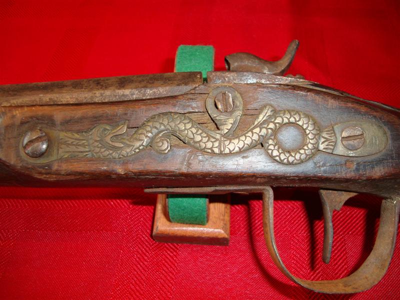

In your case, it is rather curious that the original maker installed an inlay so close to the spliced area. Also, is that a barrel wedge in both those slots ? Usually these would be left open to tie a leather sling through. The barrel bands holding the barrel in place.

These are not barrel wedges, just pieces of brass stuck in there probably by the guy who first tried to reglue the stock. The barrel is not fitted with tenons that would retain any wedged. The only attachment are the tang screw and the bands.

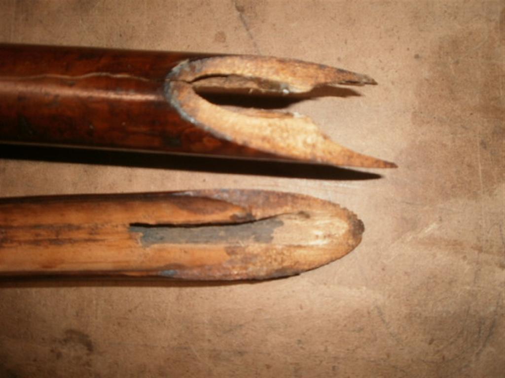

Sind percussion long gun, 63 inches, converted from matchlock. This has two stock splices, they do not appear to have been glued at all, how common was this, I have seen this before on Indian matchlocks.

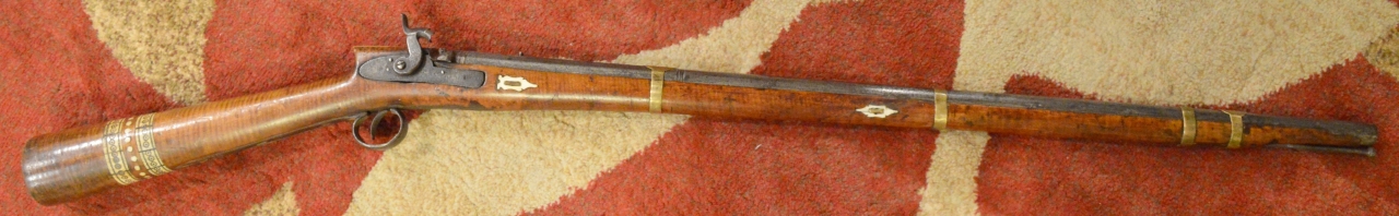

Adding another persian rifle here. Similar connection of two pieces of wood. A little bit different rifle butt.

I have seen Western percussion muskets with a two piece stock as well, though they had a very well fitted mortise and tenon join rather than a V splice. Anything beyond the forward hand grip point contributes nothing to the structural integrity of the piece anyway.

This Sind also has a spliced stock, but only one splice, and never glued by the look of it.Simply held by the bands.

Yes, spliced stocks not glued seems very common in Eastern arms.
The only concern is that they don't come apart with recoil, so have to be banded pretty tightly.

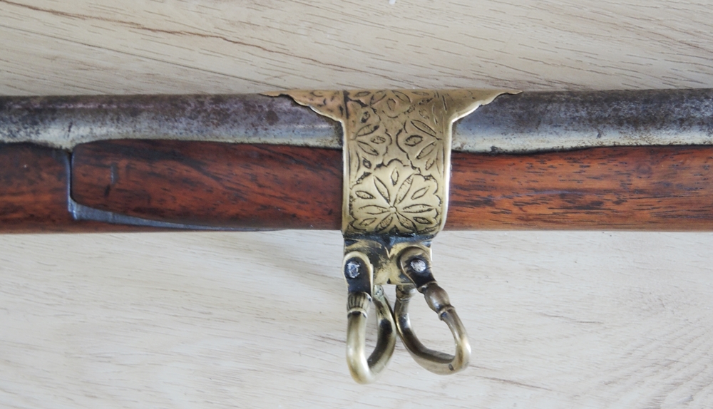

Another feature I've noticed on Sindh guns are the sling swivels. Instead of two single swivels, there are two pairs (4) as shown above. Every Sindh gun I can recall seeing has this feature. Although mine has the twin swivels on the rear, and a fancy knotted leather fastening on the fore stock.

Very curious as to WHY the spliced stocks? Looking at the wide butt on the last one posted, it appears not to be wood source related. If you recall, Japanese arms are routinely spiced in the wide butt as their native sourced woods were not plentiful enough to field all the 1,000s of full-size butt stocks needed. So they economized; makes sense.
And as Dave points out, any part of the forend is just be carried along with the barrel. So if not a ‘wood source/length’ reason, perhaps it was done just to economize on the wood they did have available?
FYI, of the 2 Eastern arms I have, both have spliced forends, but one appears free of any animal/hide glue, where the other clearly separated (due to age).
