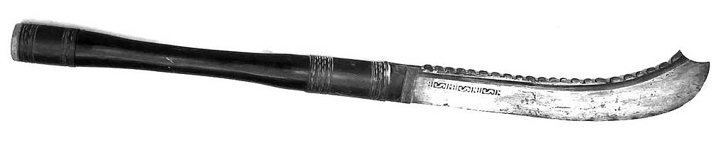

Acquired this one today, Cham Tun from the Meitei people of Manipuri, an older and sharp version of the ones in the linked vides below.
53 cm. LOA, steel with wood haft wrapped in brass wire, brass disk om the pommel.

The ChamTun (spear-knnife) is home.
Excellent item. Grip including the bolster is 30 cm., hair under a foot. about an inch or 2.5 cm. dia. at the ends tapering down to about 3/4, 19mm in. for about 3 in., 7.5 cm. of the centre part.
Blade is 9in./23 cm. Fullered both sides, inscription only on one side. 1 1/4in. wide at the bolster, hair over 1.5 near the tip, 3mm thick at the spine. The spine decorations are very well done. Cleaned some grime off with a plastic scrubber. It's laminated steel! Linear pattern.
'Habaki' style Bolster is steel. Looks like a fancy khukuri bolster
It has not been wound with brass wire as i thought, there are 2 decorated brass sleeves, one 2 3/8",6 cm. long just behind the bolster, another 4 cm. long at the pommel end. A 5mm brass disk is spiked to the haft end as a pommel & secures the aforementioned cylinder.
A 3mm. brass rivet about 3cm. from the bolster secures the blade to the grip through the brass sleeve. Wood haft is a dark ebony-like hardwood Very sharp little beast.

Yup, there is an slightly fancier ivory inlay gripped one with a loose ring set in the pommel I've seen here on the forum somewhere, and some more mundane ones (photo below). Tim Simmons posted one almost exactly like mine a while back, where they thought it was african.
Manipur is surrounded by Burma, Nagaland, as well as the other nearby indian states, and even Bhutan. I'd bet there was trade etc. that created cross influences.
