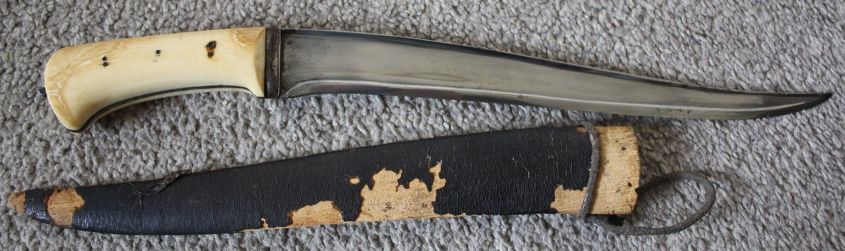

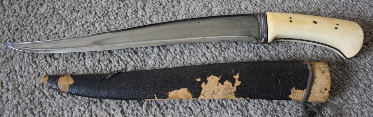

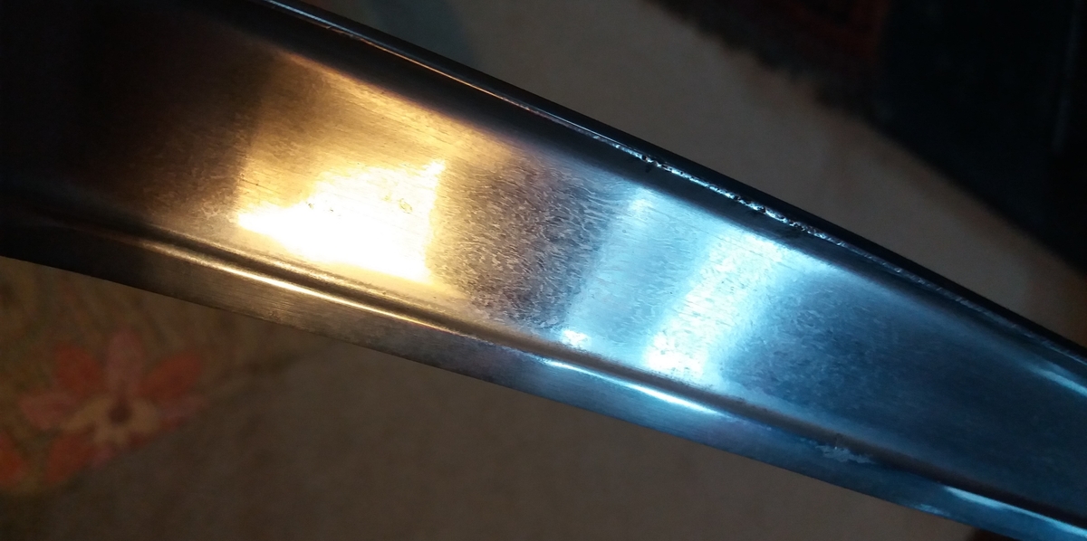

Hi all ,this is another find which I have recently picked up , Im very much a novice but thought this dagger was of good quality , I believe its of Persian origin with ivory handle and is quite long measuring in total 40 cm and blade 29 cm , im stuck on whether this is a wootz blade ive tried to take a picture the best I can, is it advisable to etch the blade ?

Nice find. It is an a Pesh Qabz and I would place it from modern day Afghanistan, most likely from the 1800s. It seems to be very nicely built. I don't think it is wootz, from the look of it in the pictures.

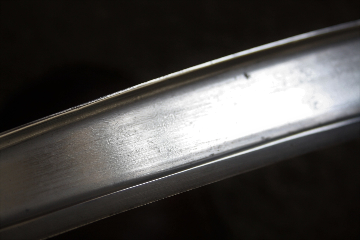

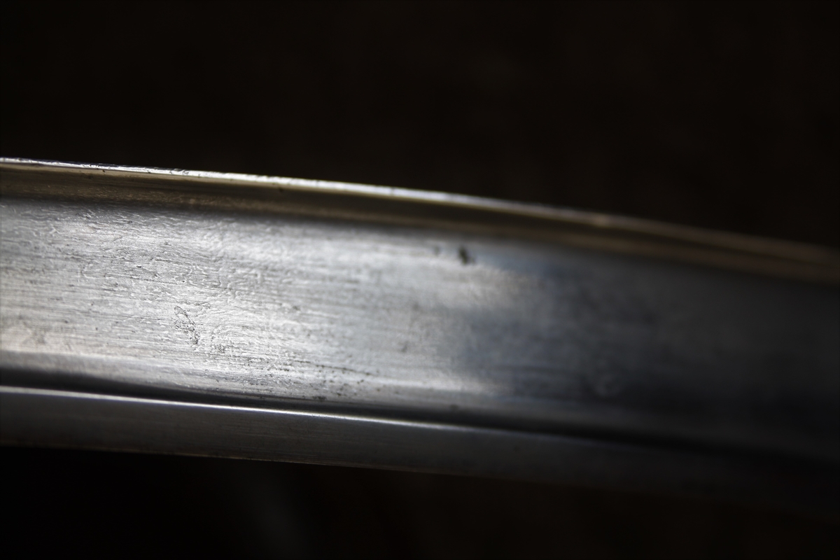

Hi thanks for your reply , I have taken a few more pictures of the blade there seems to be a pattern to the blade but hard to photo,

Try something stronger or immerse it in vinegar for much longer. I do see a little bit of pattern in the new picture though.

I have taken a couple of pics with my mobile phone which seems to show the pattern slightly better

Your Pesh-kabz is, in my opinion, north Indian from early 19th century and certainly wootz. For etching, you can find a lot of information on this forum. I documented the process step by step.

Looks like very nice crystalline wootz. I echo what the others have said regarding age. Nice to have the scabbard, too. Be sure to condition that, as well.

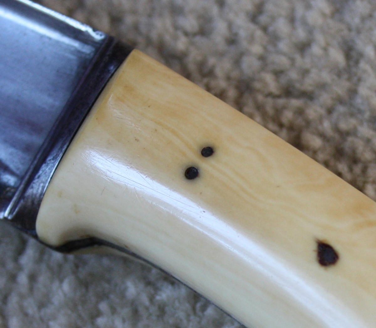

I have taken a few close up pics of the handle hope this will help decide what its made from

Yup, it's elephant.

In the photo of the tip of the pommel you can see a very fine & subtle criss-cross structure. Those are the "Schreger Lines" and are characteristic only to elephant and mammouth ivory.

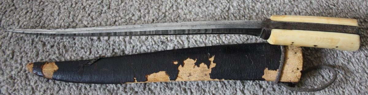

After looking at the top of the blade you can see a v design ,I take its where the blade has been joined to the steel in the handle ?

So it seems. Interesting observation.
