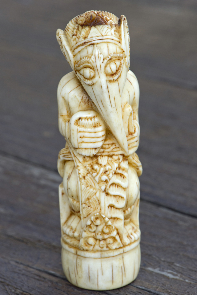

I acquired this hilt on an old Javanese keris really early in my keris collecting "career". It shows some age, but i have always assumed it was at least post WWII and possibly from sometime around the 1960-70. Iy has a nice color and patina. While no great work of figurative art i have always thought it had a certain charm (a bit like Art Naïve). I have wondered if it might be of Madurese origin, but i have never been sure. It seems like it might be Ganesha, but maybe not. You know how it is with later figurative hilts. It's intentions are not clear IMO. I did once see another hilt of the same exact design which very possibly may have come from the same carver for sale online some time ago, but i never downloaded the images and can't remember the site.
So what i'd like to know where folks think this originated? Do you think it is bone or antler? I kind of lean towards bone (note that the head has a plugged piece inserted). What type/origin of keris would this hilt be appropriate for? All comments appreciated. Thanks!

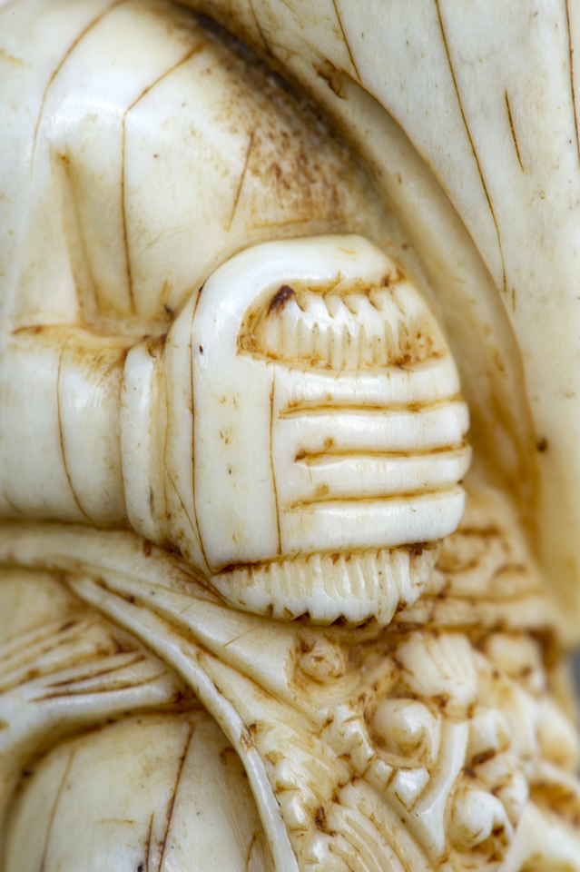

Hi David, not much to contribute but I think your call that this is Lord Ganesha is probably correct, both hands are holding something, ? the left hand a conch, no idea what is in the other hand

No, this is not Ganesha, it is most probably intended as a representation of Jentayu (Jatayu).

I always thought the long face looked more beak than trunk.
Any thoughts on origins Alan, or what, if any, dress this hilt would best serve?

I don't know Rick. I don't think anyone has actually determines what culture it originates from so i don't know how to answer your question. If indeed it represents a Hindu concept than could it have originated in one of the Balinese enclaves in Madura? If it is a Hindu representation it doesn't seem over the top to me at all.
No one has commented on the material yet. What do you think, bone or antler?

I'll guess bone David. At the bottom of the handle is a ring which I think covers the marrow area.

Looks like bone to me.
My guess is Madura, Sumenep work, and 1980's --- but if you say you got it previous to this David, well, just take it back to where you think reasonable.
It would perhaps sit best on something East Jawa/North Coast/Madura.
Yes, certainly Jentayu is Hindu, but the East Jawa/Madura carvers draw on all societies, cultures, periods for inspiration.

For me, it's interesting to see the engraved "cracks", which imitate older ivory.

Thanks Alan. No, i didn't acquire this until sometime around 2000. I had jus assumed it was from the 60s or 70s based upon the color and patina, but both those things can be faked to a certain extent, so your 80s attribution might well be correct.

nice hilt also when not antique. Another vote for bone and Jentayu. And I also think that it is from Madura.
