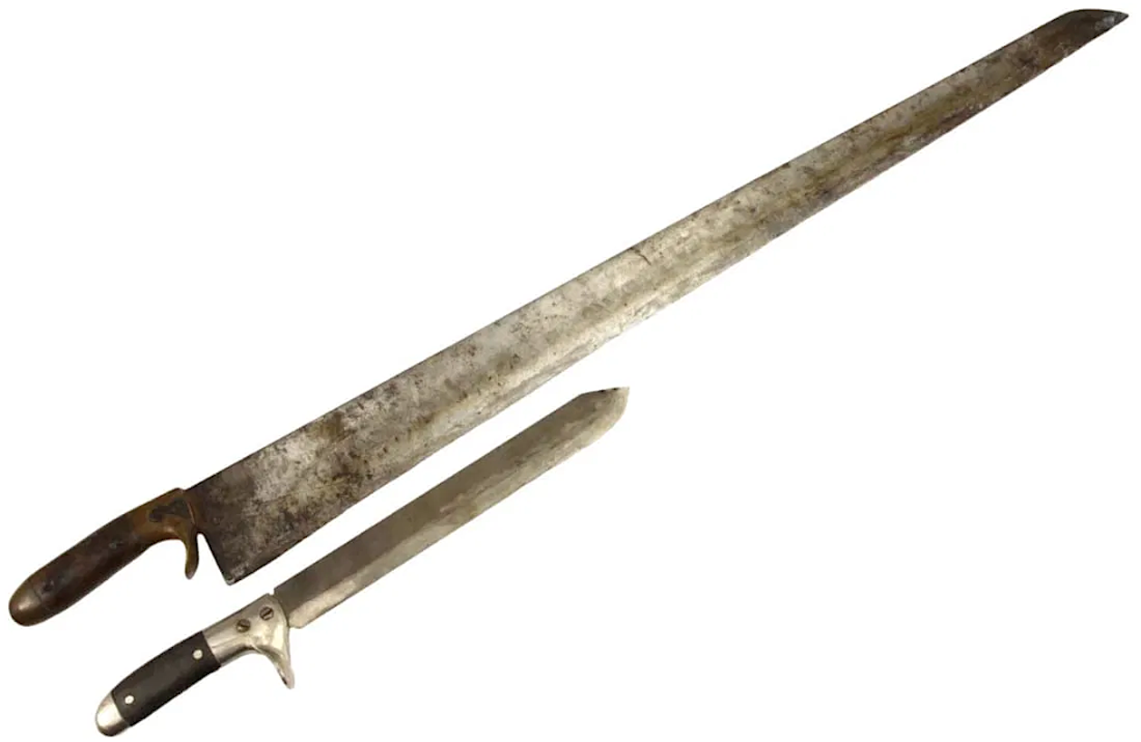

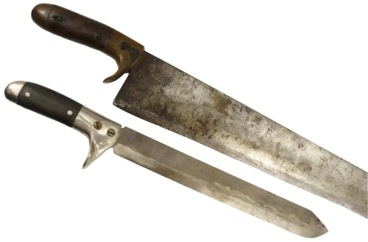

Hauswehr, utility messer with nagel, also used for fighting in an emergency (in the hof brauhaus). Nice one.
(example Found on Google)
Thank you Wayne, I think you are very correct!
