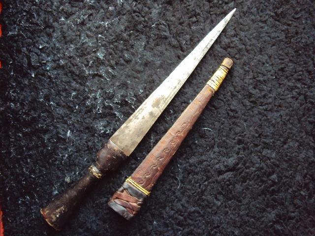

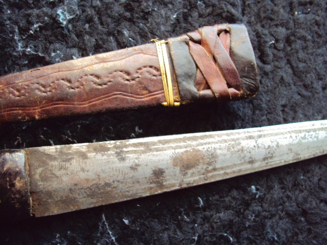

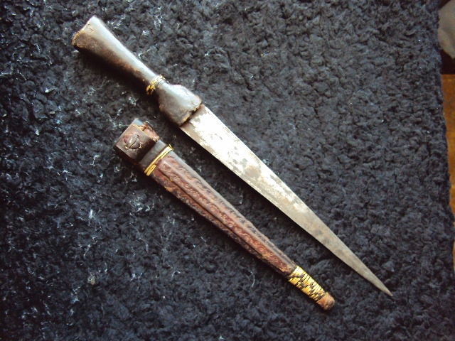

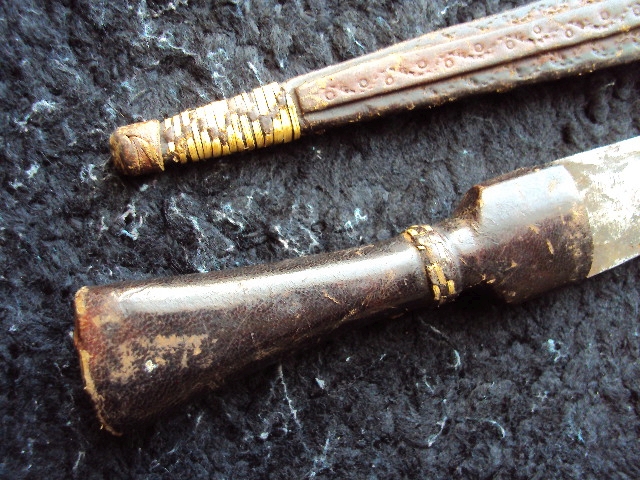

Hi friends! I got this dagger very recently and have not yet cleaned it, so my apologies for the slight rust on the blade. I'll give it the required TLC. It looks genuine and judging by the honest wear on the leather, it can't be recent. I think there's wood beneath the hilt leather. How the maker enveloped that hilt in the leather so that no overlapping is seen, beats me!
The scabbard even has a little leather cap over the tip.
The overall length of the dagger is 31 cm. I hope the pics turn out well enough for you to please help me to ID this dagger. I could get no clues from the previous owner.

Johan, while I know little of nothing about the knife itself the leather covering the hilt was most likely made from the hide covering the tail of a cow. The hide would have been peeled off in one piece and tanned then stretched over the wooden hilt leaving no seem. If there is no seem in the scabbard either it was probably made using the same material stretched over a wooden core that would be removed after it dried and the tooling had been added. Any other information on this I will leave to those who know much more about this style of knife than I do.

Looks like the sort of small knife common to Mali and Niger, particularly the leatherwork strikes me as from that area.

I'd have a go through the Pitts River Museum online collections. I don't really collect these myself, however I'm confident its from Northern Nigeria, Mali or Niger, generally speaking from a Hausa area.
See the link below for a similar example from Kano.
http://objects.prm.ox.ac.uk/pages/PRMUID78116.html

Same for me, I only collect central African knives. But I'm also confident yours is from above that region, thus North Africa. The use of leatherwork is a typical feature.
I had a look in the database of the Quai Branly Museum in Paris:
http://collections.quaibranly.fr/pod...2-38a41b633408
More similar knives are in the database when searching for "Mali", "Niger", "Hausa" etc.

As a leather worker I concur. Tails make excellent seamless scabbards and people have been using them for just that all over the world and all throughout history.
However with that comes a caution. It is more often than not (as in the vast majority of cases) that such scabbards are not tanned. Or at least not through-tanned. Which means it is effectively raw hide. So if the scabbard becomes exposed to moisture. It can rott, mold, and turn rancid... It's not pleasant.
I would suggest what ever box/drawer/display case it is kept in also have a desiccant. I might even suggest displaying it with the blade out of the scabbard and the scabbard packed with wool (a moisture wicking, insulating, and low odorous material).
