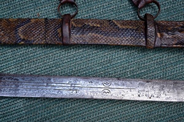

The first kaskara is a short one, which was said to have been collected in Port Sudan in 1935. It looks to have been shortened and the width reduced. The blade is 20" long and 1.25" wide; it is sharp and it has a heavy guard. It has been previously stated on this site that the shorter blades were for archers or that the blades were cut down as trophies, however, I do not think that this is the case with this sword since the handle is only 3" long. The length of the handle leads me to conclude that this is indeed a child's' or woman's sword(were there any Sudanese women or children warriors?), or a tourist piece.

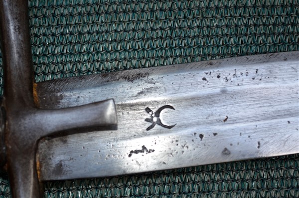

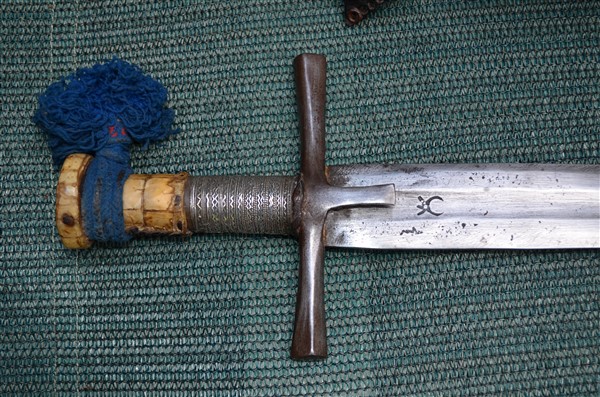

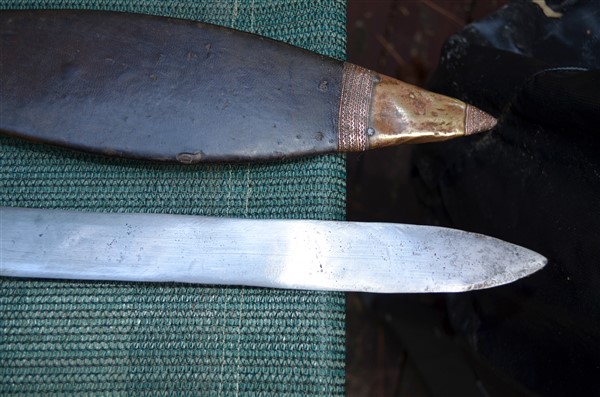

The second sword is another matter altogether. It has a huge sharp blade and it bespeaks power and authority when held. Is the maker's mark the "Kull Death Head?"Does the blue portapee have any significance such as rank, etc.?

The larger of the two appears to have an old blade which has been remounted in Kassalawi form probably more recently, but I believe the guard is old. Ed will be the better judge of that.

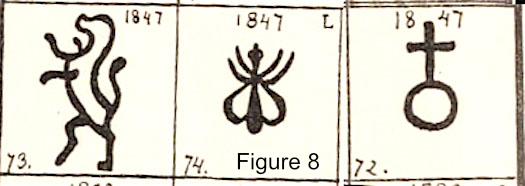

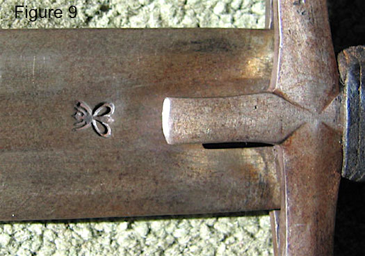

The mark appears to be the well known Sudanese interpretation of the Peter Kull marking(Bezdek p. 145) of c. 1847-60, actually a fly.
The Sudanese version of this recognizes the fly (=duran) as representing a nimble warrior, quick and agile.
These markings appear in good number on kaskara of the Ali Dinar period (c. 1910) in Darfur. Clearly the markings as on this blade are stylized compared to the original Kull marking (illustrated below)
The smaller one, I do not think these were childrens, and I believe were genuinely worn in a shoulder strap. The use of the significant lizard hide as well as the blades on these seem to be cut down from full size to be more readily worn in this manner and used in close quarter situations. These were also less cumbersome in consistent wear.

The fact that the blades often still carry markings that were talismanically significant to the warrior and totemically powerful (the hides on grip and scabbard) suggests these were used by warriors. Swords with these properties I do not think would be summarily offered to children. As far as I know, there were no women in the warrior forces.

Don't worry it's a real stuff, if you search on this forum at small tabouka and short kaskara, you will find plenty. They were just what they are: short swords.

The short sword has fuller styles common to those made in Kassaka, but poorly done. The maker's mark uses the same semi-circular inside punch used by smiths in Kassaka. It has be best the crossguard.
The long sword puzzles me. The profile lacks the taper I often attribute to locally made blades and the fuller style was common to European sources for centuries. However, the local version of the "fly" is not symmetrically stamped in the fuller suggesting local application. Also, my 1984 Kassala field notes has a similar sketch of a cow's head said to be invented in early 1950s. But the cow has small circles for eyes not seen on your sword. Bottom line, I can't really attribute a source and date.
As far as I know all Beja tassels are either unbleached or black cotton. The blue one was added recently.

In regards to the long sword, a possible indication of it possibly being a blade of European origin is the fact that the blade is unsharpened for the first 5.5" on both sides, as opposed to my other kaskaras that are sharpened the full length.
The tassel could be newer, but it was there in 1987 when the previous owner acquired it; even though I have never seen a blue one, I think that I might have seen a red one somewhere(or not)?

The 'cows head' stamp seems to have been pretty well known in the Sudan around the turn of the century, and like a good number of other markings (which Briggs also tried to determine associations for) their exact meaning is unclear. To the native perception there are a number of possibilities which we cannot adequately recognize, and must presume our own ideas of what they might have been.
I have the same marking on what has been seen as an Ali Dinar period kaskara, stamped in much the same place and character.
The stylization well known in many of these marks to me allows the possibility it 'could' be a rendering of a fly (Samuel Kull blades), but the potential for a cows head remains possible.
The tribal groups in the south did herd cattle, and there has been notable attention to cattle brands (MacMillan, 'Cattle Brands in Kordofan, 1911).
It seems that over the years we have thought that there were possibilities that Solingen may have been producing blades for the Sudanese market. It would not seem unlikely given the production of blades for Ethiopia at the time. I am not sure of the sharpening factor, but the fullering as noted by Ed has been relatively standard for centuries. The off center mark as also noted by Ed seems a strong indicator it was locally stamped. The use of punches long in use certainly played a notable part in the character of stamps as seen in the degenerated examples of 'dukari' over generations.
The blue tassel is curious, and have not seen that color, though red is well known and my example has a dark brown.
