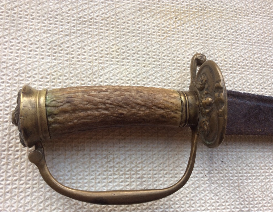

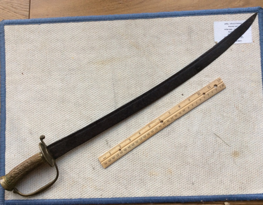

I just purchased the below hunting hanger at a local auction in rural Ireland
Blade and handle are very solid with no movement at all, feels very much an original purposeful weapon
The blade was very rusty and covered in grime but I cleaned all the active rust off and am pleased with the condition underneath
Overall blade length of 21 inches with fuller on both sides

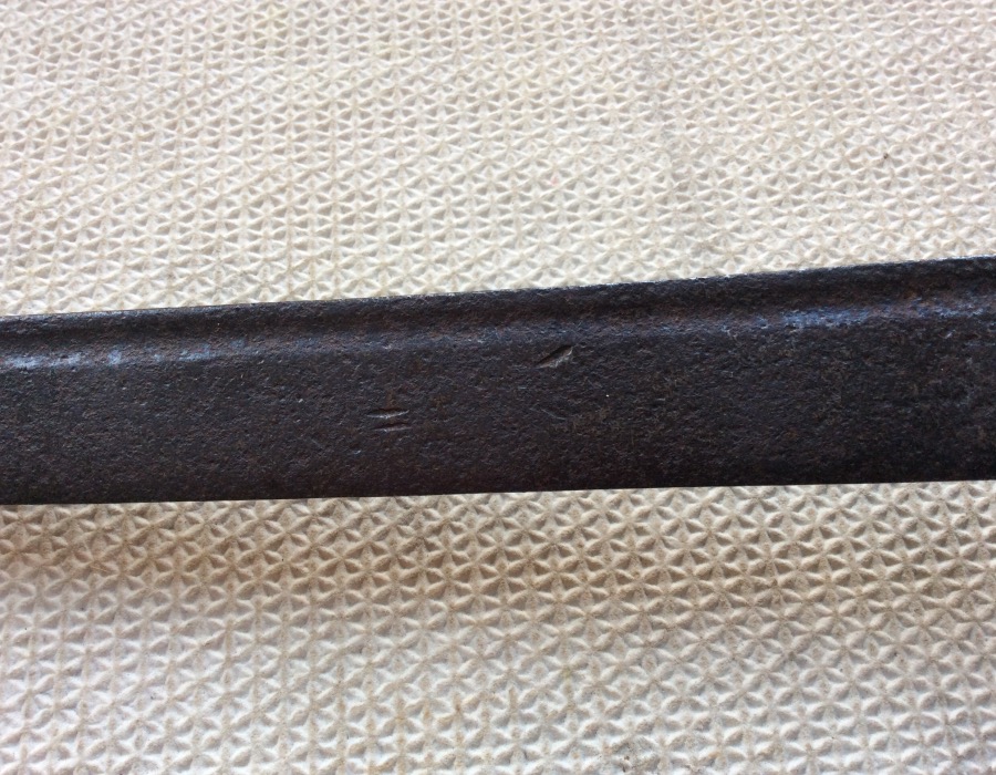

I think there is the remenants of a passau wolf mark on the blade but this may be wishful thinking, I would welcome any opinions
The handle is in very good condition and the brass is nicely toned

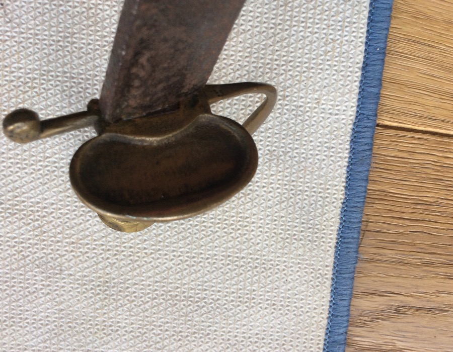

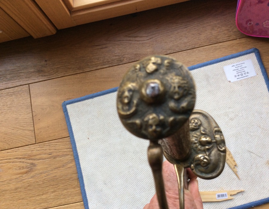

There seems to the heads of three angels or cherubs on the shell guard and a heart with wings which I take to be the sacred heart which is obviously a Christian symbol.

My big question would be could anyone give an approximate age on this hanger

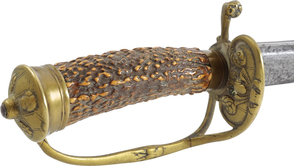

Fagan arms just sold one very much like this. Can I link to the sold sword mods?

Wow, that was impressive Machinist
Very similar indeed right down to the cherubs
Price is a lot different though from what I paid
I now have a search route to find out more, I was looking under German hunting hanger.

As per information received I have pasted in the image referred to in Machinist post.
Would anyone have a copy of either the texts referred to in Fagan Arms descriptor of items sold.
The likeness of the two hangers in very strong but I would love more information if possible.

Very nice Ken, and I am sure you got the wolf mark right. Certainly looks like it to me anyway.
Richard.

I would note that the cherub motif is well described in the fantastic book on British military swords of this period by Stuart Mowbray.

there does seem to be a wolf on the blade in the photos. i see front & real legs, tail, and a very vague head, back line & lower body line.
enlarged & sharpened:

I had forgotten about Shotley Bridge using that running wolf mark, as Jim pointed out. I remembered Harvey and the early Passau wolf mark as we've discussed it on previous threads. I actually had never seen one of these types with the running wolf, most being unmarked or the Wundes king's head.
