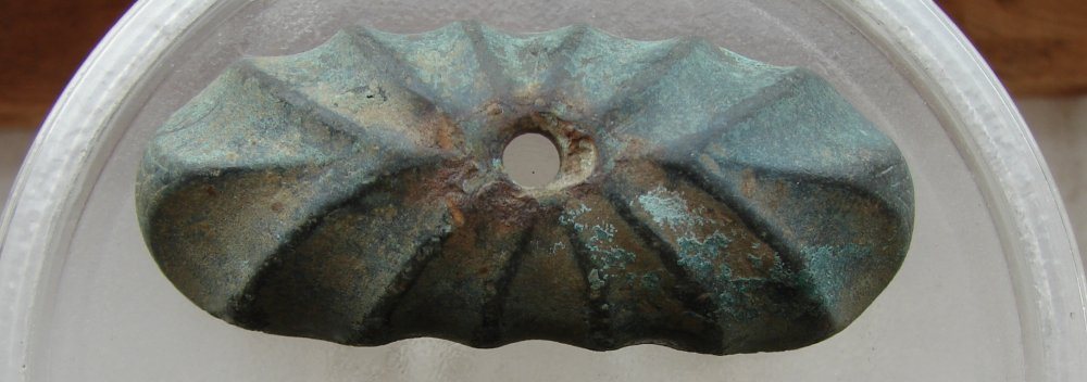

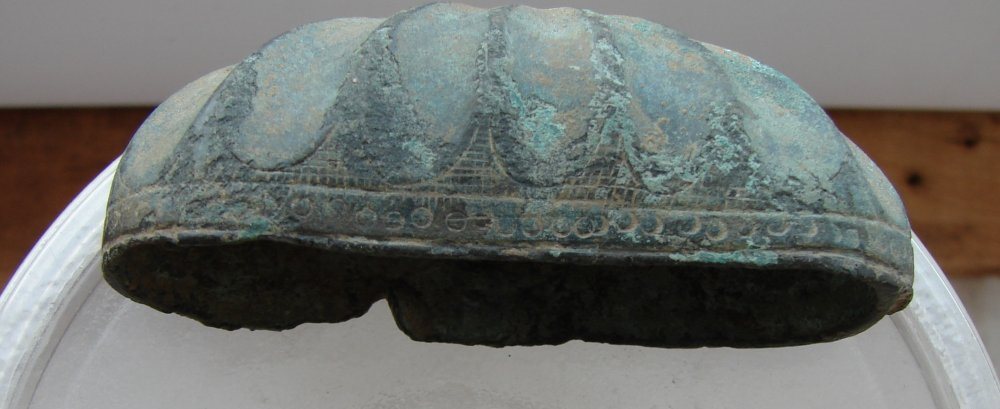

Colleagues,
Please, help to find out origins of this pommel from western part of Russia (Smolensk region). It's made of bronze.
Thank you in advance!

Old 7th September 2016, 09:32 AM   #2
Ibrahiim al Balooshi
Ibrahiim al Balooshi's Avatar
Join Date: Jul 2006
Posts: 4,408
Originally Posted by Evgeny_K
Colleagues,
It looks Viking...

Old 7th September 2016, 10:19 AM   #5
Evgeny_K
Evgeny_K's Avatar
Join Date: Mar 2011
Posts: 217
This pommel looks unusual for me:
- it has a different form,
- it's hollow
- it's made of bronze
I can't find similar pommel

Old 7th September 2016, 11:42 AM   #6
Roland_M
Roland_M's Avatar
Join Date: Aug 2014
Location: Germany
Posts: 528
- it's hollow
I think your pommel could be older, maybe from bronze age.
The pommel seems to be viking but the vikings were inspired by older designs, the Spatha or straight persian bronze swords for example.
https://en.wikipedia.org/wiki/Spatha
https://be-tarask.wikipedia.org/wiki/Спата
https://www.google.de/search?q=spath...w=1352&bih=763
Roland
Old 7th September 2016, 03:59 PM   #7
Reventlov
Join Date: Mar 2016
Posts: 146
- it's hollow
If it is from the Viking Age (which I am not certain it is), it should be compared to Petersen's type W, which are cast in bronze and hollow, and usually have some simple geometric ornaments. Here are two examples from Norway and one from Russia.
The fluting or faceting may point to a non-European or non-Medieval origin... I have only seen one example with something like this feature, and it is not related to the type W pommels.
Reventlov is offline   Reply With Quote
