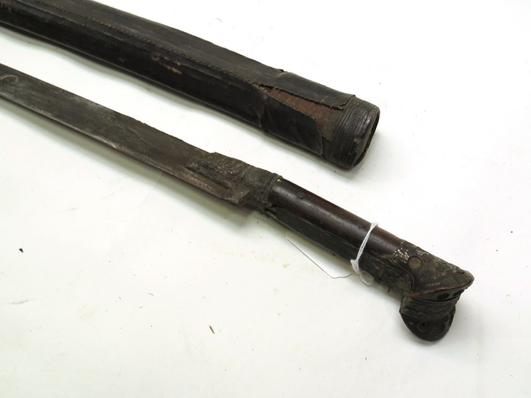

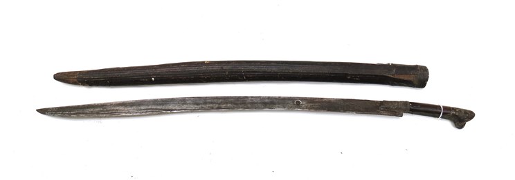

just won this at an online auction in norfolk, uk.
listed as: 19th Century North African Flyssa sword with scabbard a/f
i seriously doubt that. no dimensions, no significant bidders, i won it for less than the packing & postage. it appears to be a turkish (no integral bolster) style karakulak yataghan with silver fittings, now black. scabbard chape may be missing, leather need a bit of TLC near the throat. blade looks laminated, with a indented stamp on the left side. pommel may have some silver-work, as well as some worm holes. will know more when it arrives. i do know it's NOT a flyssa. (they sold another 'flyssa' a few lots before that looked suspiciously like a salawar yataghan (khyber knife) for not much more than i am paying)...
will list more info on arrival.

wasn't really a question - what it was has not been in doubt with me, just the auction house. consider it rhetorical. along with the khyber i was having a small dig at the level of expertise. oddly they also sold in the same auction a number of 'yataghan' bayonets that sold for more than my yat did, so they are familiar with the term.

yat finally arrived!
485 grams ex. scabbard, 27 in. blade, roughly 1.25 in. wide, 0.25 in. thick near bolster. blade has a shallow fuller both sides, turkish ribbon pattern welded, no pitting at all, some patination of the steel. tarnished black silver/(or pewter(?) decorated bolster missing a few bits, as is the strap covering the tang/scales joint, one 'ear' is cracked and loose, the ears appear to have some shallow rounded holes that may once have held gemstones or coral. the ears also have remnants of silver pebbled decoration. grip appears slightly offset to the right but feels like that is deliberate, the scales curve to fit the offset. it fits the scabbard fine & with no wobble. the scales look like they are a dark brown wood, possibly they were once all covered by the silver?
scabbard shows some stitching loss near the mouth and near the tip, where a few inches of wood are exposed, wood is a bit split but essentially intact to the tip. mouth has a decorated metal covering, mostly black now..
overall, it all needs a good clean & oiling & a bit of TLC. last photo shows it with my shorter bulgarian karakulak. all in all, i'm happy with the under £50 it cost me.
some hd pics from my galaxy phone:
