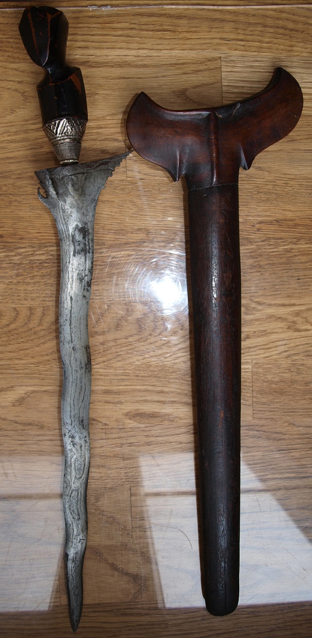

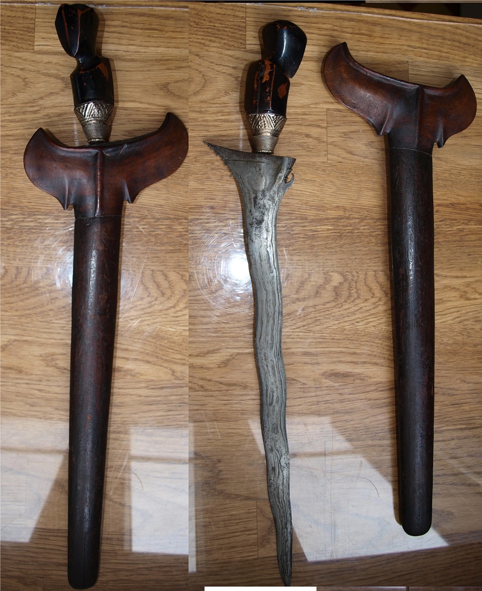

When I saw this keris I immediately liked the original form of warangka.
The blade looks old and I didn't have this type of hilt (veiled Durga?). I don't know if it's really old keris but I made an impulse buy.

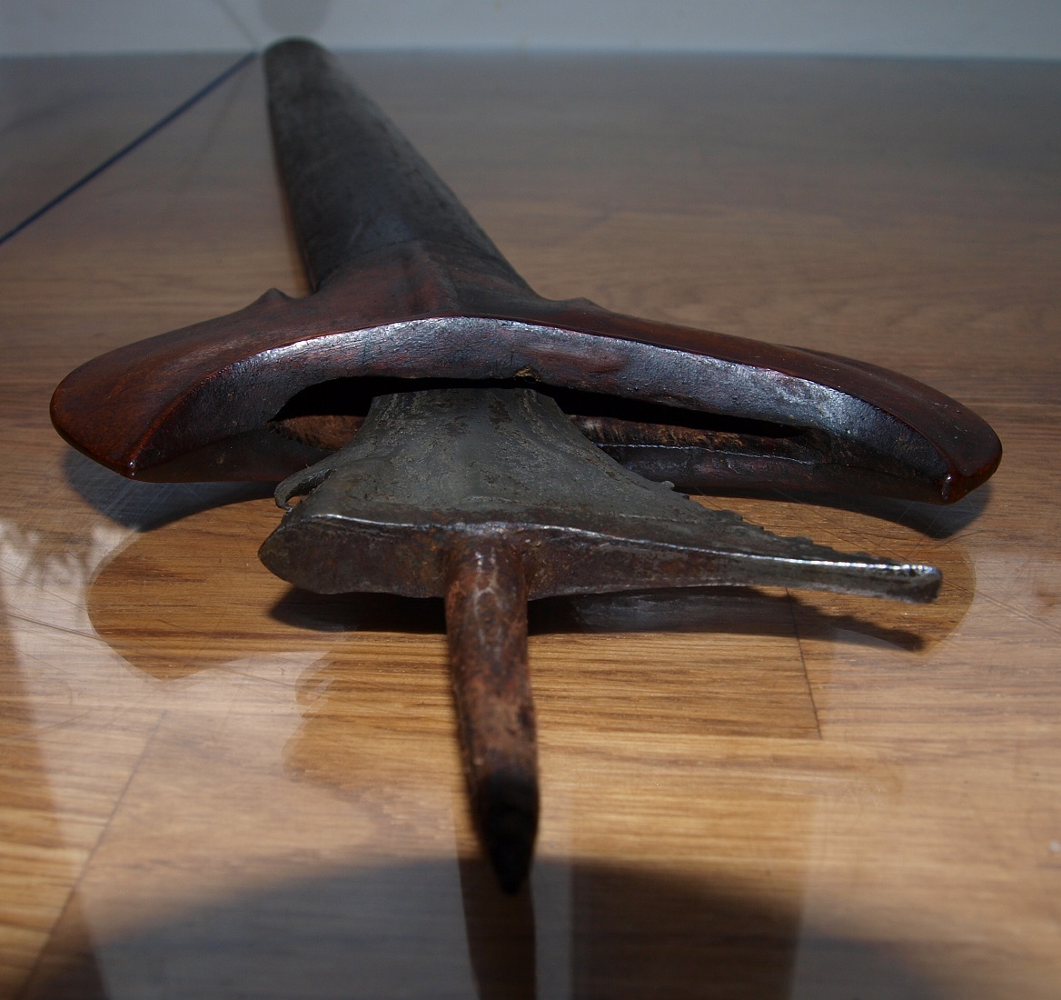

(The ganga is not separated from the blade)
I sure it's Sumatran keris. But where in Sumatra?
I found on internet that the hilt is typical of Jambi.

Cetainly a keris of some age Athanase. I do like this style of sheath. The hilt form is not what we generally consider a "veiled Durga" and i have always considered this form to depict a male character. I like this blade. It would be nice to see it in better stain.

Sheath and hilt is typical Lampung style. Also the blade looks South Sumatran.

I agree with the South Sumatra origin but possibly Bengkulu rather than Lampung. This style of hilt is locally called putri malu (shy princess) and this style of scabbard is also found in Jambi indeed.

Regarding the sheath, it is indeed one of the typical Lampung styles.

It appears, it's "locally called" Putri Malu also in Lampung ...
