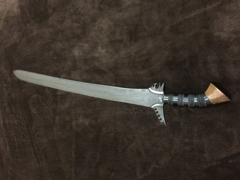

A bit of a background:
I'm a relatively young Filipino sword enthusiast. It's been less than a year since my interest was piqued. Since then, I've accumulated around a dozen or so reproduction blades, half of them Filipino and the other half mixed European/Asian.
After a rapid growth in my personal interest for Filipino swords, I stumbled upon this forum and began to read it regularly, in the hopes of learning more about these amazing weapons - art pieces, even, and perhaps a bit of my heritage as well. You see, my grandfather grew up in Sulu before clan warfare forced him to seek better pastures in Manila. WWII exploded and he faked his age and entered the guerilla army (he was 16 at that time).
His stories always stayed with me, and combined with an interest in swords from when I was a very small boy, led to my now-lifelong passion for swords, and in particular Filipino swords. I now have repros of a Barong, two Sansibars, a Talibon, a Luzon bolo, a Luzon kris, a Southern Gayang... but my heart always sought the beautiful antiques I saw here.
I went through almost all the antique shops in Manila, Pasig, and Davao, and due to this forum, finally went to Mang Ven along del Pilar st. We bonded quite a bit before I finally gave in to his crafty sales talk, and this Kris is the result. Once I had it in hand, I knew it was going to be mine, although I spent around 6 months in between work hours looking in vain for that gem-in-the-rough (and possibly found it in Davao, though the purchase was vetoed by the wife).
In any event, I'm glad to be here, and to finally post something of value. I hope to grow my collection as time flies by.

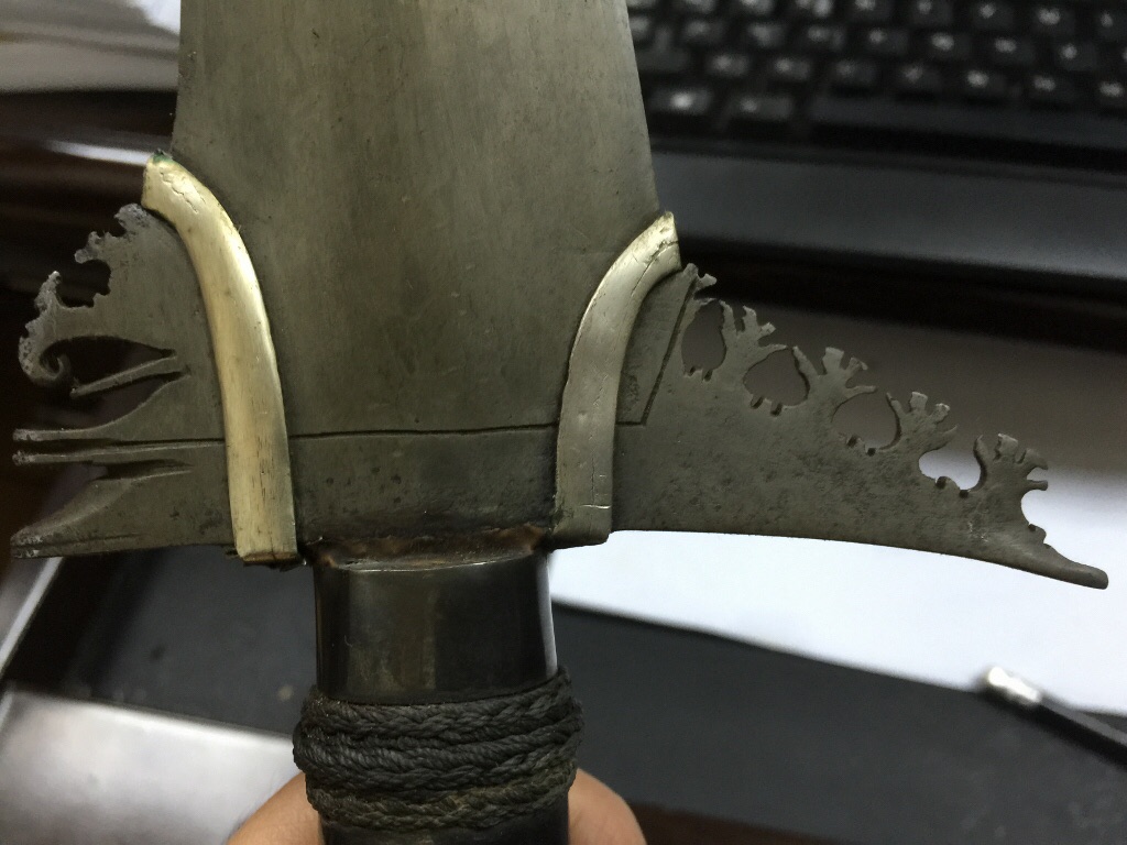

3 Questions for those more knowledgeable:

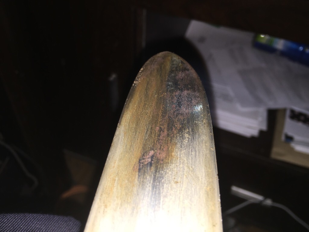

1. Do I remove the seemingly heavy rust spot near the tip of the blade? It doesn't seem to be spreading and it was the exact same size months ago when I first saw the sword. If so, what's the safest way to remove it? Steel wool?
2. In terms of maintenance, is mineral oil all that's required? How about the hilt?
3. The asang-asang has some greenish stain that I think is consistent with brass. How do I get it off? Or should I get it off?

1: You should remove the rust spot, because the rust below the black surface is normally still active. Some decades later the rust spot can cause a hole in the blade. You can see this, if you use the flash if you make pictures, the black spot will become red. My technique is a little rough, i use a tiny srewdriver to remove the rust, plus japanese rust eraser (https://www.google.de/search?q=rust+...=1745&bih=1005). Finish with steel wool.
The best way is imho electrolytical rust removing (http://www.instructables.com/id/Elec...val-aka-Magic/).
2: I know, some collectors hate me for my words, but I always use modern synthetic oil like weapon oil, Slide and Bed Ways Oil or Ballistol. Ballistol is also a good rust remover. Renaissance Wax is a good alternative if you do not like the smell of synthetic oil.
3: I suggest, to leave the asang-asang as it is.
Roland

I wouldn't argue with any of Roland's advice necessarily. I would certainly do all i could to remove the rust.

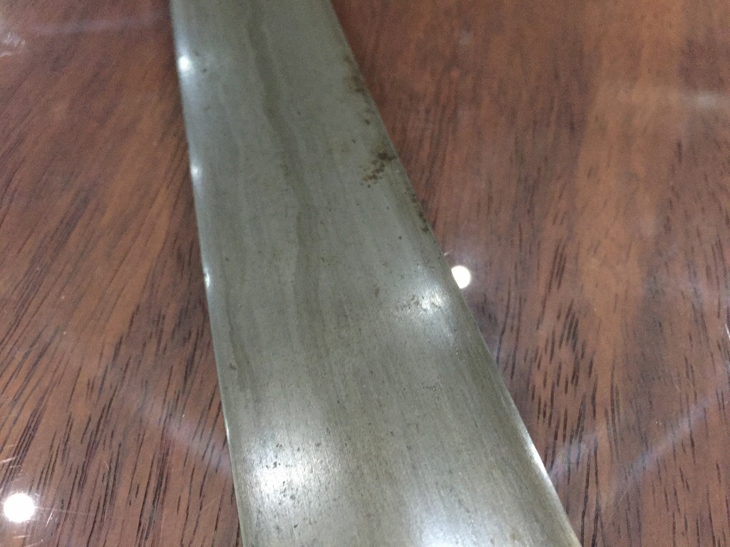

It's nice to see good lamination on what i assume is a later era kris. I would need closer examination, but your gangya does not seem to be a separate piece. A line has bee incised in the blade where that separation would have been.
The sheath is a nice example of this form. Also a later type. Looks like most if not all of the M.O.P. is intact. And i suppose the other material is tortoise shell? Nicely done.

Yes I agree that this seems to be a late era (post 50s) kris that was made in homage of its older brethren. The scabbard mouth is indeed covered by a piece of tortoise shell. The middle ridge along its length is prominent. The other side of the mouth and along it is plated aluminum. Mang Ven theorized this was scavenged off a crashed airplane. I also checked the gangya and it's not separate, since the incision trails off right at the end on one side. The blade is still wonderful - well polished, smooth, and clearly laminated. It has a single nick which might or might not mean usage, and it's quite sharp. Light doesn't reflect along the edge.
Thanks for all the advice. There's another Sulu kris which looks to be much older that I might purchase. I'm still vacillating between that kris and a barong, or even a kampilan (though I'm not the biggest fan of Maranao/Maguindanao weapons). I do have to sell most of my repros though.

the steel should have any active (reddish or crumbly) rust mechanically removed as mentioned above. inspection is best done in sunlight to see the differences in the types/colours of the rust, red rust can look black indoors. the black patination in some areas should be left alone (but oiled).
brass brushes or brass wool, dental picks, pointy screwdriver, etc to break up any of the crusty red rust. olive oil makes a dandy lube for that. when you have absolutely all that will come off mechanically, you can stop, clean with hot soapy water, rinse with hot water, dry & lube with ballistol or mineral oil.
rust can also be stabilised after removing the loose stuff with tannic acid solutions. it's a safe product that will however turn the red cancerous form of rust into a stable black form, much admired and used on gun barrels. after treatment, neutralizing, rinsing, drying, you lube generously with ballistol & you are good for a fairly long time. p.s. - tea doesn't have enough tannins, it is used in beer and wine making and is available from some pharmacys or online. it's a powder you can mix in water. wear rubber gloves or be careful, it not poisonous but may discolour YOU...

the green on the asang is verdigris, very poisonous. on a small area like that you could use an old toothbrush (throw away/destroy afterwards) and a paste of baking soda & water to scrub it off, then rinse with warm water, dry lubricate. wash your hands well before eating.
If this is verdigris (i'm not sure how you determined that from these photos) it is indeed poisonous if ingested, but as long as you aren't licking your asang-asang regularly you are probably safe.
Old 28th August 2015, 06:40 PM   #15
yes, but it looks icky & better safe than sorry. if it is verdigris, it can rub off on other stuff, eventually getting on something you do lick.

I am still not confident that the front plates of the scabbard worked from tortoise shell, to my eyes it look like water buffalo horn. And the asang-asang could be from low grade silver with copper content, this stuff get also this verdrigis (oxidation). This can be polished away with every sort of metal polish. But like said, I could be wrong.

Joren, could the security setting on your computer be set too high and thus not allowing the attachments box to appear?
I agree with Detlef that the decorative covering is made from buffalo horn and mother of pearl and not from tortoiseshell. I would also clean off any of the green that is present just to be on the safe side.
Robert

Thank you for your advice everyone. I will see to what extent I can remove the rust and vertigris.

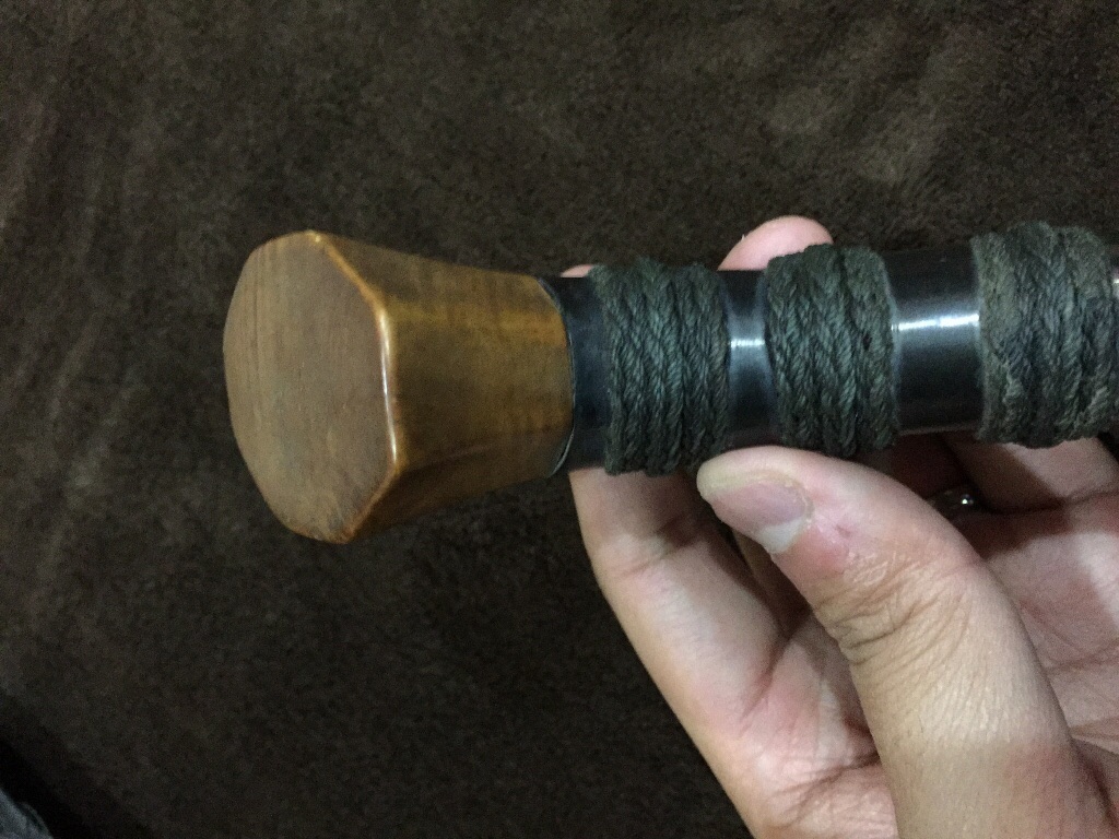

What is the hilt (not the pommel which is obviously wood) made of? It looks like horn and metal at the same time in your photos.
Old 29th August 2015, 09:21 AM   #22
Croccifixio
Croccifixio's Avatar
Join Date: Dec 2014
Posts: 33
Possibly. The bindings are a bit tight, but I should be able to take a peek and maybe even get a photo of it. My current problem is that my iphone stores the images as big files (beyond the attachment limit). I'll keep trying to take more pictures.
Croccifixio is offline   Reply With Quote

A few more photos. I really can't tell if the hilt is pure horn but it's non-magnetic.
Old 30th August 2015, 09:36 AM   #24
To my eyes it look like tarnished silver bands.

So I was able to remove most of the active rust (still have some spots to go) but I'm not sure if I got too aggressive. I used the screwdriver method but didn't use all that much force, just continuous strokes during my lunch break. Do you people think I should risk the patina and re-etch this whole blade in vinegar/lemon juice?
