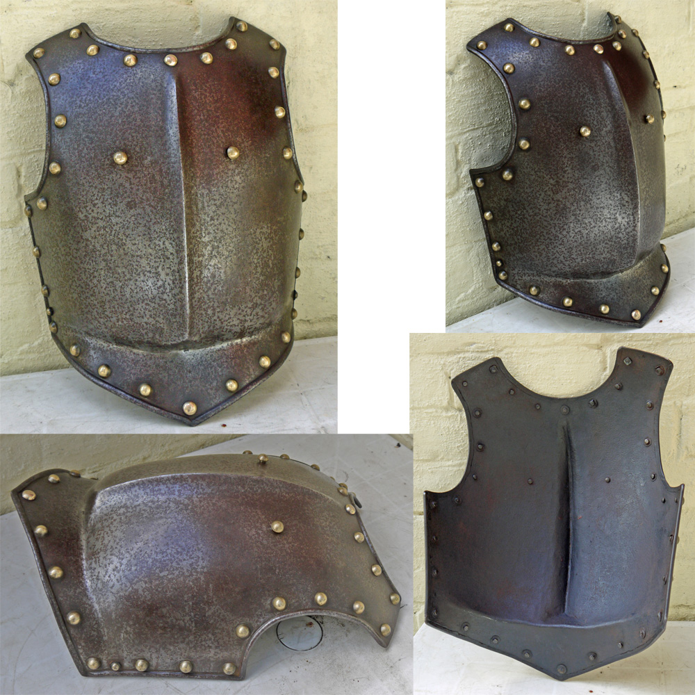

I have a substantial steel breast plate which I assumed was probably from a 19th C. British cavalry regiment. I've been looking online at similar examples, both British and Continental and am now not sure. I'd be grateful for any input from anyone who may be able help.

Hi
It looks v similar to a french one i once had
Mine had the armoury name and a date engraved on the inside just above the peascod
Ken

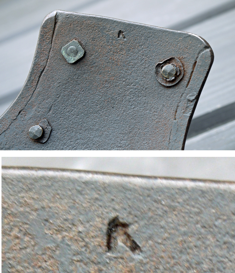

Thanks Ken, I've been all over it but it is rather patinated, the only thing I can see is an unprecise stamped letter at the inside top right.
Mel.

Originally Posted by Mel H
... the only thing I can see is an unprecise stamped letter at the inside top right...
Still it would be interesting to have a look at it .
Photo attached, First thought is a Broad arrow, but I'm not convinced that an arrow could be so badly mis-stamped , it could be a '1' or a poor 'K'

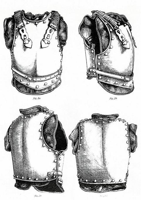

May be it is this French M 1804 cuirass? At least the number of the rivets seems to be correct!
Maybe a poor "K", yes; only sort of a control mark, not the smith's signature ... i would say.

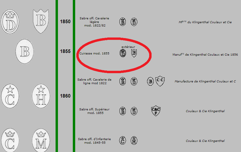

Could the poor 'K' be Klingenthal?

Originally Posted by Richard G
.... Could the poor 'K' be Klingenthal?...
Shouldn't that be a more stylized K.
... And shouldn't inspector marks be present ?
