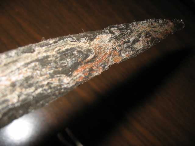

Here are some aditional immages. Simatua, a Sangkelat, I guess? What is the meaning/purpose of that bright metal insert in the Bolong?
Old 12th February 2006, 11:30 AM   #11
simatua
simatua's Avatar
Join Date: Sep 2005
Posts: 69
a sangelat indeed, it has a double djalu memet.
I Dont know exactly what the bright metal insert the bolong means.
I know that manytimes often through the many washings due to the "hormat" = honour given at the keris. The keris gets this bolong at the thinnest places first.
in my opinion there some possibilities:
1. It was there all the time , only this piece of metal (nickel) was more resistent to the arsenic then normal iron, and still stucked there
2.The owner attatched a high value at this keris. rapairing the(starting) bolong with strange iron different than the keris is "not done" , so the reapairing was done with a different metal. Sometimes you see reparations on old kerise done with gold.
3. Its inserted to give more powers at the powers already existed.
in this case i would certainly take this keris to the disco...
....i hope the kerisexperts/lovers can tell more about it
simatua is offline   Reply With Quote

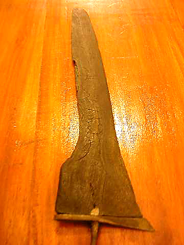

Regarding the bright metal which has been inserted to the blade, I have one example of it. Refer attached photo, the metal is near to the gonjo. Earlier, I did not realized it, but then, while cleaning the blade, the metal appeared immediately and it become much more brighter. Any opinion, wether the metal has been added later by the previous owner by purposed?
Ria is offline   Reply With Quote

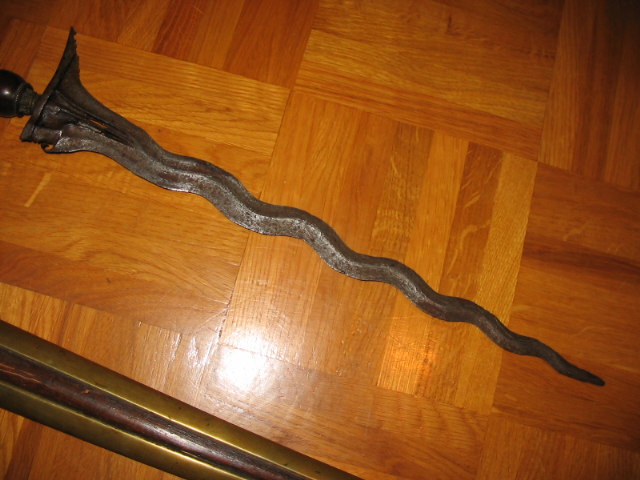

And here si my third one (and a the last one for some time, I have to study a couple of books about them first, yes I felt into )...
Balinese this time. I can say only that is vewrry beautiful, nice selut, nice mendak, great ukiran with magnificent patra, pendok damaged, wrangka from verry heavy hardwood. As usually there si questions:
- Type of keris?
- Type of pamor and what brings?
- Who's that angry guy on the ukiran?
Old 18th March 2006, 11:21 AM   #18
Alam Shah
Alam Shah's Avatar
Join Date: Jan 2005
Location: Singapore
Posts: 1,248
This is a Balinese keris with 7 Luks.
Balinese Hilt (also known as danganan) is in the form of Bima.
Probably made from ebony wood.
Sheath is in the Balinese ladrang form.
Blade needs cleaning (obviously ).
Pamor is Ngulit Semangko (watermelon skin). It is said to enhance the owner’s material well being. Interesting abstract patterns at the sorsoran area.
