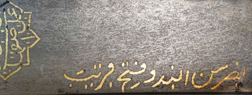

Dear members,
This is my first post on this forum. I have been collecting antique edged weapons for many years, since I was twelve, I'm now 36. Years ago I started collecting German pattern welded damascus swords, mostly 19th and early 20th century vintage, and became fascinated with the art of European 'Damascus' blades. Inevitably I tried to find out what real damascus blades were all about, and I began to study Persian sword making and wootz steel. I spent time looking at examples in museums and books, and finally, very recently, I have purchased an example of a wootz steel Persian shamshir. The grip seems to be in bad shape, with signs of old repairs, but the blade looks pretty good. The blade has two cartouches, with some other writing. I asked a friend in the Middle East if he could help me translate them, but although he is a calligrapher, he is not expert in Persian / Farsi. He thinks that one cartouche says: 'made by Zaman Esfahani'. Can anyone help me with translating what is written on this blade, and also tell me anything about its age and who Zaman was. Many thanks in advance for any advice! Kind regards Will |

It is a Quran scripture( Nasr mn Allah wa Fateh Qareeb) which means victory from Allah and an imminent conquest. In addition to the maker name Asfahani. It’s worth to mentythat this sword is Neither authentic work to Asad Allah neither the stamp is real. Unfortunately, many makers try to forge the stamp and using his name as trade mark. |
