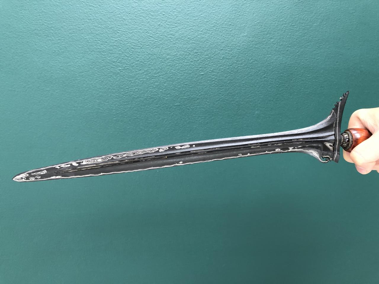

Another Kamardikan Surakarta Keris for your comments.

Hello YS,
Thanks for posting - looks like a recent piece to me.
I don't think this blade should be hold to keraton standards. One general question regarding the wengkon pamor though: Would the sogokan/kruwingan carving biting into the wengkon layer be considered a flaw for high-end keris? Or would an even exposure be the main goal aimed for?
Old 7th January 2024, 07:57 PM   #3
Posts: 7,229
Kai, Jaga did say that it is kamardikan, so yeah, it is recent, & he did not claim that it is "high end", Javanese high end starts a lot further up the dollar ladder than I think this keris might have cost Jaga.
But this keris is certainly within Surakarta parameters.

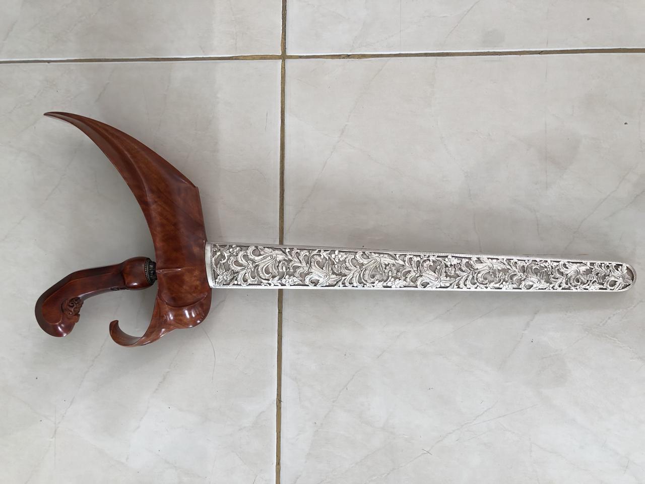

The dress is very fine, the blade has been made to a high standard.
Exposure of pamor within the sogokan is something that depends upon the method used to weld the blade, it has nothing at all to do with any evaluation of quality, however, the exposure of pamor within the body of the blade is something that would have been better avoided if possible.
The absolute ideal for pamor wengkon is that the wengkon line follows the blade edge & pamor is not exposed in the kruwingan, however, this ideal is seldom met. Back in the 1980's & 1990's it was pretty well known that only one currently working pande was consistently capable to meeting this very high level of excellence. The ideal is not even exposure of the pamor, except when that pamor is wos wutah wengkon, the ideal when the pamor is only wengkon is non exposure of the pamor in the kruwingen. Very few makers have ever been capable of this. Jayasukadgo could achieve this standard, but Jayasukadgo work is very, very distant from any kamardikan work, & in fact from the work of most other makers of any era.
All blades need to be appraised in accordance with the standards that apply to the particular classification of blade.
If we are talking Kamardikan & we are talking Surakarta Karaton, then only two makers really qualify for appraisal of their work in accordance with those Karaton standards, those two makers are Empu Suparman Supowijoyo, and Pande Keris Seni Pauzan Pusposukadgo.
Yes, since the passing of Susuhunan Pakubuwana XII a couple of other makers have been accepted as members of the Surakarta Karaton hierarchy, but it is perhaps wise not to get involved in discussion about this.

Hi Kai,
Yes I know it is recent, hence I said Kamardikan.
I might have confused you by saying Surakarta Kamardikan, but I have under no illusion that my Keris is Keraton Surakarta Keris quality, what I meant is (like Alan also said), it has Surakarta parameters.
This Keris was made by probably the last still active “anak-anak” ASKI or at least from his besalen.

Yeah, I did --- get confused I mean.
Like they say:- speed kills.

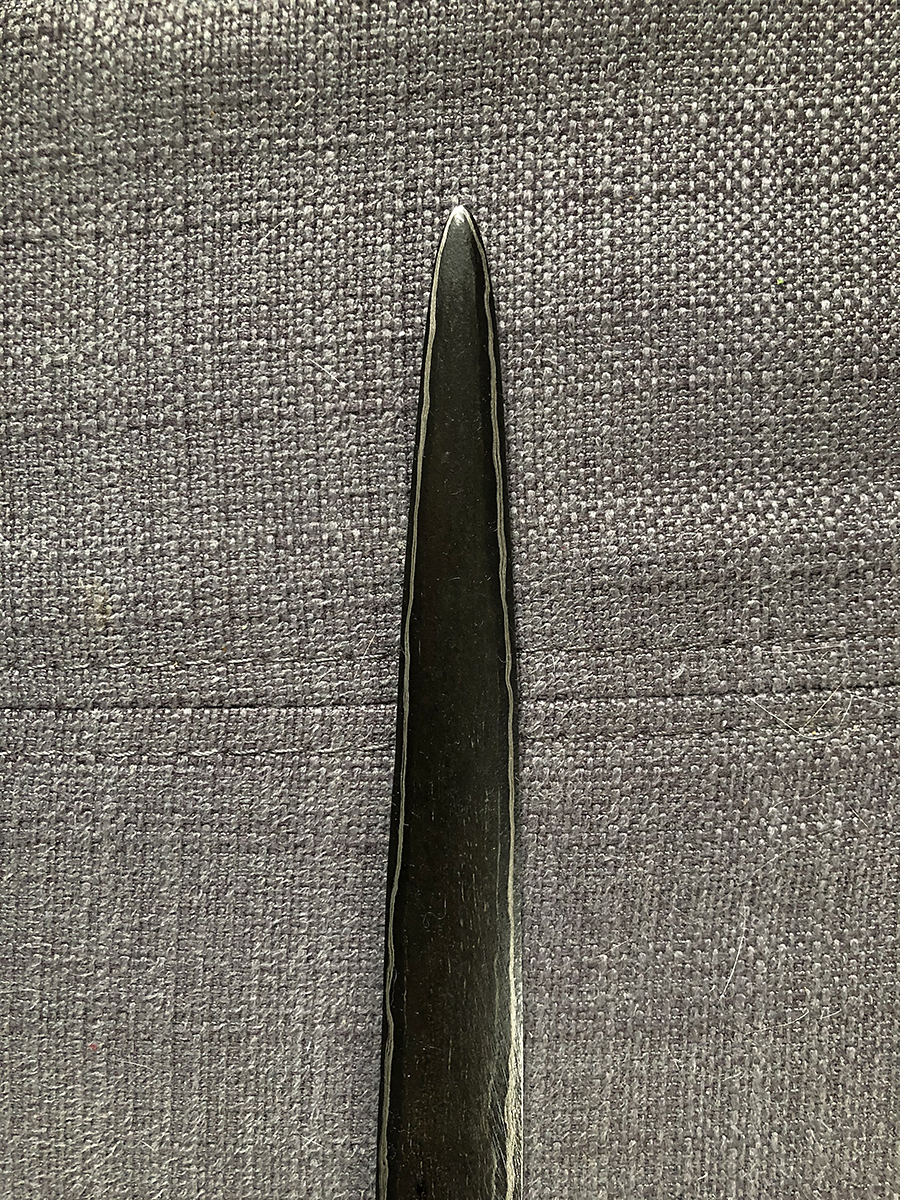

Where the only pamor visible is the line that follows the edge, this is Pamor Wengkon, most pamor wengkon blades are made without any carved characteristics, like kruwingan & etc, they are usually dhapur brojol, or at best Tilam Upih.
When a blade is made with Pamor Wengkon, & it has deep kruwingan & etc, it is a blade that has been made in a way that went out of use a long time ago, by providing a body of plain iron, then inletting a steel edge, and laying down the pamor to follow the edge & then placing plain iron over it. When a blade has been made this way, there is no side to side layer of pamor, & you can go into it as deep as you like and not find pamor. But as I said, people have not made blades like this in more than maybe 200 years, it was simply too hard.
When a blade is made with a wengkon, sometimes that wengkon will be overlaid with another pamor, which is usually Wos Wutah, but depending on the skill of the maker, other more complex pamor motifs might also be used.
Gavin, yes, that pendok is an extremely fine piece of work.

Apologies, YS, for my terse comment (I was trying to refer to later kamardikan, probably around turn of the century?) and for sidetracking things with my more general question.
Yes, the fittings are crafted in very fine quality. I suppose the pendok got crafted by pak Dayadi. Congrats, YS!
While pamor wengkon may look simple, I realise that is extremely tough to get perfect. Thus, I was trying to obtain clarification on the goal any high-level smith would be expected to strive for. Thanks, Alan, for answering my question and adding details on bladesmithing methods!

No worries Kai. I donÂ’t know who crafted the pendok, but I donÂ’t think it was crafted by Pak Dayadi. It was crafted very recently.

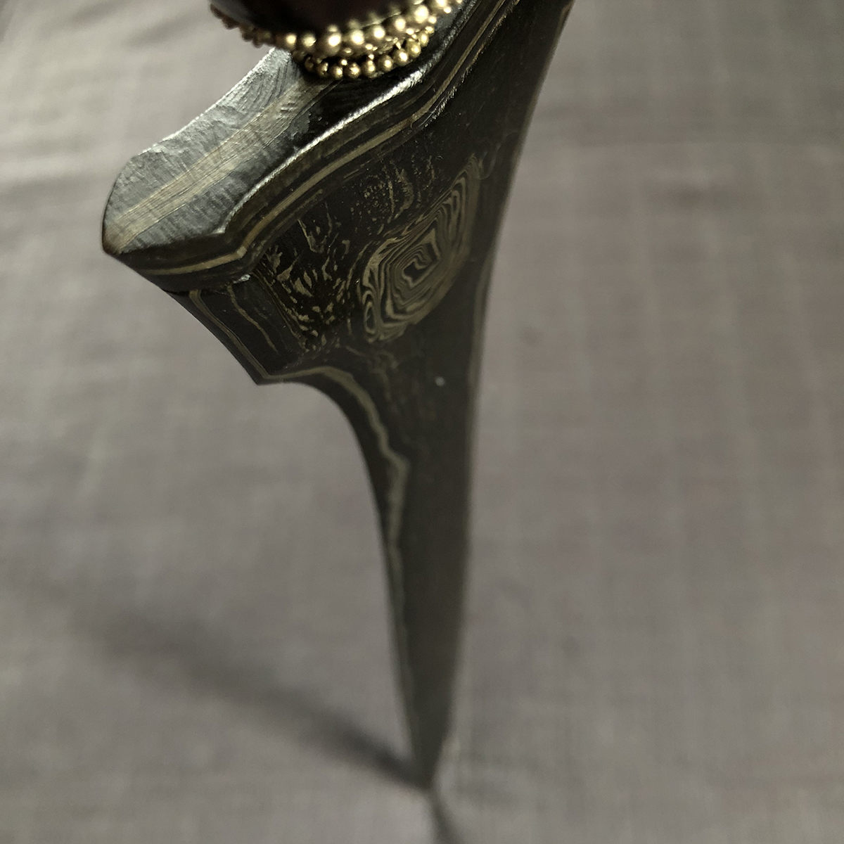

Another question regarding dhapur of this Keris (similar to Condhong Campur but missing one lambe Gajah). From the copy Dhapur 1920 book that I have, it exists dhapur Condhong Campur (A), but I could not find Condhong Campur (B). Anybody knows if it exists another variant of Condhong Campur or the (A) in my copy was a typo error?

YS, I have the same publication, on P.24 we have the straight version of Condong Campur (A), underneath that text in faint almost invisible print we have: (B)= keluk 7, hal. 54.
So we have a look at page 54, and hey presto --- a 7 luk version.
If we look at EK, the characteristics of Condong Campur vary a bit, and the 7 luk version is not mentioned.
If we look at KJ (ie, HH) we find that HH lists a CC lurus & a CC luk 7.
The simple fact of the matter is that all this stuff about what is and what is not correct terminology is only good if we quote the source that we have drawn upon. As with many things in Jawa, & I guess Indonesia in general, things are not graven in stone.

Adeg Wengkon, according to what I was told by those who were more knowledgeable than myself, is a misnomer, in fact, Adeg Wengkon should be called Tejo Kinurung, but that is only when the line of border pamor is unbroken, if it fails to meet in the point area, then it becomes adeg tiga.
Tejo Kinurung is a pamor that was/is favoured by karaton & government employees, it is not the pamor that was given to newly appointed bupatis. However, going back a few years --- maybe twenty odd --- it was a popular belief amongst some collectors that the so-called "adeg wengkon" pamor was actually given to the bupati to protect that bupati, whilst others had the idea that the adeg was representative of the populace of the province and it was the populace that the border was protecting.
The function of a wengkon understood as a border is protective, where it encloses any other pamor, then the other pamor is read as the thing being protected, where it does not enclose another pamor then it is protecting the enclosed area of the blade which is then read as the wengkuan>wewengkon>wengko, ie, the province. The function of a bupati is the governance & protection of a province or region, so it is the line of pamor that then represents the bupati.
When a wengkon encloses a line of standing (adeg) pamor, it is enclosing and protecting against disaster, curses, black magic & so on.
When PBXII was still with us keris & tombak of exceptionally high quality were given on loan to newly appointed Bupatis, these pusakas were not often returned to the kraton upon the passing of the Bupati to whom they had been loaned, they were usually retained by his family, and then found other homes.
Alan, I asked that question about Adeg Wengkon or Wengkon being given to newly appointed Bupati, because some time ago you wrote:
"In olden times the Susuhunan of Surakarta would usually give a keris with adeg wengkon to newly appointed bupatis. This was symbolic of the bupati's duty of care to the people for whom he was responsible. The wengkon was the protective power of the bupati, the line of adeg was symbolic of his people."
In the same post you explained, that Tejo Kinurung and Adeg Wengkon are two completely different Pamor:
"Adeg tiga (adeg telu, tri adeg) and tejo kinurung are all essentially the same pamor, the difference, if there is one at all, between adeg tiga and tejo kinurung is only in the spacing of the lines of pamor, but those lines of pamor are made in the same way with multi folds of pamor set between heavier layers of iron, and turned side on to produce a pamor miring motif with the three lines of pamor at 90 degrees to the core.
However, adeg wengkon is a completely different pamor to these and it is one of the most difficult pamors to make well. Adeg wengkon consists of a layer of (usually) unfolded pamor material laid against the core, and then the iron with one centrally placed strip of pamor miring laid over the core + pamor layer. Repeated both sides of blade. The result is the wengkon as mlumah, and the single adeg as miring."
http://www.vikingsword.com/vb/showpo...5&postcount=22
I also remember to have read about Keris with Pamor Adeg Wengkon being given to newly apointed Bupati in your catalogues.
Old 17th January 2024, 03:19 AM   #26
Posts: 7,229
Thank you for bringing this to my attention Gustav, I had been expecting somebody to mention this variation, & indeed, several people have already mentioned it to me, not in this forum, but in private correspondence. It is quite flattering to find people paying such close attention to my writing, whether that writing is intended for general public consumption, or for marketing purposes, or for other reasons.
There are a couple of different elements involved in giving you an adequate reply to your comments, so please bear with me.
In my post #24 I wrote this:-
"Names vary, anybody who has any understanding of keris knows that, so we use whatever suits the occasion.
But this is a discussion group, Gustav raised a valid question in discussion so I gave an answer that maybe filled the gap."
In all areas of belief, and I guess, also of knowledge, there are layers of understanding. New information given is, in my experience, only given when the questioner demonstrates an ability to understand that information. This principle definitely applies in respect of the keris, and if we consider other fields, including fields that are distinctly orientated to Western World Culture, perhaps the same principle applies.
Gustav, you raised a pointed question, one specific, clearly stated question. By doing this you demonstrated that you were perhaps ready to move to a different level of understanding.
I provided an answer to your question that would not have been suitable in the context, nor at the time when my previous comment was made. Here is the thread in which I made this comment, the thread dates from nearly 14 years ago, and what I said about these pamors was made as comment, not in response to a question, let alone a pointed question.
http://www.vikingsword.com/vb/showthread.php?t=11904
I was aware of this thread when I responded to your question in this present thread, but I gave you the response you deserved in any case.
In 2010, and for some time prior to that, the bulk of keris literate people with whom I was in contact seemed to hold the belief that adeg wengkon was the pamor given to newly appointed bupatis, and that this was a universal practice. Where there is a widespread generally held belief, & I hold a different belief, I tend to try not to create controversy by making contentious statements in passing discussion, particularly when I cannot support my statement unless I use more words than the situation calls for. When I consider something is sufficiently important to go deeper, I will do so, as I have in my response to your pointed question.
In that 2010 post my comments on the difference between pamor tejo kinurung & pamor adeg wengkon were directed at the method of manufacture, not at symbolism.
As to the use of the two terms "adeg wengkon" & "tejo kinurung", the common term in everyday usage for this pamor is adeg wengkon, however, I have heard both terms used for the same physical example by the same person, in the same conversation. I do not know why this highly respected person changed from one name to another, it is possible that the variation in usage was simply a convention of Javanese speech where use of a word could cause a less harmonious sound, but this is speculation.
While we are talking about name differences we might like to consider that some people prefer to name tejo kinurung as adeg tiga or adeg telu, then we have others who prefer sodo saler tepen for adeg wengkon.
Gustav, what I write, & also what I say, depends upon the situation, context, time & place, & sometimes the person who asks the question. I do not have only one line of thought on most things. In some fields an element of belief or of knowledge can have only one, fixed unquestionably correct interpretation. In the field of keris belief, & of keris knowledge, this idea of fixed interpretation does not, and cannot, exist.
Many years ago I asked Panembahan Harjonegoro (Alm.) why it was that you could get a different answer regarding the tangguh of a keris, from the same person if you asked that person on various occasions spaced well apart, for an opinion on the tangguh of the same keris.
His response was that Javanese people do not think logically, nor in a fixed pattern, they think emotionally and the answer given to any question will be dictated by emotion & context. Thus, when the respondent is having a good day, a particular keris might be tangguh Mataram Sultan Agungan, but if he is having a bad day the same keris could be tangguh Koripan. Maybe if he is having a really great day, that same keris might get elevated to tangguh Majapahit. Similarly, since Javanese people are fueled by emotion, they do not like to cause others to feel uncomfortable, so often an answer to a question will be what the responder believes the questioner wishes to hear.
My comments & responses vary in a similar way, probably not so much directed by emotion, but directed by context & situation.
Please accept my apologies if this rather flexible way of thinking is not to your liking.
