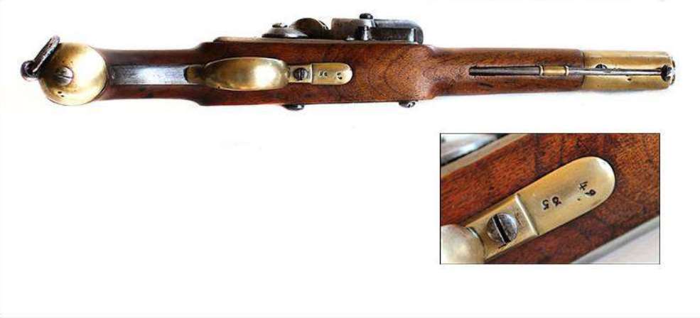

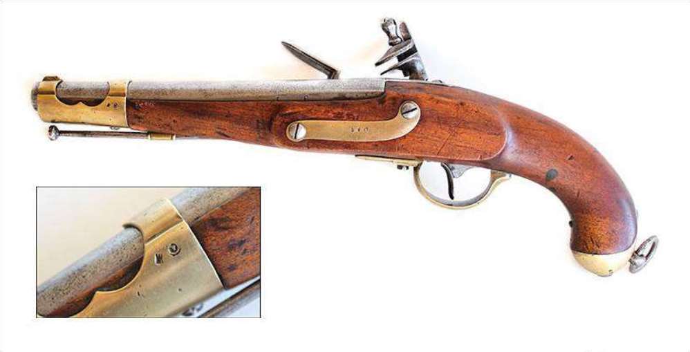

Default Austrian flintlock Pistol for id

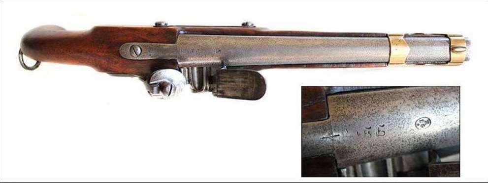

Who could tell me which model is it ,this pistol is CIRCA 43 cm ,I found a similar pistol but with percussion lock called Kavalleriepistole M-1851.
Any comment on it will be welcome.
BEST
Cerjak

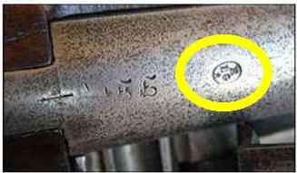

Isn't that the Poinçon de Liege, Jean-Luc ? .
... and isn't the one you found similar, the same model later converted to percussion ?

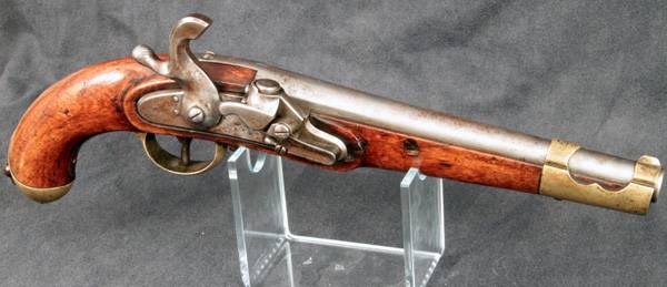

Your example would be the Austrian cavalry pistol Model 1798. This pistol type later became Model 1851 when it received the Augustin system percussion lock. Some surplus of this Austrian arms were delivered to US forces in the early days of the Civil War.
http://www.imfdb.org/wiki/Augustin_Model_1851

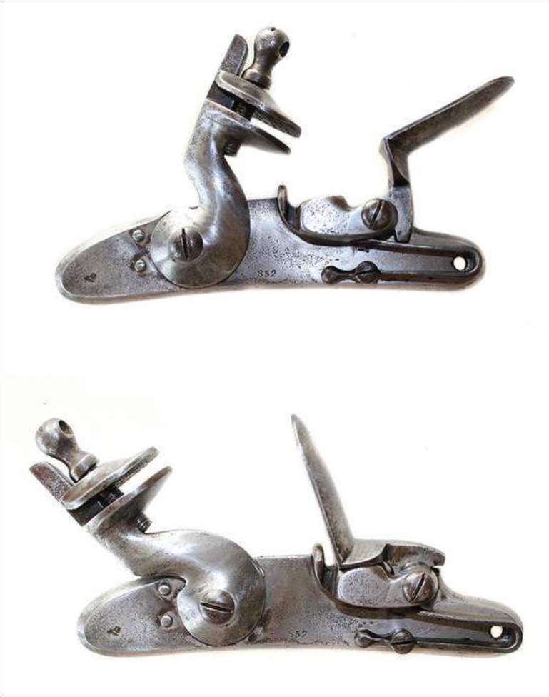

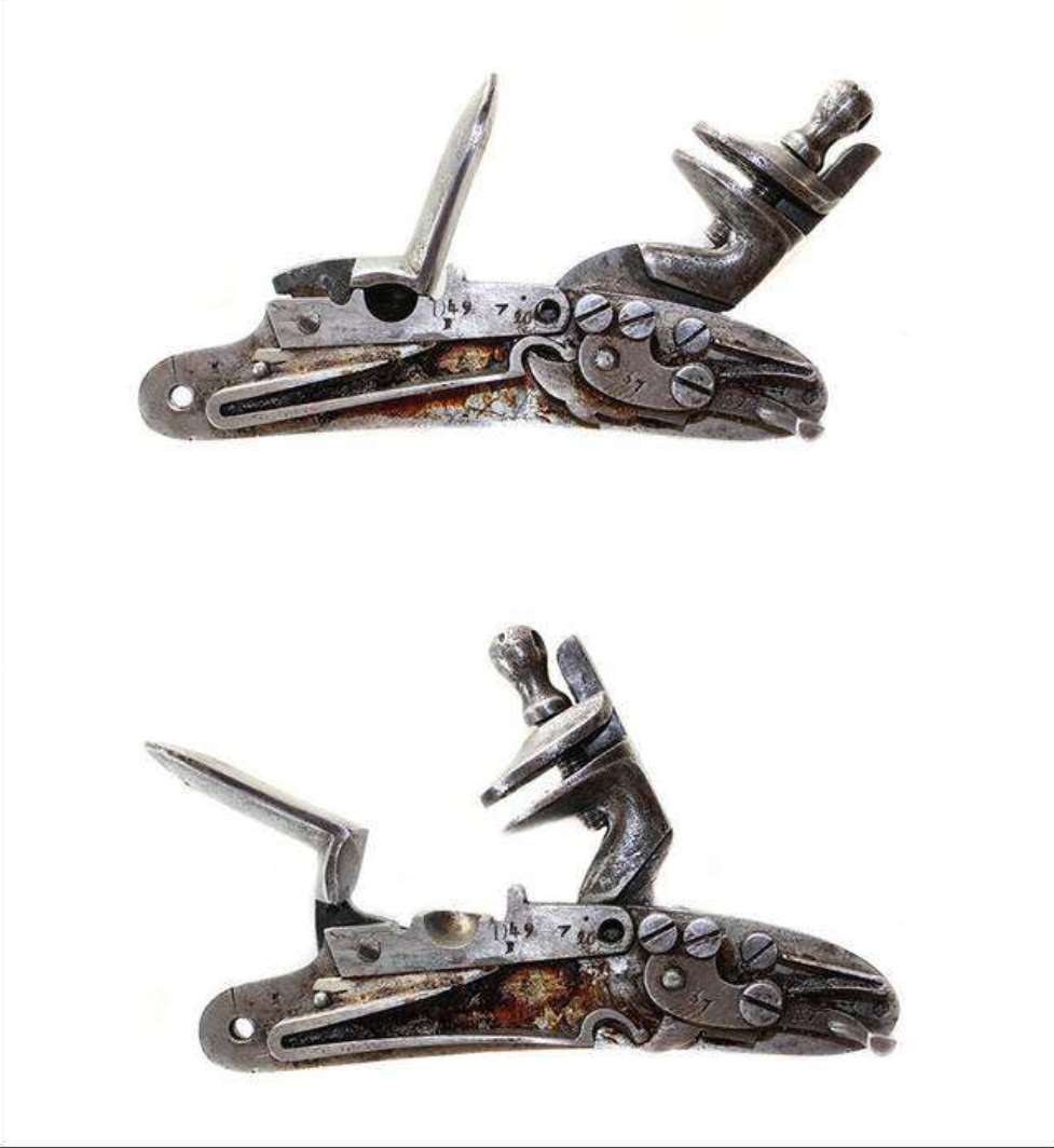

Hi Fernando
Yes the M1798 has the same type au stock but the lock is different with a brass flash pan.( see the photos) and as you can see my pistol lock is more similar in design to the percution lock M 1851 .
So I was wondering it was not a transition model after the m 1798 and before the M 1851.
Best
Jean-Luc

For me, is a Belgian copy, the punch of Liege and the number "852" which means 1852
Affectionately. Fernando K

So we have that Lean-Luc's (Cerjak) pistol bears the Liege proof mark on the barrel and the Austrian eagle and date of manufacture on the lock.
What does this bring us to ? If it was sent to Liege for reconversion, is it plausible that Austrian flint locks were sent together with the pistols ?
Or is it that Liege workshops were instructed to mark the new Liege made locks with the the Austrian eagle?

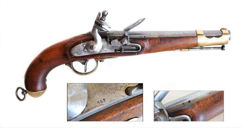

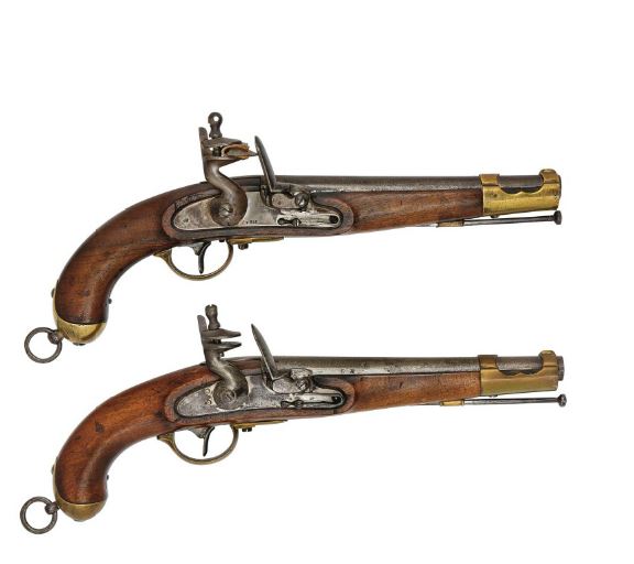

I found same pistols sold by christies
see below description and pics
A BRACE OF AUSTRIAN 16.9mm FLINTLOCK SERVICE PISTOLS
EACH MARKED '852' FOR 1852
Each with tapering barrel, iron tang, flat bevelled lock with date mark, iron pan and double-headed eagle stamp on the tail, beech full stock, iron trigger-plate, brass mounts including fore-end barrel-band also incorporating the fore-sight and pommel fitted with an iron lanyard-loop, and iron ramrod (iron parts discoloured with some light corrosion marking), numerous inspection marks and Liege proof
9 7/8in. (25.1cm.) barrels (2)

It is very, very simple: All Augustin pistols had this Vienna proofmark. After 1866 these pistols with this proofmark have been sold as percussion pistols with the Augustin system to Liège gunmakers and dealers. After the reconversion to flintlocks they had to be proofed according the Belgian laws. So they got the "ELG" mark on the barrel. Quite simple, isn't it!
corrado26
Old 16th February 2015, 04:13 PM   #12
This meaning that the (Austrian) plate of the lock remained the same; only the firing mechanisms having being replaced.
Alright then .
Old 16th February 2015, 04:39 PM   #13
corrado26
corrado26's Avatar
Join Date: Dec 2014
Posts: 1,268
Yes, that's it.
All this flintlock pistols are no original Austrian ones, they have been created in the arms facotries of Liège out of former Austrian percussion pistols M 1851 System Augustin. Their lockplates rermained always the same, only a pan and a flintlock cock had to be added, that's all.
Unfortunately lots of these "fake" pistols are sold by auctioneers and dealers as originals................. although it was very easy to check it: The years of making the pistols in Austria is stamped on the lockplate as a three Digit number as "851" or "852" for 1851 or 1852, and a serious collector of flintlock or percussion pistols should know that in 1851 the time of the flintlock in Europe was over since at least 10 years!!
